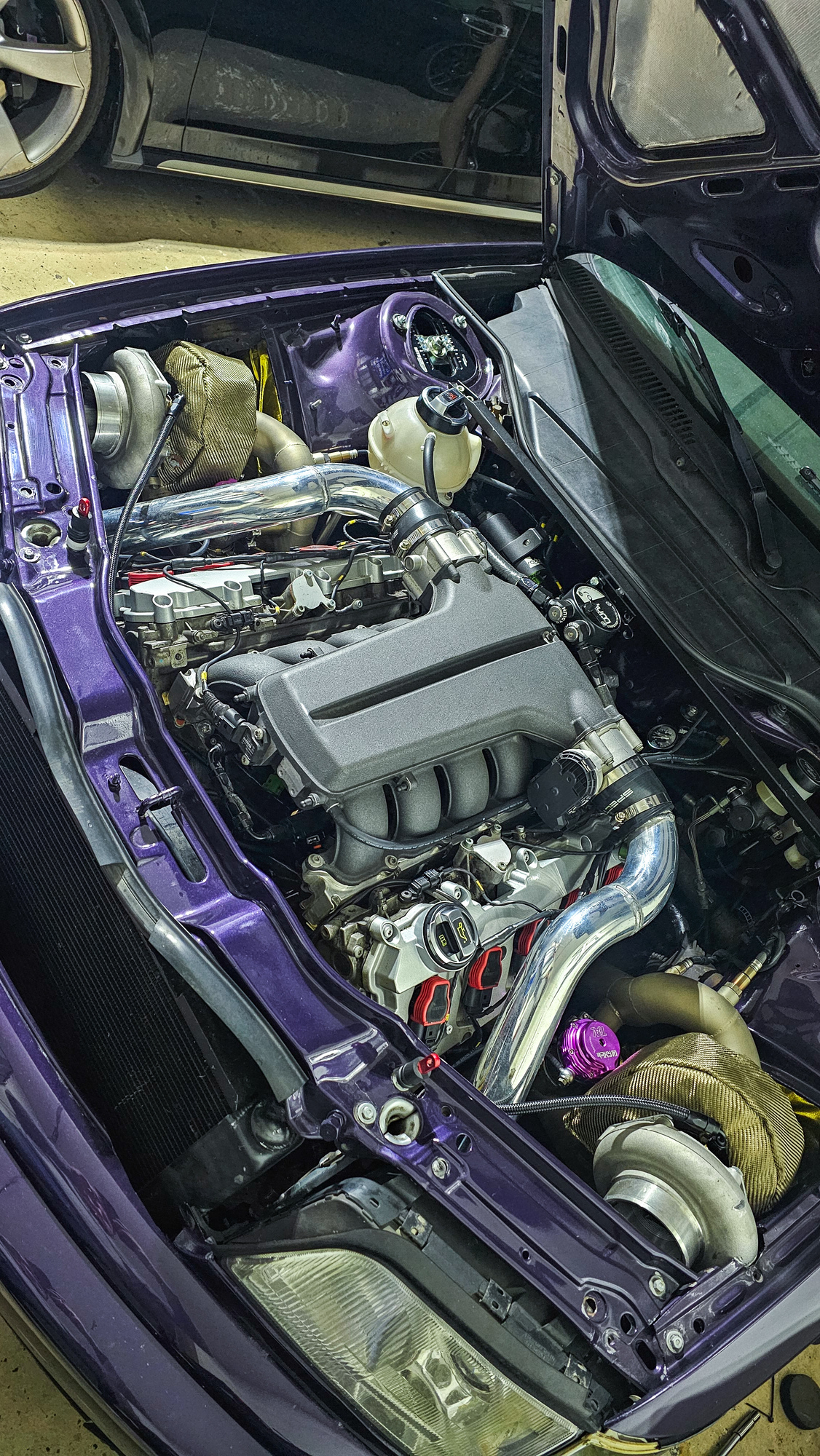

4.2 breathed fire for the first time in the Allroad today! Sounded absolutely rowdy with open headers! Now to get the 2.0t in the RS5 chassis so can move it/get the purple wagon in the garage!

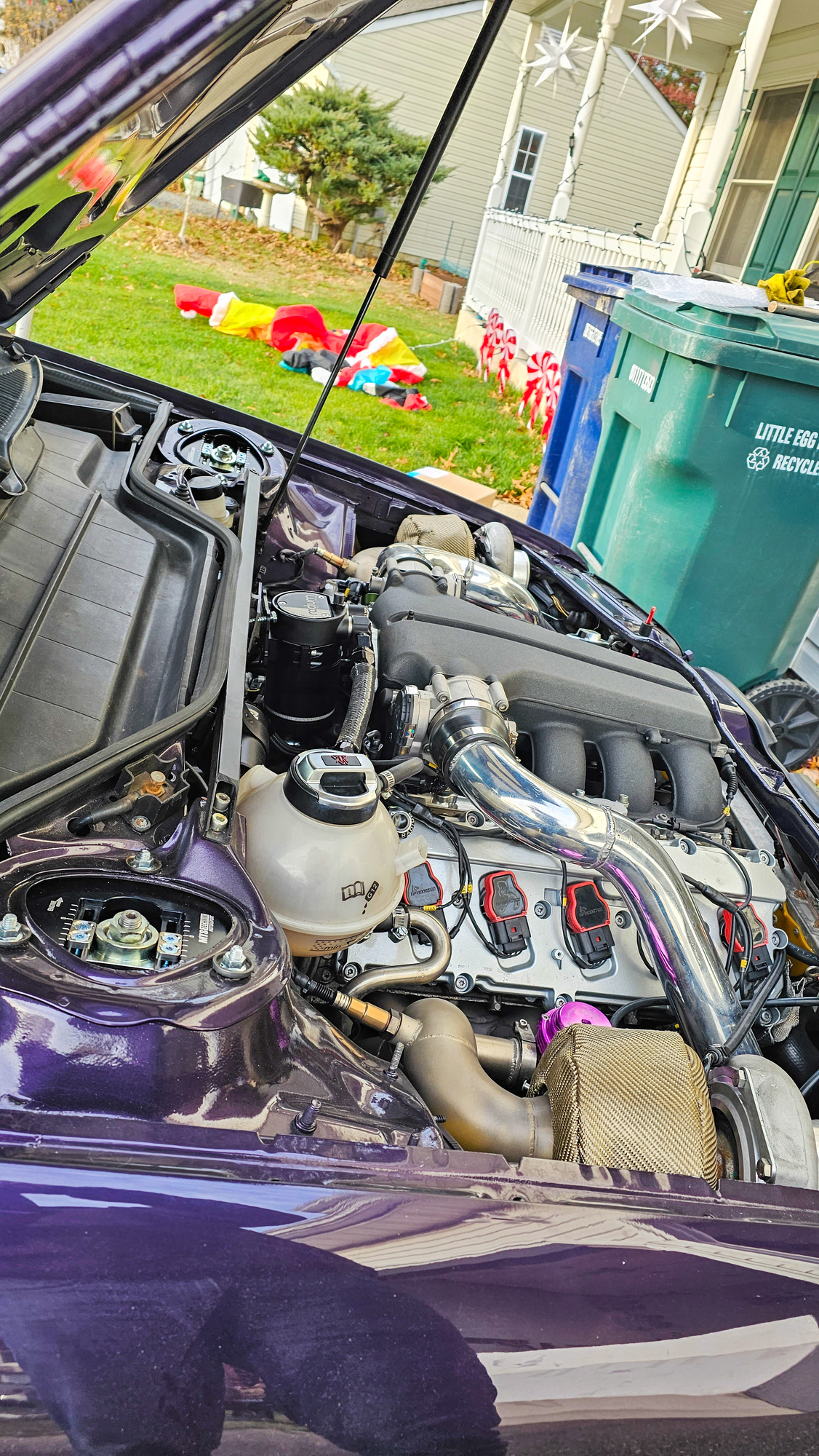

I think I’m going to downsize the turbos from a .83ar down to a .62ish
The lags not the greatest and these antisurge turbos don’t really produce the spool sounds I was after LOL
Car is holding great in the 7-8psi range.
Do I try for 10-12psi? Still waiting on the JHM supercharger kit. Hoping that’s still in the pipeline as I’d like to fab up a nasty set of 5-1 headers and see how far I could push it with the port injection.

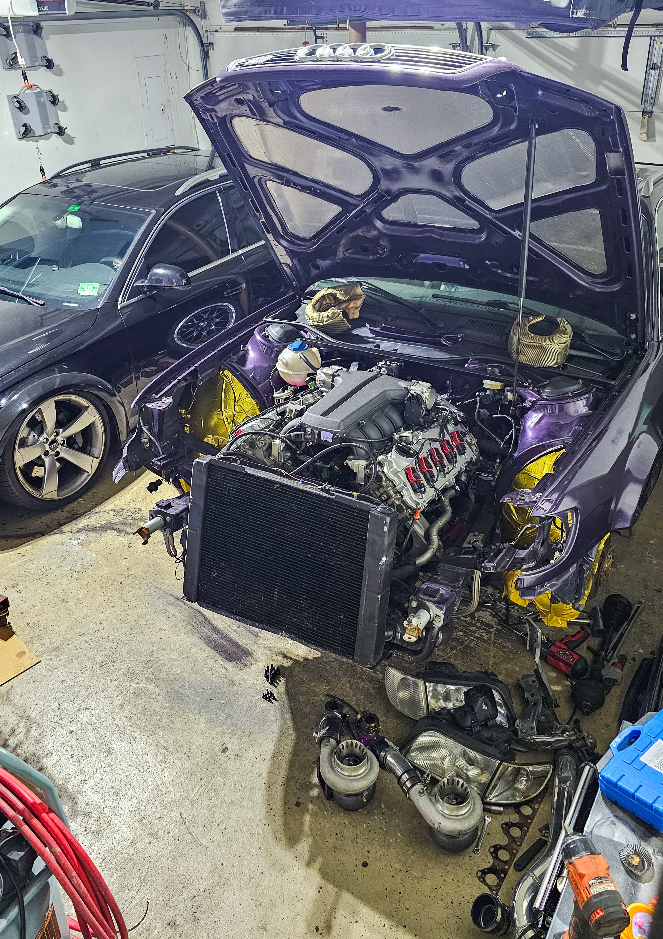

I never ended pulling the engine… instead pulling everything else! Car got a brand new Ringer Racing Stage 4+ Billet clutch, and some new seals/gaskets.

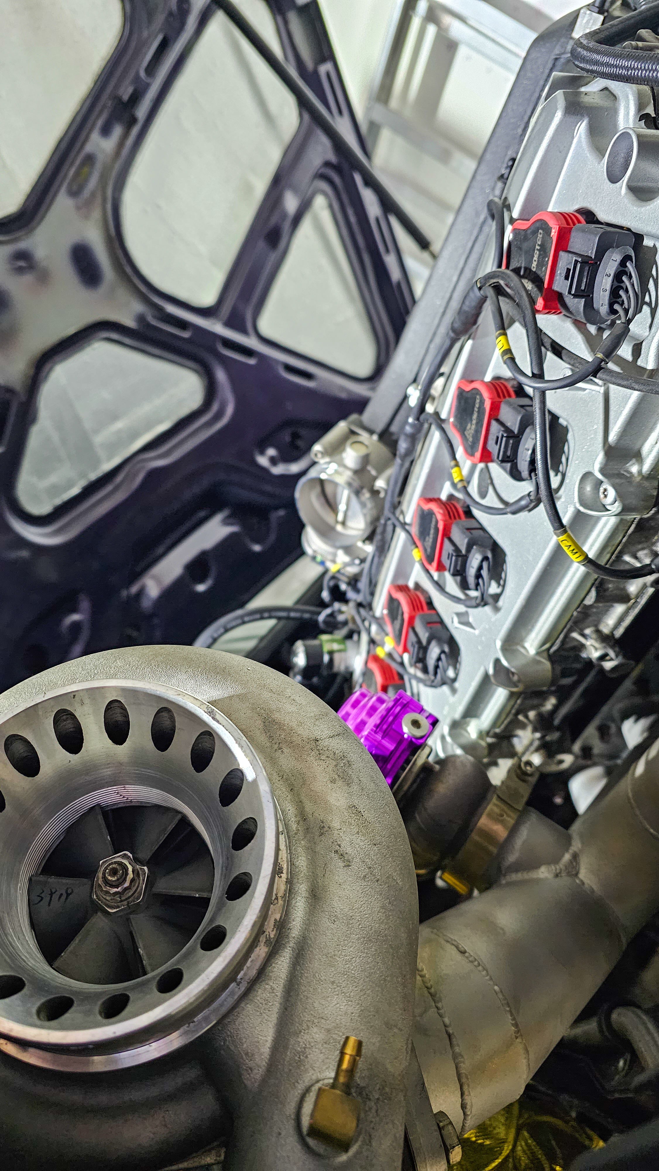

“While I was in there” I machined the turbo compressor housings for the T51R mod as well as recirculated the Tial wastegates into the downpipes.
All in all, a decent bit of work but absolutely worth it in terms of sound! The boost controller is connected so I will be upping the boost to around 10-12psi this year

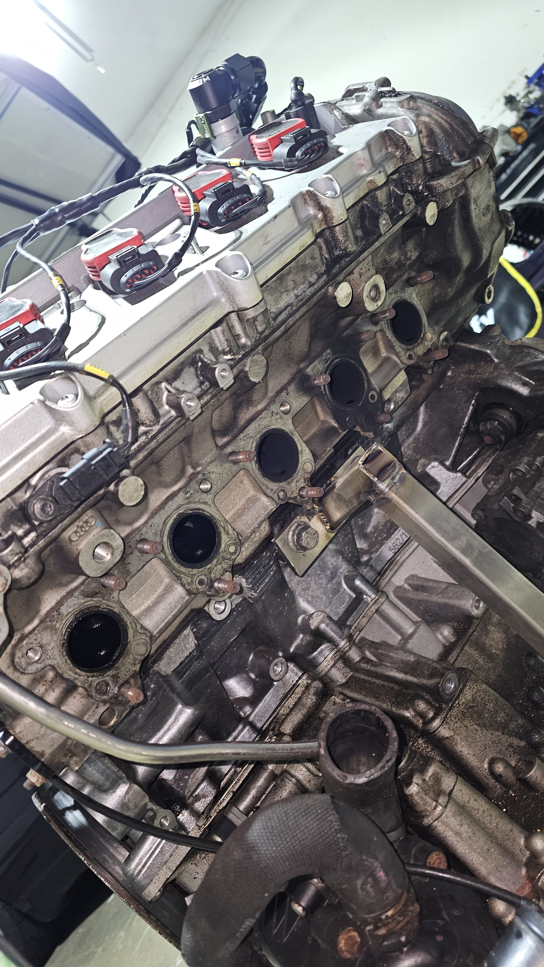

I won’t know for sure until I get the heads off, but it does appear to be a headgasket failure between cylinders 6 and 7.
10psi of boost and 12° of timing seem to have done it for this ol girl!
