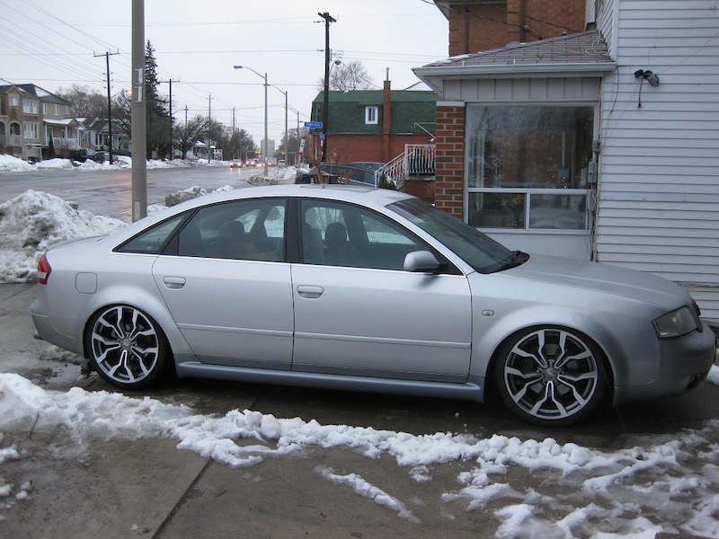

Pics of the cars, just because people always like pics
the sacrificial lamb (aka organ donor)
http://gp1.pinkbike.org/p4pb9264459/p4pb9264459.jpg
awaiting the transplant
