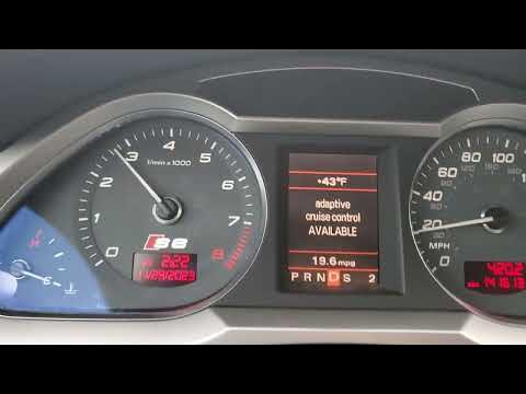

This scenario is driving me absolutely mad as it is effecting normal driving: Come to a stop but still rolling at 5MPH, car decides to stay in 3rd. I apply some normal throttle and car moves forward holding 3rd. Then decides it doesnt like 3rd, opens the TC, revs go up a few hundred. Then decides to downshift to 2nd gear… Same situation happens from 2nd to 1st gear. I have to manually keep the car in a gear so it wont hunt around when coming to a stop. Not sure if this all makes sense…
I really feel like it is a TC issue, again no codes. I just feel like the TC is taking forever to Lock/Unlock but I really dont know squat about transmissions…

Here is a video of it hunting
Just by going what I can see on the dash with the gear select. It sounds more like a Tq converter issue. The O ring tends to leak and that can cause issues similar to yours
