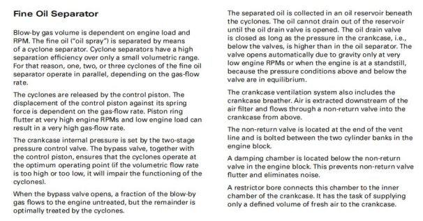

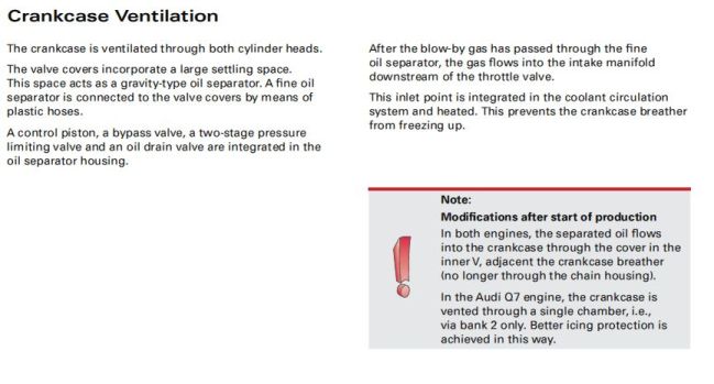

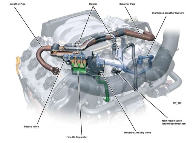

I have a new idea - cyclonic oil seperator. After refreshing myself by rereading the RS4’s self study PDF I have surmised this is a very possible culprit. Now all I need to do is figure out how to test if it is functioning properly. Any ideas guys?
I and Im sure others will agree with this being the most plausible issue. Ive seen this be the bug on a few RS4’s now. Im looking for something to help show you more on how to investigate this

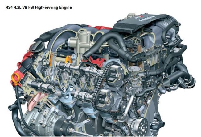

Pics for reference to follow:
More…
RS4 PCV Fine Oil Separator different view to show flow direction.JPG_thumb.png
Finally, some text describing the process/function:
This is more comon then most people think. There is a TSB on this. It requires removal and cleaning/lubracation of the unit.
It will put on a smoke show when the range of vac in the system changes
