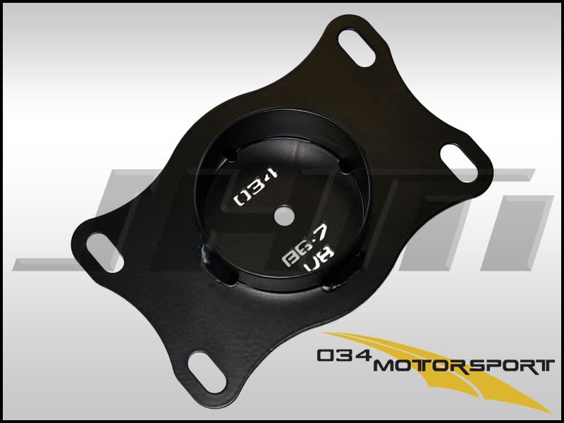

zero gap snub mount bracket
Anybody try one of these yet on a 3.0? I dont see why it wouldnt work and I think it would reduce my crazy
vibrations my car makes in park at idle even after adjusting the carrier. Im auto but I think this with
a akipol rear diff mount would be nice.
http://i878.photobucket.com/albums/ab342/AUDIDROID/034_B6B7_S4_Snub_Bracket_Zero_Gap.jpg
http://www.google.com/url?sa=t&rct=j&q=snub%20mount%20bracket%2C%20zero%20gap%20(034)%20for%20b6-b7%20s4&source=web&cd=1&sqi=2&ved=0CB4QFjAA&url=http%3A%2F%2Fjhmotorsports.com%2Fshop%2Fcatalog%2Fsnub-mount-bracket-zero-gap-034-for-b6-b7-s4-p-907.html&ei=AeK5Tq-BDYmvgwf13b3BCA&usg=AFQjCNETVOB6fHDYJVA8UDXLYpHVN0ibvg
If you are expreincing vibration at park or idle. It could be a few other things, your engine mounts are either gone or on the way out or your trans mounts are shot (does the shifter vibrate as well in this situation). The other thing is your snub may not be adjusted properly, if you have a new snub and it is adjusted right there should be zero to very minimul vibration.
It slighty idles in park, fucking vibrates my teeth in drive when im at a stop.
Audi put new trans and engine mounts on the car 35k ago, I did the snub
mount about 15k ago. Still vibrates I even took it to the local audi guy and had
him try. What’s strange is when the suspension is at stock height it vibrates less,
then when my control arms are crying murder. I think that bracket and a akipol might
do the trick and looks like there’s almost no room for error. Any one else?
You shouldn’t have vibration problems like that with those low mileage mounts. One or all of the mounts need to be readjusted is my opinion. The snub mount usually creates the most vibration if not adjusted properly. Try to loosen them all and run the car at 2500 rpms with the AC on then torque to spec. Make sure the snub is not touching any edge of the bracket.
Talking to 034 in the past, I believe they say that their snub brackets will create slightly more vibration than a stock bracket.
I would like to see someone test fitment with that bracket though.
