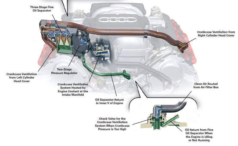

Welcome your in good hands here
From the look of the codes you should change the coil packs as you have issues on other cylinders
Without knowing what other maintenance work has been done it’s hard to know what else you might need.
A few things
The SAI system pumps air into the cylinder heads for emissions. That usually lasts about 1 to 3 min after start up. That can cause the car to run rough. But it looks like you have other issues as well
You really should replace all the other coil packs as you still have misfires on other cylinders
Check for a vac leak
Look at the fuel filter and start pouring in injector cleaner. Redline is very aggressive and will help clean injectors
Injectors can get damaged if the carbon went unchecked for too long. But the other things I mentioned need to get changed anyways so it’s good to start there

It could be an issue with the 3 stage fine oil separator as shown in this picture.
http://forum.rs246.com/download/file.php?id=31721&mode=view
There is a spring operated piston that moves with the increase in crank case pressure to bring into operation the 3 oil separators which can jam up.
This was very obvious on my car as the oil filler cap was very difficult to remove with the engine running like in this example - https://www.youtube.com/watch?v=6gXO6v49nnE
The noise you are reporting also leads me to think its the oil separator as i had the same symptoms
Thanks so much for the diagram, that’s very helpful. I don’t have the noise any longer that I was experiencing when I fist went to buy the car. I didn’t see the final bill from the dealer, but I was told by the auto seller that had it serviced, that the Audi tech said “you won’t experience that noise ever again…” - I need to inquiry about exactly what was fixed.

If you can feel a very strong suction/vacuum behind the oil cap with the engine running and there is a noise from the back of the engine then I would definitely replace your PCV valve/oil separator asap. Once you get the old one off then just pop the large black cap off the back to look at the diaphragm. The one on the S5 that I worked on was torn. That was causing the engine to suck engine oil into the intake manifolds at idle. That bad PCV valve/oil separator was causing cold start misfires and misfires under load on the S5 from the oil going into the cylinders.
