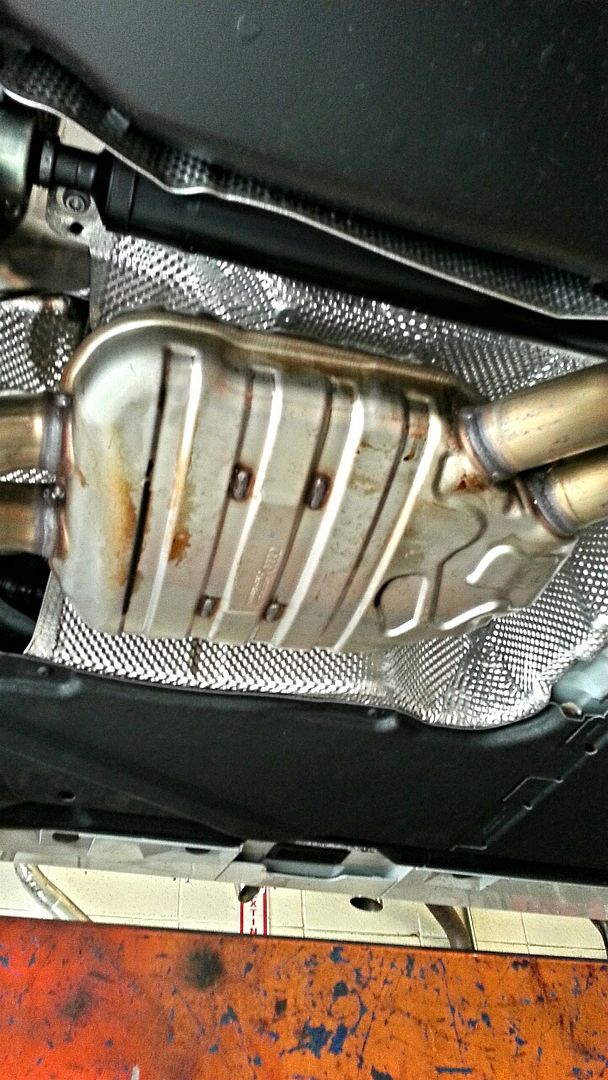

Stock exhaust:
http://farm3.staticflickr.com/2855/9166050815_702874a20a_b.jpg
I am going to basically replicate the RS exhaust package but go manual aftermarket.
