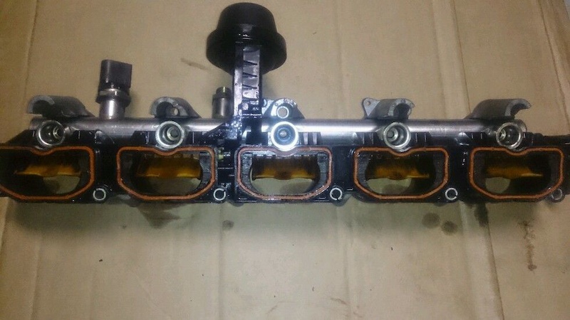

S6 intake manifold
http://ep1.pinkbike.org/p4pb11850631/p4pb11850631.jpg
http://ep1.pinkbike.org/p4pb11850632/p4pb11850632.jpg
http://ep1.pinkbike.org/p4pb11850633/p4pb11850633.jpg
http://www.jdengineering.nl/wp-content/uploads/2013/03/audi-S6-V10-engine.jpg
http://ep1.pinkbike.org/p4pb11850742/p4pb11850742.jpg

There are also the R8 and Lambo v10 manifolds, but after looking at them closely, I think it would be impossible to have them clear the stock hood.
Where the S6 intake manifold seems to be one large piece (that can be cracked open), the RS6 manifold has the upper plenum and runners, and the lower manifold pieces. The lower pieces look like they have the power flaps, or whatever you call them, that partially restrict flow at lower rpm. The lower pieces appear to be made from plastic, so I would assume will help reduce the transfer of heat to the upper manifold, something like intake spacers.
From the research I have done, it seems that the S6 5.2 and the RS6 5.0 share the same 90mm cylinder bore centre spacing and 84.5mm bore measurement. So, I will assume that the intake ports on the heads will probably line up. And from what I can see in a comparison of pics, most of the bolt locations line up too.
The heads themselves however, are different in their casting. On the RS6 heads, there is more metal material near the bottom sides of the intake port, where the S6 looks to have less material in that area. This would not normally be a huge deal, except that the RS6 lower intake manifold pieces have their gaskets built into the piece, unlike the S6 gaskets which are separate.
It appears as if the RS6 gaskets will not sit fully on the S6 heads, and the lack of metal will leave a gap at the bottom sides. Possible solutions would be adding some metal to the S6 heads to fill out the area to the bottom sides (like the RS6 heads), somehow making the S6 gasket work, or adding a transition piece something like an intake spacer (this may cause issues with the fuel rail fitment that seems to be attached to the lower intake pieces on the RS6. Maybe the stock S6 fuel rail can be maintained?)
RS6 cylinder head
http://ep1.pinkbike.org/p4pb11850634/p4pb11850634.jpg
http://ep1.pinkbike.org/p4pb11850627/p4pb11850627.jpg
S6 cylinder head
http://ep1.pinkbike.org/p4pb11850636/p4pb11850636.jpg
http://ep1.pinkbike.org/p4pb11850635/p4pb11850635.jpg
Also to note, it looks like the RS6 and S6 use the same throttle bodies, so those would hopefully bolt right up.
So, definitely not plug and play, and of no use with an NA engine. Might have value if adding forced induction, or possibly elements of the RS6 manifold could be copied for use in a custom manifold of an aftermarket forced induction kit.
