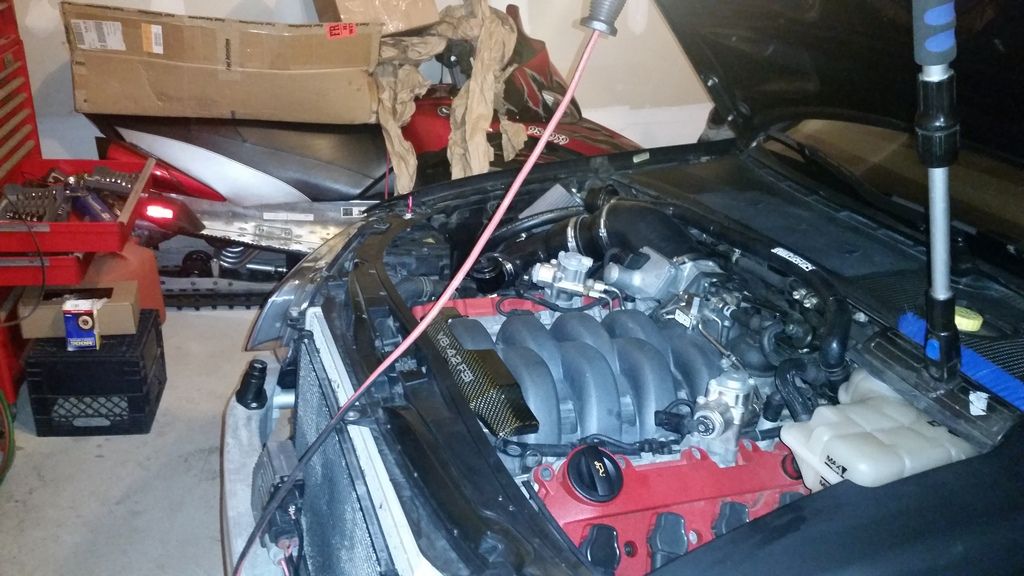

a few pics of the new maf tube and how everything looks under the hood.
http://i1270.photobucket.com/albums/jj615/Garrett_Hargreaves/20151013_201521_zpsypdrvc2z.jpg
http://i1270.photobucket.com/albums/jj615/Garrett_Hargreaves/20151013_201530_zpswfwqqicf.jpg
http://i1270.photobucket.com/albums/jj615/Garrett_Hargreaves/20151013_201544_zpsjberyhcy.jpg
http://i1270.photobucket.com/albums/jj615/Garrett_Hargreaves/20151013_203756_zpsmb0h7xju.jpg

p.s. beauty Canadian hood prop eh

ya still haven’t figured out a hood prop but my snow brush works mint lol.
