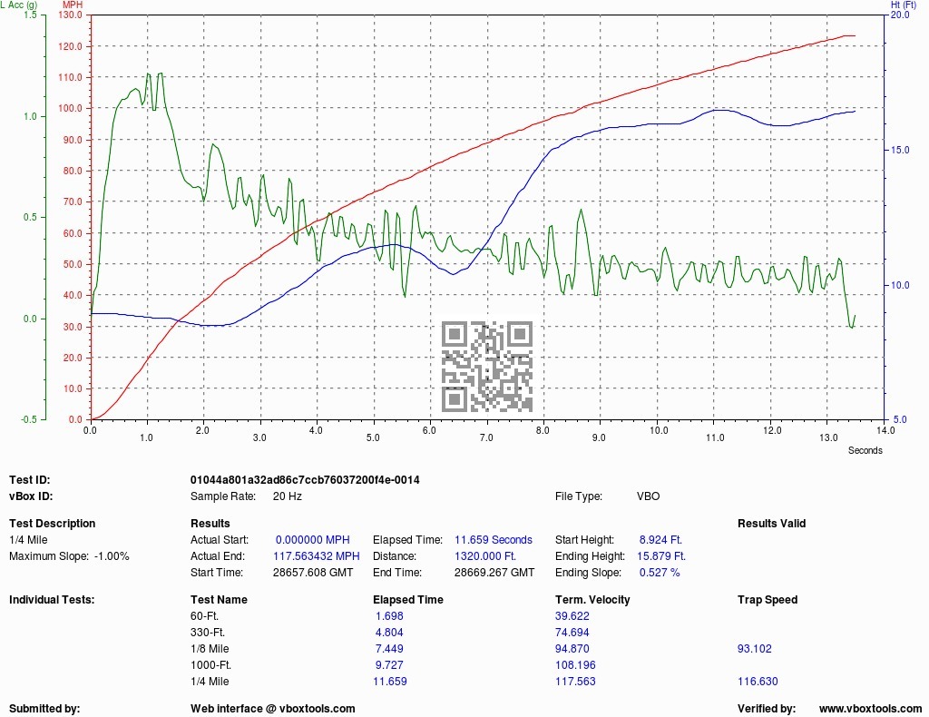

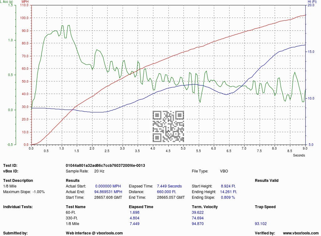

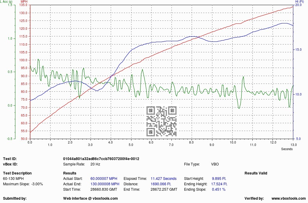

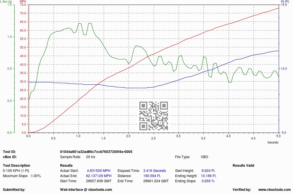

Copied and pasted from VBoxTools.com copied from my SDCard. Let me know what else you need.
http://www.vboxtools.com/vBoxFiles/ID004768-1433832227-ANON/graphs/TEST-000013-D-EIGHTMILE.jpg
http://www.vboxtools.com/vBoxFiles/ID004768-1433832227-ANON/graphs/TEST-000014-D-QTRMILE.jpg
http://www.vboxtools.com/vBoxFiles/ID004768-1433832227-ANON/graphs/TEST-000012-V-060-130MPH.jpg

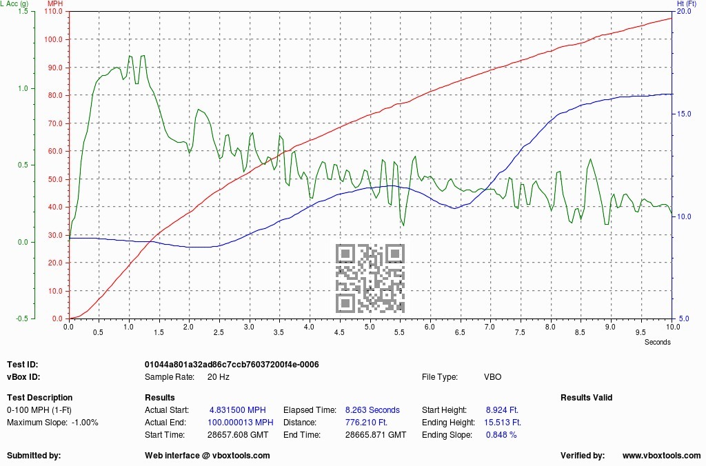

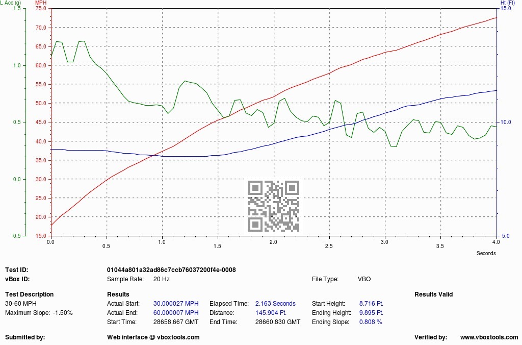

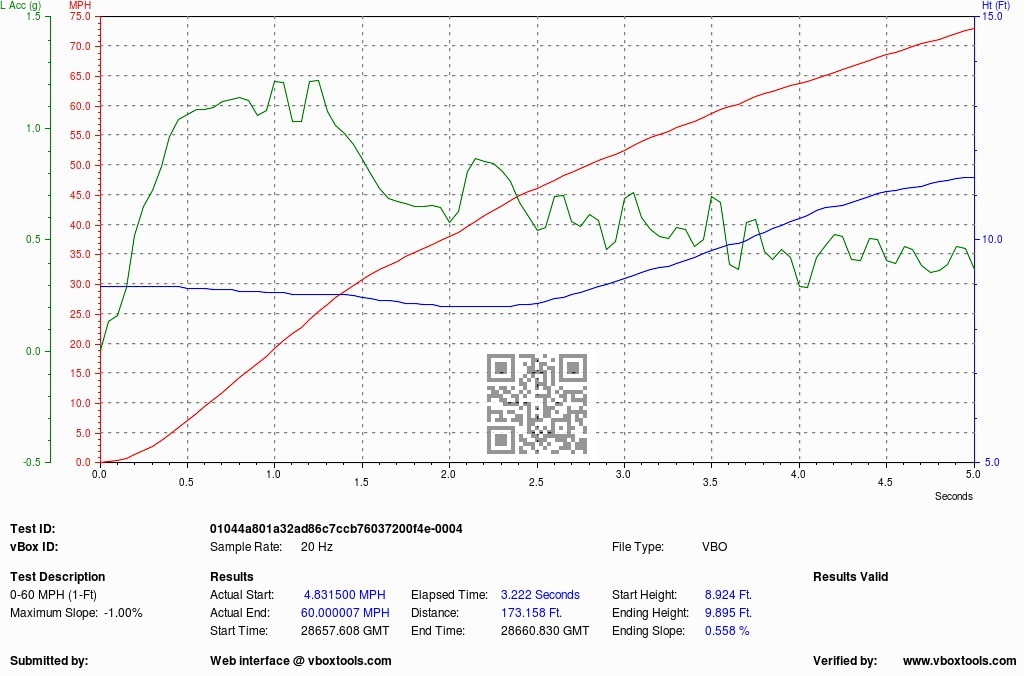

Here’s some more:

http://www.vboxtools.com/vBoxFiles/ID004768-1433832227-ANON/graphs/TEST-000004-V-000-060MPH-1FT.jpg
http://www.vboxtools.com/vBoxFiles/ID004768-1433832227-ANON/graphs/TEST-000005-V-000-100KPH-1FT.jpg
http://www.vboxtools.com/vBoxFiles/ID004768-1433832227-ANON/graphs/TEST-000006-V-000-100MPH-1FT.jpg
http://www.vboxtools.com/vBoxFiles/ID004768-1433832227-ANON/graphs/TEST-000008-V-030-060MPH.jpg

The ET looks a little optimistic based on that trap speed of 116.63.
The fast pump cars are running 11.9-12.0 on pump I believe. And that’s with some LW hardware.
To be 0.2-0.3s faster on a flash revision?? I dunno. Wait until fall and get some good runs in with cold weather. It’s getting too hot out to make any noise anyways.
Thanks Tsivas, I kind of thought so thats why it’s even on here. Wanted the results analyzed by some of you guys. Although, it would have been pretty crazy getting that time on pump, lol. I was looking at shooting over to jersey tomorrow but it’ll be in the 80’s, not good. I will try in the fall and see how it turns out, my sentiments exactly.
