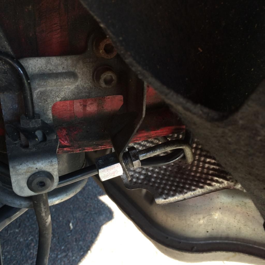

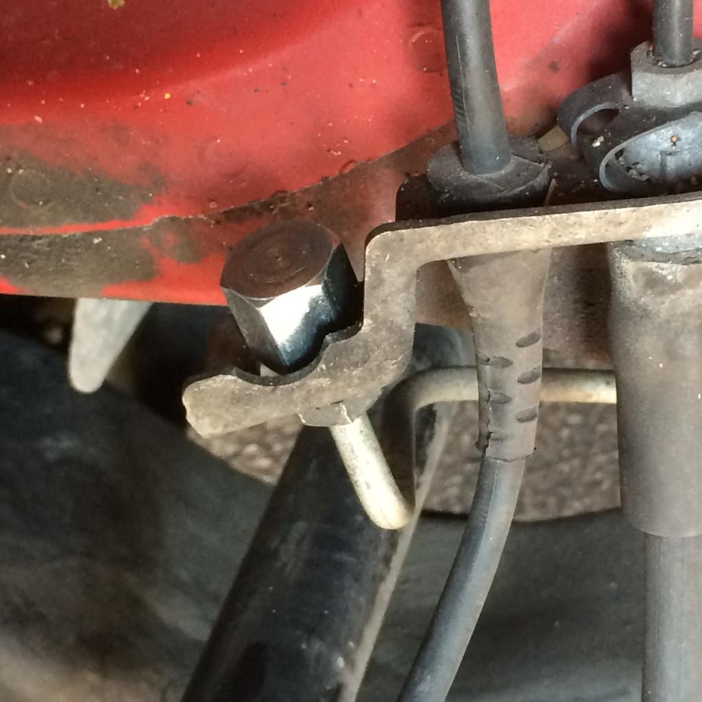

Installed pics for the driver’s side…
http://i1294.photobucket.com/albums/b601/rs4elitist/RS4/A0C0F926-8A32-4033-B3E2-EEABBBAB9F2B_zpszfterjyx.jpg
http://i1294.photobucket.com/albums/b601/rs4elitist/RS4/4095600E-A5A0-446F-BCA4-594F45DFA5A0_zps4vgcn6y9.jpg

Make sure you have a 13mm flare nut wrench for the lines, don’t try to use a regular 13mm.
The cap is 5/8" FYI.
