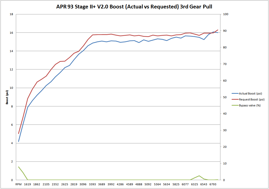

Here’s a chart I made way back when I still had a B8 S4:
https://lh6.googleusercontent.com/-3lAWG5DP-BY/T2NfDMt229I/AAAAAAAACE4/2NnpjMBaGzI/w1085-h762-no/boost.png
