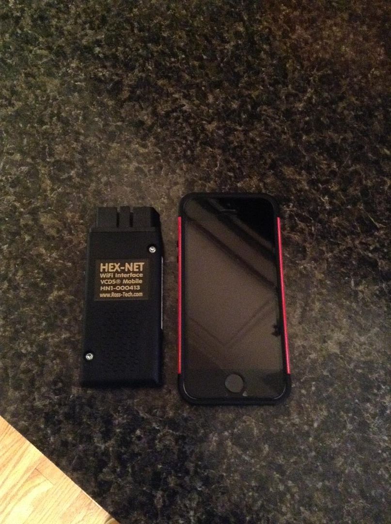

This is the wifi dongle by Ross-tech. Perfect for the glovebox and I can access it with my phone if my car throws a code or something. I take it on long trips in hot the Q5 and RS4. Like I said I need to start using it more to test some things, but it can also be plugged into a computer directly and works just like the cabled version.

Do you have a Rosstech cable? If so this would kind of be pointless. You also might want to look into the new Rosstech wifi dongle. I sold my cable and bought that because you can use it on any device with an Internet explorer. They also have an app created for smart phones.
How well would you say this works in comparison to the old school wired version + software? I bought the wired cable a few months ago and am curious if I messed up by not buying the wifi dongle. It’s not that big for me to hook up the laptop but opening an app on my iPhone which is already mounted in my car when I’m driving would definitely be way easier.
It works well and you can use it as wifi or as the cable version…so it’s basically a win win.

The wifi dongle can also be used as a cable version with the original VCDS windows program.
Nothing new really, just the option to have it laying in your glove box and if needed in an emergency you could do a scan with your smart phone app.
