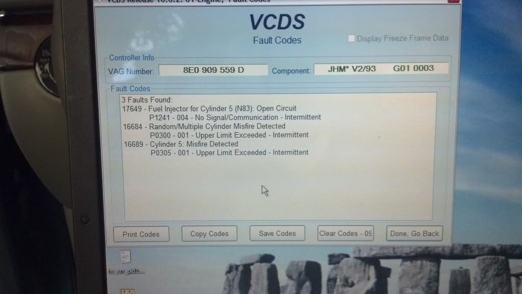

I haven’t had the tune that long I just got it at their last BBQ. I got out my Vagcom and just started wondering through it checking things as I’m not really very experienced with it yet and this is what I came up with…
Where it says JHM V2/93, does that mean I have the 93 tune??

Are those fault codes active?
What do you mean active? I don’t have a CEL on. They were just there when i checked the codes. I’ve had that Cylinder 5 code coming on and off for awhile now, whenever i disassemble that bank and swap coils or plugs it goes away for significant time and then comes back. The other codes I’ve never seen before. I think the issue with 5 is with a loose clip that when I take apart and put it back its fine, but then comes loose again. I think I may just need the red clips that hold the harness on because the one by 5 keeps coming unclipped, or at worst a new engine harness. I’ve already replaced the injector. And I’ve hard my tech repair the harness on that side so I know theres some intermittent issue there.

Looking at ur vag read out you have the 93 tune. So the car will be sluggish if you put in 91 because its going into less power mode.
Also you have an issie in cylinder 5. The car is running on 1 less cylinder when that injector isnt workingso keep that Iin mind. The missfire shows you the cylinder isnt getting power having one less cylinder will deffinitly make the car feel stronger with the proper fuel and can also csuse the car to stall on a cold restart
