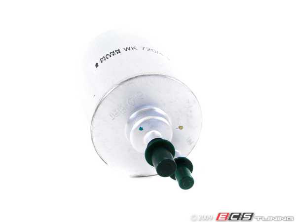

apparently we have a different fuel filter than the B6/7 S4 so be careful
no I don’t mean 3 line vs 4 line.
I mean 6 bar vs 4 bar. Gotta make sure you use the right RS4 filter. I have a couple of B7 S4 fuel filters at home from my old car (I used to stock up parts) that I can’t use now.

Ordered a replacement filter. 46,300 miles, original filter. No issues with my RS4, and let’s keep it that way!
As an aside, in this stock ECS Tuning image, you can see the “6.0 bar” stamped into the end of the cannister.
http://c1552172.r72.cf0.rackcdn.com/28968_x600.jpg
yeah it’s a different fuel filter to the B7 S4
