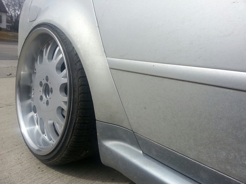

p.s. this rear camber is stancetardish lol

LOL. Here is the story on that…
I was test fitting some 20s at a VERY aggressive offset. I dialed the rear camber in to the MAX on the rear to see if I could squeeze them in. They were 245/30s stretched on a 10 inch wheel with a final offset of et13. It was close, but no cigar
http://gp1.pinkbike.org/p4pb9356086/p4pb9356086.jpg
I ran out of time, and just left the camber as it was at the max setting.
Then, I got the OZ wheels. The tires on them are 235/40/18. I more or less got them for free, and threw them on temporarily. So, I didnt care if the camber burned them up.
THEN, I loaded my car up one day with about 600 pounds of porcelain tiles.
Final result = stancetardish camber LOL
Definitely wont be so aggressive on the RS6, but I have to admit that I do like the look of it on these cars. They look best with the fronts wheels tucked in a bit, and the rear wheels pushed out to the max. IMHO

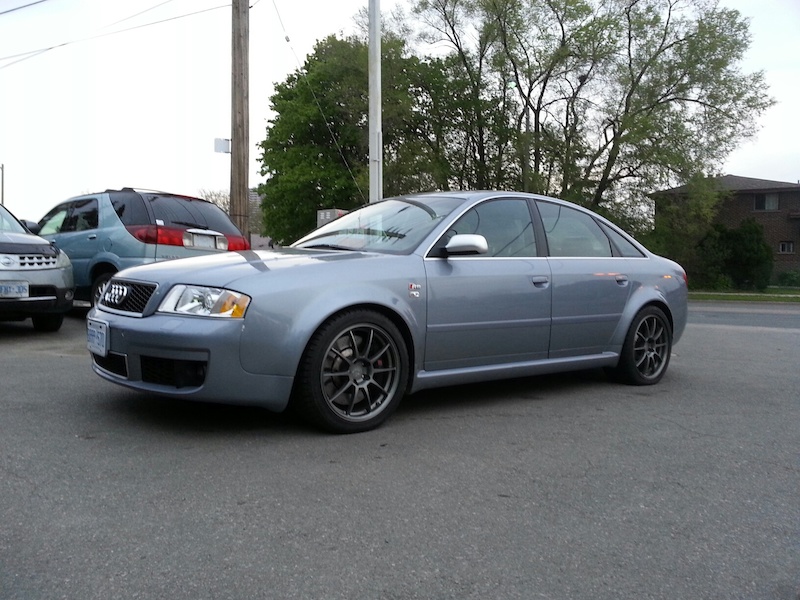

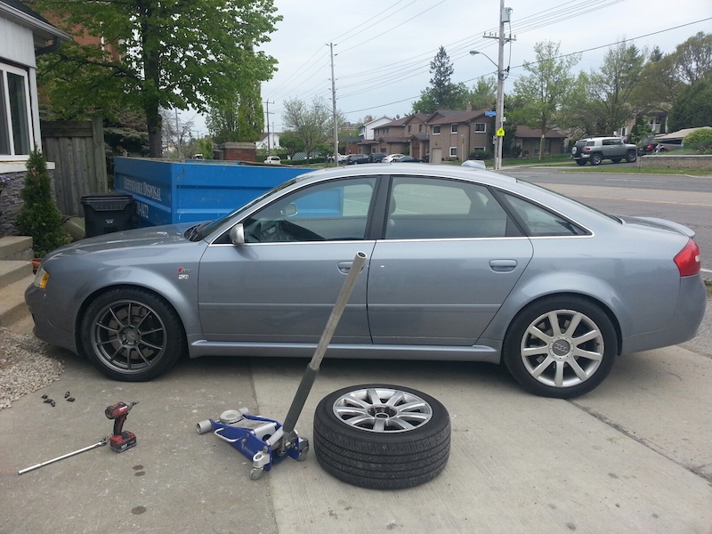

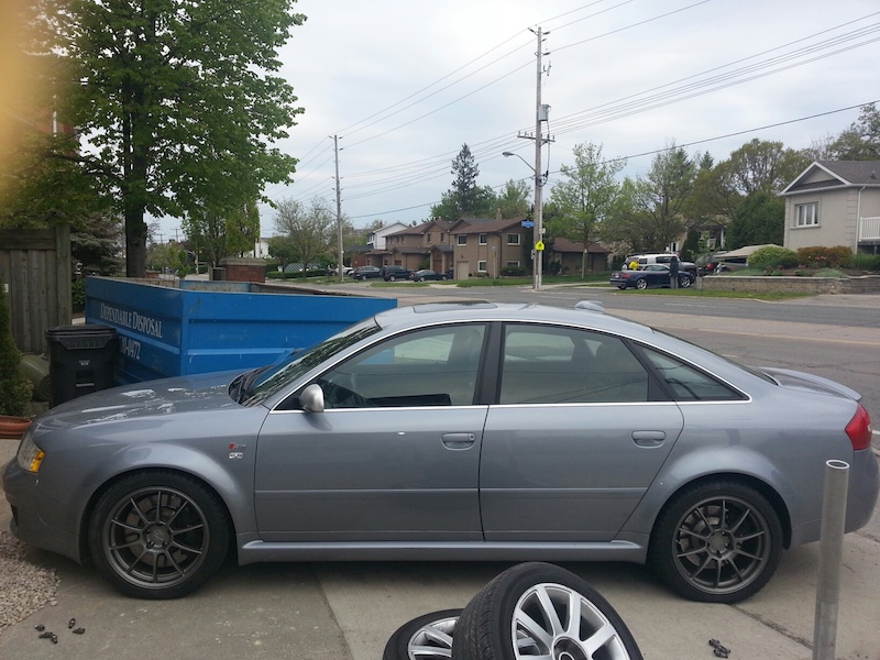

Removed the stock wheels, since I plan on selling them (and the tires were the wrong size). Put my winters on in the meantime. The definitely let you see the brakes better, but, to be honest, black calipers (even giant RS6 calipers) get lost.

Needs moar lower

wheels look good, with meater sidewall I think they’d look great
