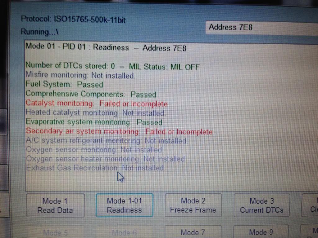

One step worse is that your in-house use of flying tomatoes car also left without being able to pass readiness. It’s looking more and more like internally people might be lying about their results.
Here is flying tomatoes readiness results. I don’t think he’s smart enough to know that his car is having the same issues and won’t pass readiness testing.
He posted his car not passing.
http://i44.photobucket.com/albums/f23/BaddAss93TA/81853A5A-196A-4854-A0C2-0BD8AB67CCA7_zpsv7xvcasg.jpg
