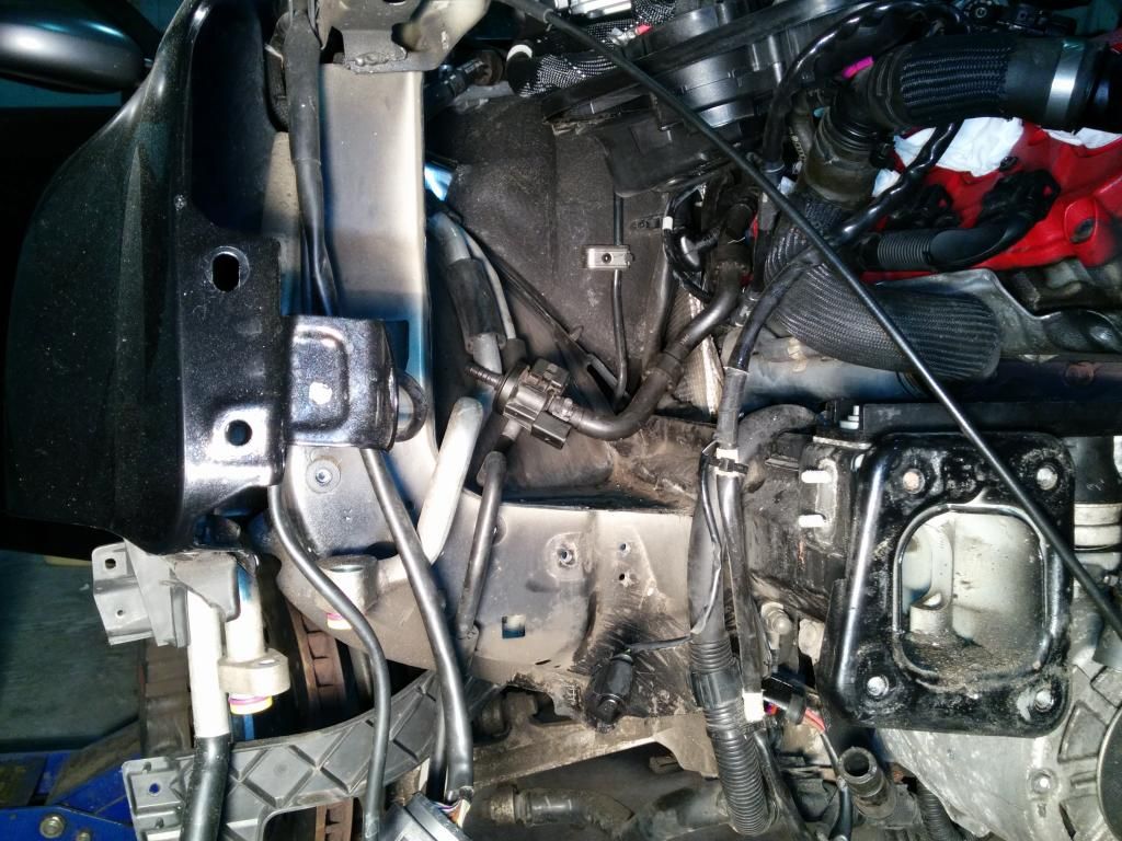

so whilst waiting for the o rings i decided to crack on and remove the secondary air injection system and ac dryer.
SAI no longer needed.
ac dryer bagged up waiting to be re homed.

with the quick mock up done i could check for clearance issues between the charger and bodywork.
i was aware when i bought this kit that a few pieces of bodywork would need trimming due to the size of the charger and the limited room in the rs4’s engine bay. jhm recommend trimming the bits in red in the picture below.
the red lines at the top of the picture are cuts in the lip that sticks out on the inner wing, these are then tapped flat with the panel below. if left as is these will saw through the intake and boost pipe in no time at all.
the cuts on the end of the bumper mounts are for clearance for the route the belt takes.
and the red square ish shape at the bottom of the pic is to provide clearance for the intake pipe where it attaches to the charger.
http://i1367.photobucket.com/albums/r794/sarrs4/jhm%20supercharger/cuts_zpseab394e7.jpg
jhm recommend trimming the metal, tapping back any sharp edges and sealing with paint.
being a painter/bodyworker i decided rather than just chop out a bit and tap it back i would cut out a slightly larger area (the blue line on the pic) and let in a plate to finish it off. this is not necessary but i couldn’t help myself.
quick plate fabbed up.
edge cut and tapped flat, plate welded in and ground up.
sealed up, primed up and painted.
with this done the only thing left to come in to contact with the charger is part of the engine wiring loom. this is fastened out the way using the now spare bolt hole from where the secondary air injection was removed.
