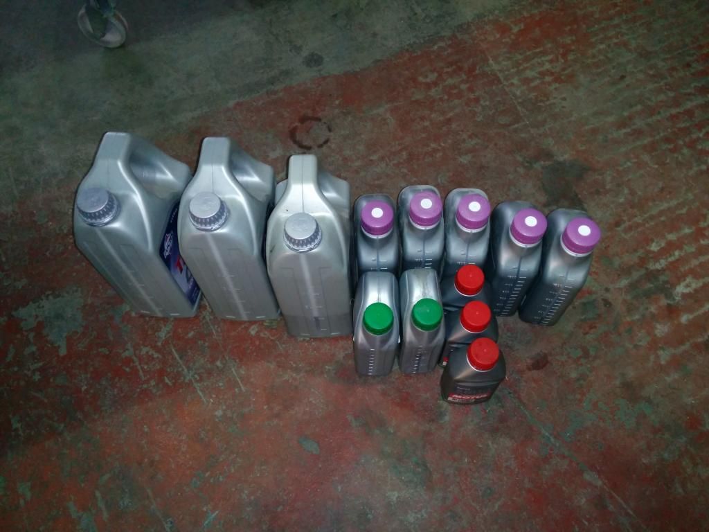

with the bumper and bonnet (hood,lol) back on it was time for fluids
http://i1367.photobucket.com/albums/r794/sarrs4/jhm%20supercharger/IMG_20140902_174709_zps2b4f3b1f.jpg
