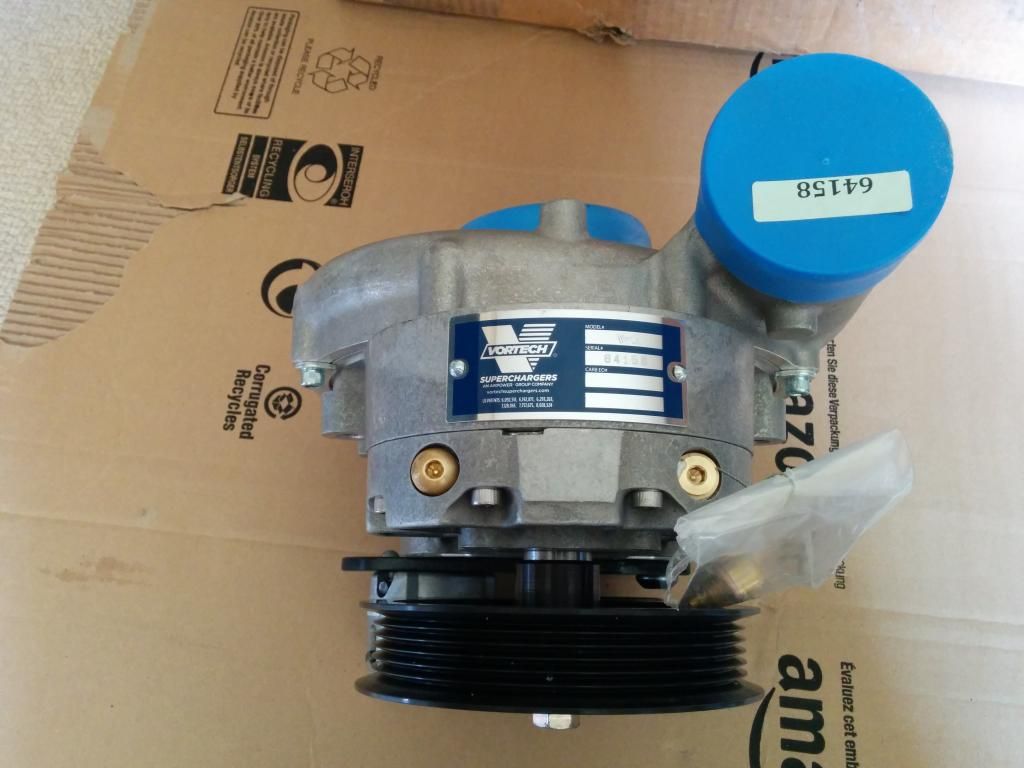

really excited to get this under way because Nick is a down to earth person that is willing to learn and invest time into this platform. We started tearing her apart and cleaning it up. Didnt want to bolt up all these brand new parts onto a filthy motor lol.
Ill update this post as we go. in the end we’ll strap her up to our dyno for all you knuckle heads that love dyno #'s so much to get an idea of what she puts down.
Heres some pics to start
Comparing the Vortech blower to the Precision 6766 out of our drag STI.
