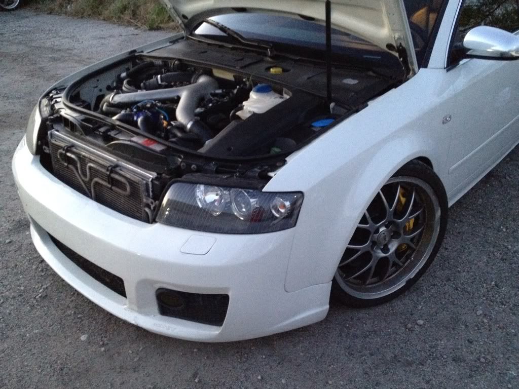

HUGE Shoutout to Jfonz tuning! He has been helping me throughout this swap and this isn’t even his first B6 S4 2.7T he’s tuned. PM me if you have any questions, but this definitely changes the game.
http://i248.photobucket.com/albums/gg186/AudiA4_18T/03ee8bc1.jpg
http://i248.photobucket.com/albums/gg186/AudiA4_18T/2777a5dd.jpg
http://i248.photobucket.com/albums/gg186/AudiA4_18T/4b4cd97b.jpg
Oh and ChrisK, I also did EVERYTHING myself on this. I had to get a shop custom make me an exhaust but thats about it. No codes other than a speed sensor that I just need to resistor.

V8 replacement used would be ~$5000+ from what I’ve seen and the lower priced units have higher miles which would mean possibly chain replacement that pushes the price up.
This swap can be done for ~$2000 on the low side

  1. Jfonz wrote me a tune. Yes I admit I could learn ME.7x tuning but that’s not in the plans for me right now so I had to outsource it like most people. If you want to count that it’s cool. His tune did nothing to band-aid my project, it’s an off the shelf file
  2. I got my friend to make me an exhaust. I don’t have the welding/fabrication equipment right now on top of me not really even having a place to live down here so I fully admit I didn’t fabricate the exhaust. I didn’t think this would be a big deal?
  3. Other than that, I’ve talked to a few people who did the swap but had no one hand me anything. I tried the B5 power steering line, the 1.8T mounts, the trans spacer, the wiring. It was all me, I did it in my driveway. No one said “here’s how you do it.” The B62.7T guy on AZ is a nice guy and was telling me how he did his cruise control (which I probably won’t do) and how he wired his fans (which I’m not even going to follow). Talking to people doesn’t mean I didn’t do this myself (at least to me).
  4. This swap costs $2000. You could make it cost $5000 or whatever. Mine cost a bit more because I bought a bunch of unnecessary stuff like a 3.0 rad support or auto downpipes that didn’t fit. The motor was $1200, the power steering line was free, wiring was somewhere in the $50 range, + the exhaust. You could use an S4 exhaust (which I didn’t I sold for ~$800) and the SSAC downpipes for ~$150. I still need to get A/C lines and do the fan wiring at the cost of maybe ~$200-$250. So did I spend more than $2k? sure. Does everyone have to? No
  5. Chris I go for the hunt more than the kill. My friends don’t understand this but my mind is always wandering and as soon as something is done I want to move onto the next. On top of this, I know my personality and will want to do K04s, fueling, etc and I really shouldn’t be at this point in my life (moving to a new place) so I thought selling it might keep my mind off things. It’s a really cool car though, I have nothing against the swap I think it’s awesome. Once I’m driving it down here I might change my mind and I’m still on the fence about keeping it. Also, given I didn’t work on it for at least 5 months, it’s hard to say 1 year. But fair is fair and I fell slightly short of a year.
  6. Chris to me this stuff is simple. It’s a process just like anything else. Once people know how it’s done it’s one of those “oh, that’s it?” moments. I move onto the next project to make it harder and more complex. It’s a way to challenge myself. I apologize if I leave out things in pricing. I put most of it up there but haven’t updated it. Trust me I know how much stuff costs and I’m the first one to bash some 1.8T guy saying they want 500awhp. Most don’t know what it costs, but this is fairly straight forward and at the cost of $10k+ for 1.8T guys to make 400whp this is a cheaper option with a better powerband.
