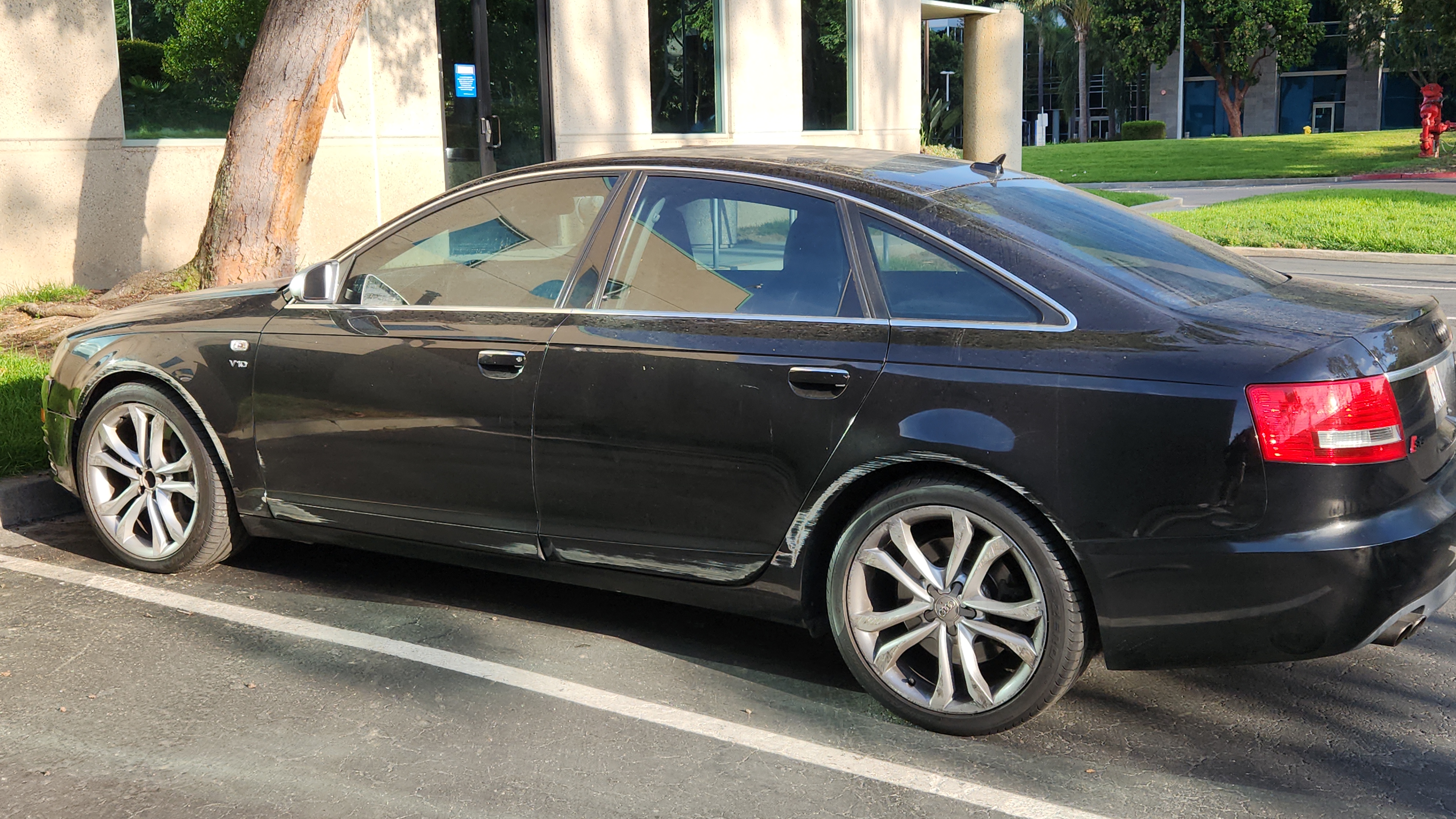

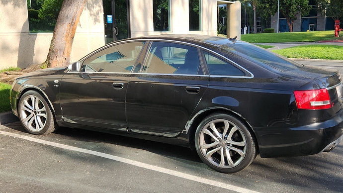

This poor car also in an accident where the driver had a flat on the highway and hit the median barrier. It scraped the side of the car and although it looks rough, I can tell it didn’t hit the frame. It luckily only scraped the wheels and some of the fender/side skirts. I would appreciate any body techs here that can help me out and get the scratches looking better.
I write this to sort of have a roadmap of getting this car back to its former glory.
Hopefully this thread can also serve as a good reference for more up to date parts/links for others who may encounter these issues as well.
I will be adding photos on a separate post
Here is the scratch

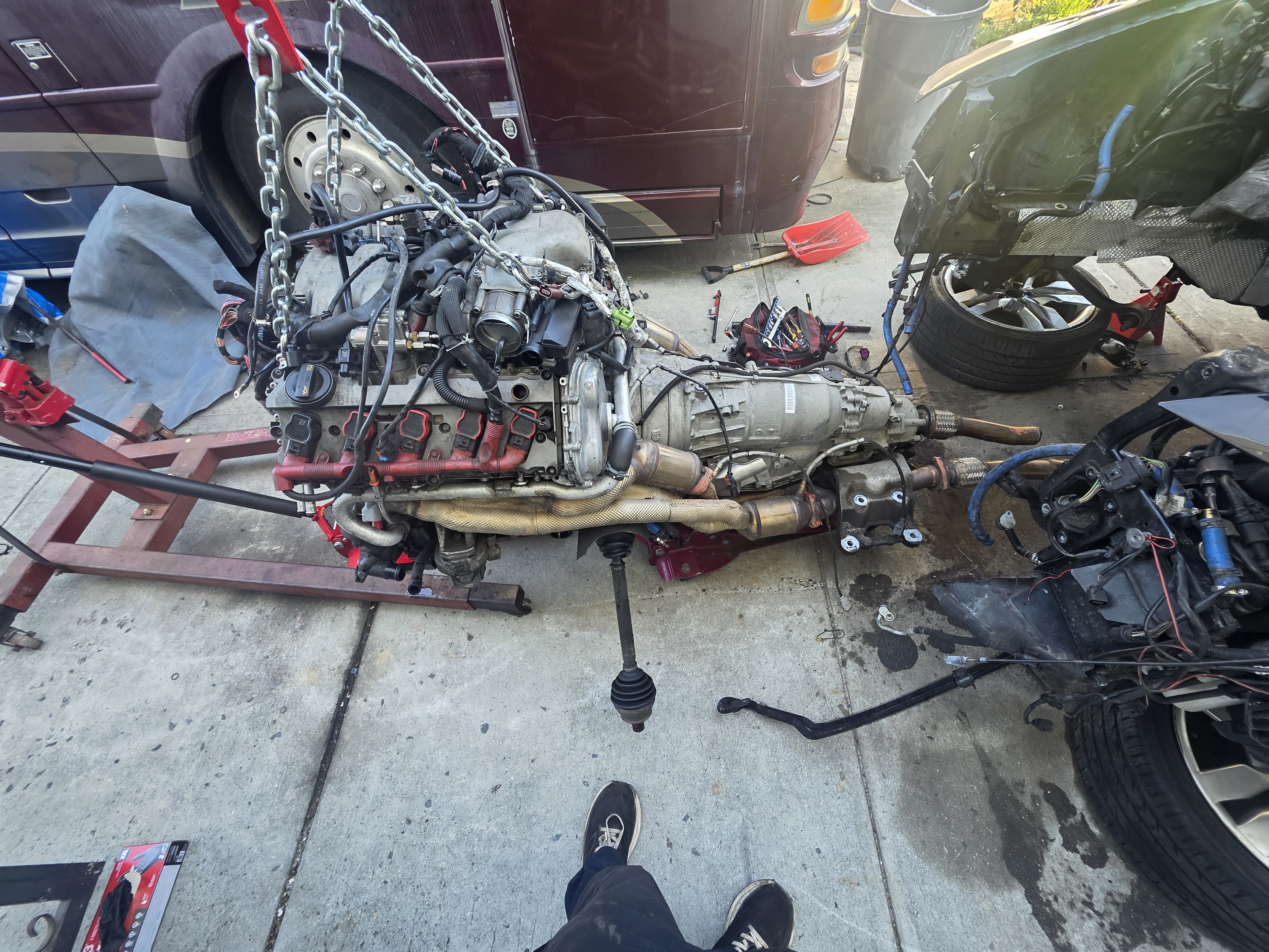

I am currently pulling the engine to change the trans. I dont have any pics since its super redundant to me

Also thats currently my s6 motor out below
I dont know if its bad that I know where every bolt and hose goes when I drop the engine. I no longer sort and only time I use the manual is to double check torque specs lol

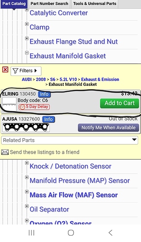

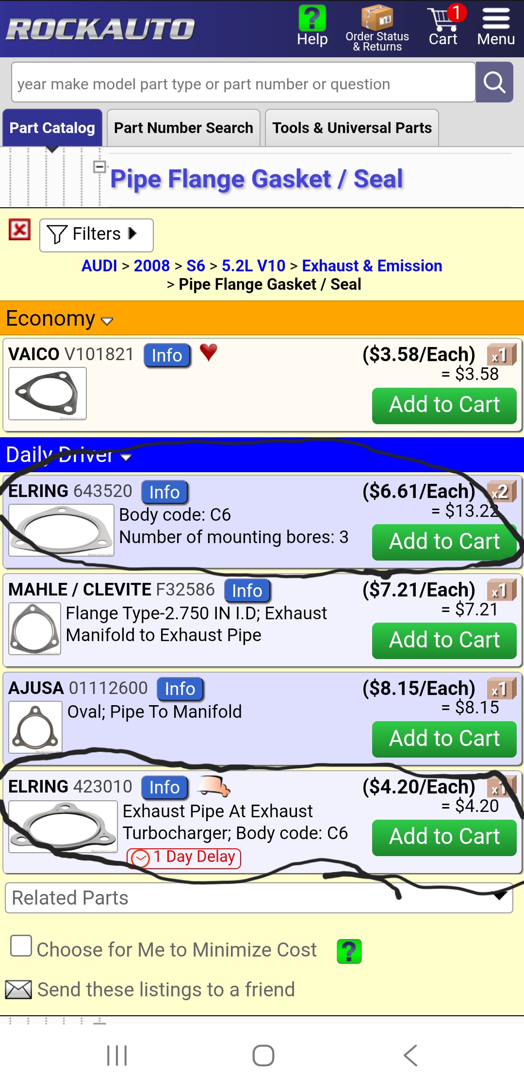

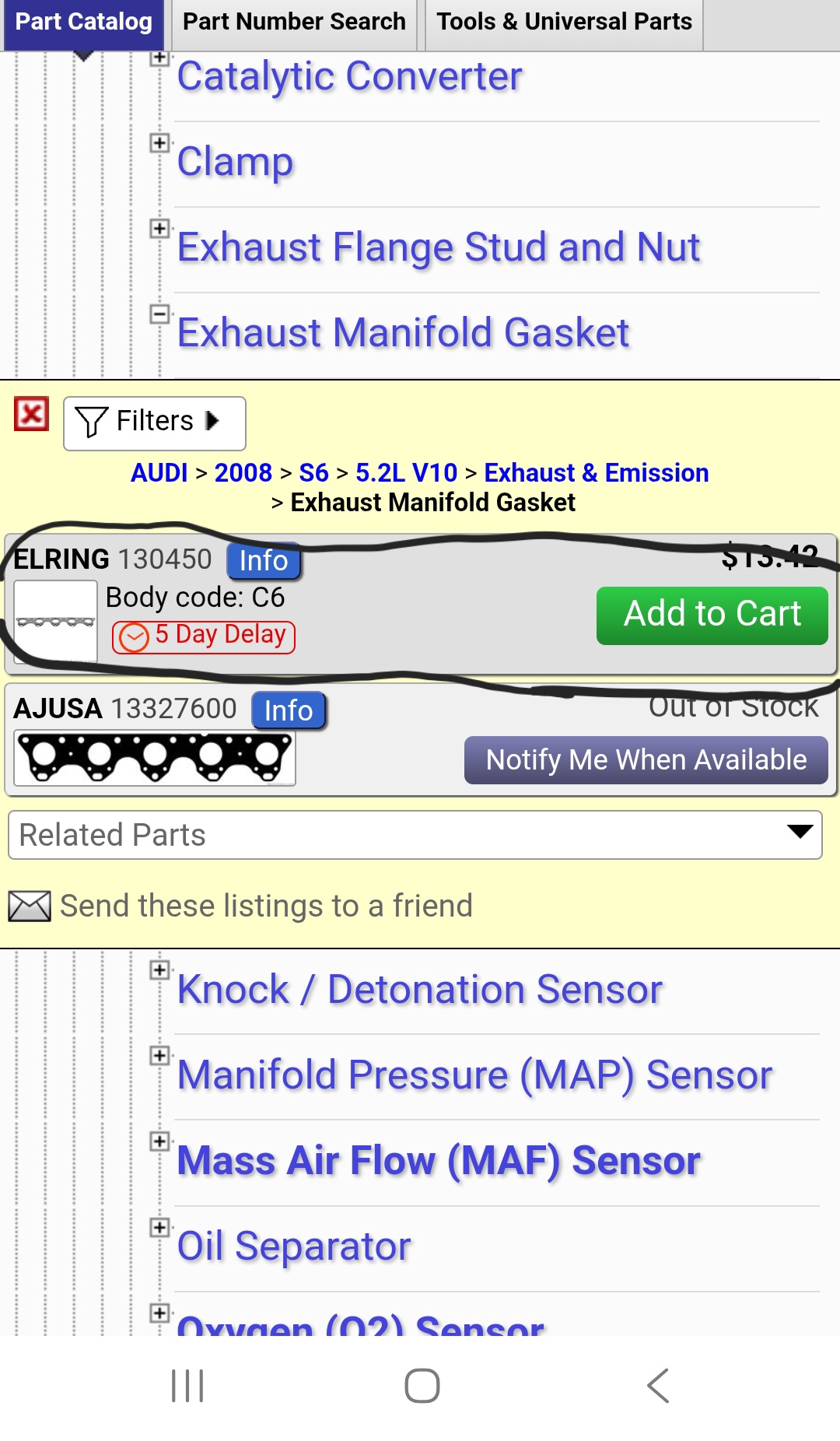

For exhaust gaskets get 2 of each one that I circled on rockauto
And 2 gaskets of this from fcpeuro https://www.fcpeuro.com/products/audi-vw-catalytic-converter-gasket-genuine-audi-vw-4e0253115a
For me I get anything elring wise if I can find it. Im sure you can find it all on fcp euro but generally rockauto is cheaper. Im pretty sure you’ll end up ordering from both for certain things. The o2 sensors and starter you definitely get from rockauto unless you find it cheaper elsewhere
