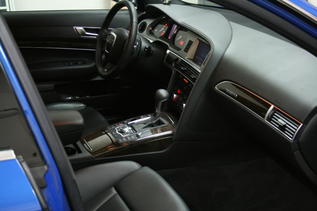

Interior wasn’t bad. Leather Masters for the seats, Adams carpet cleaner on the carpet, Einszeit Cockpit Premium on pretty much everything else
http://i183.photobucket.com/albums/x59/joec1992/IMG_4535.jpg

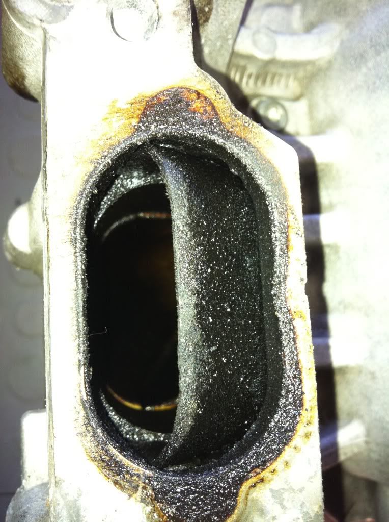

Fast forward about a year…He tells me he’s getting a flashing CEL. The car is still under warranty so he takes it to the dealer and they tell him it’s carbon. Dealer wants $2400 to do the service. I told him I’ll do it and make a DIY for the Audi guys (in the works).

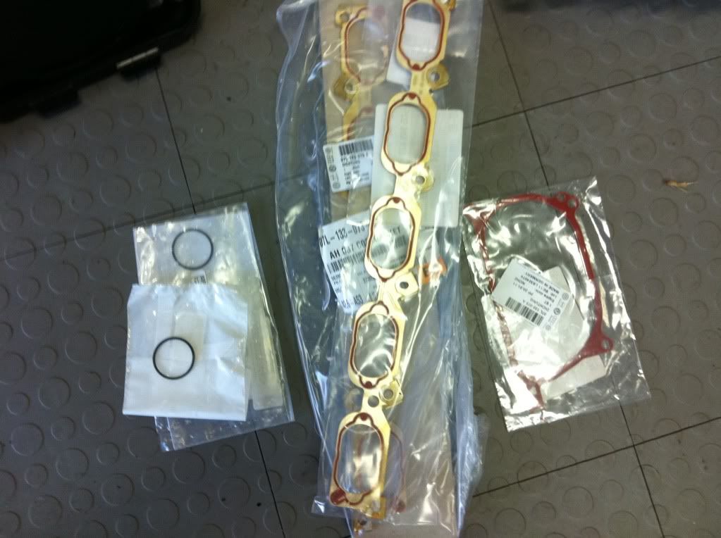

So I ordered all the necessary gaskets from JHM. Ordered 2 K&N drop-in air filters as well. Also replaced the spark plugs with OEM NGK’s
http://i183.photobucket.com/albums/x59/joec1992/photo-158.jpg

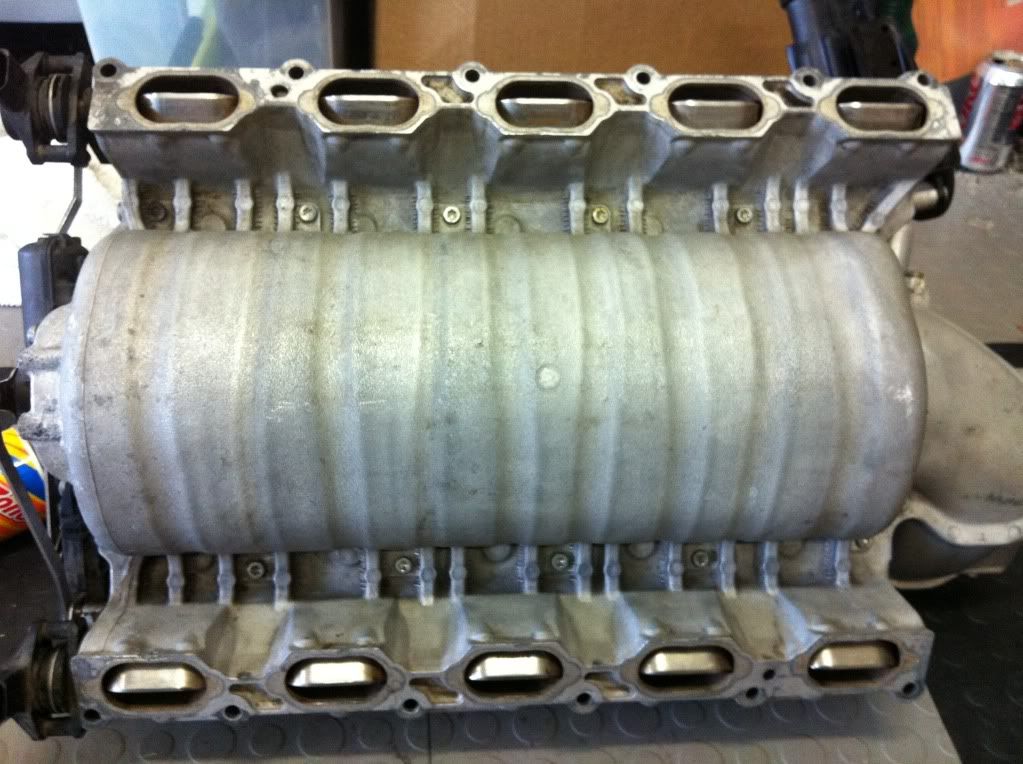

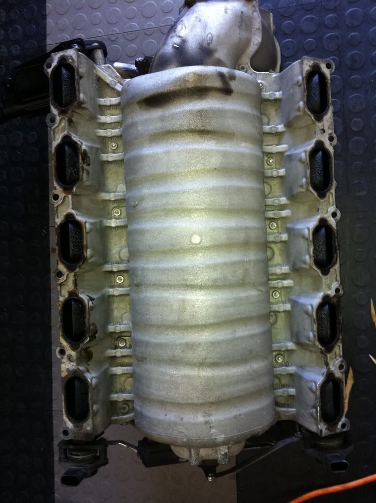

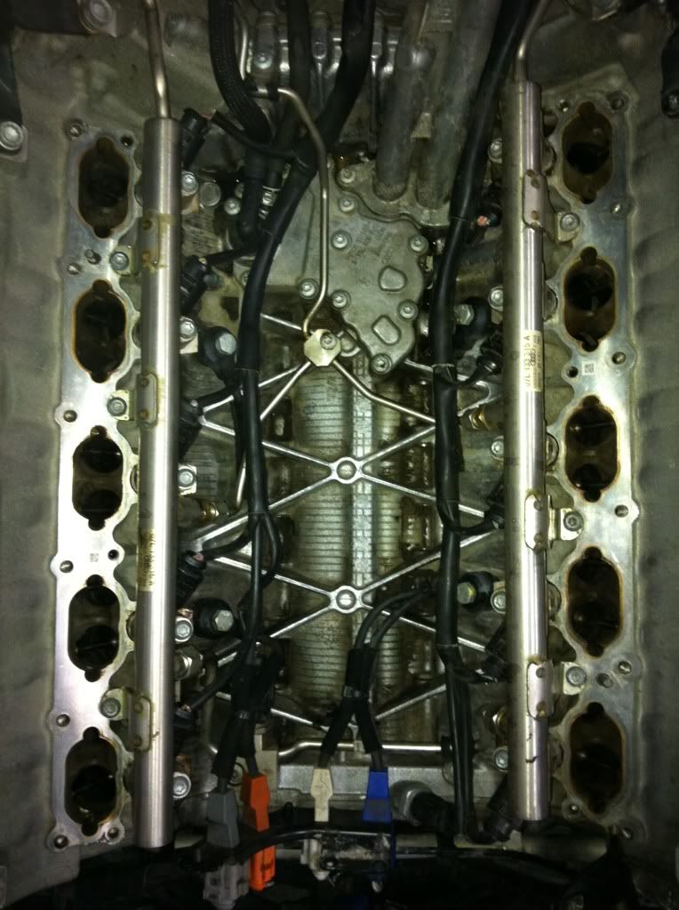

Took the IM off and this is what I found…bad bad bad
http://i183.photobucket.com/albums/x59/joec1992/photo-130.jpg
http://i183.photobucket.com/albums/x59/joec1992/photo-144.jpg
http://i183.photobucket.com/albums/x59/joec1992/photo-134.jpg
http://i183.photobucket.com/albums/x59/joec1992/photo-131.jpg
http://i183.photobucket.com/albums/x59/joec1992/photo-135.jpg

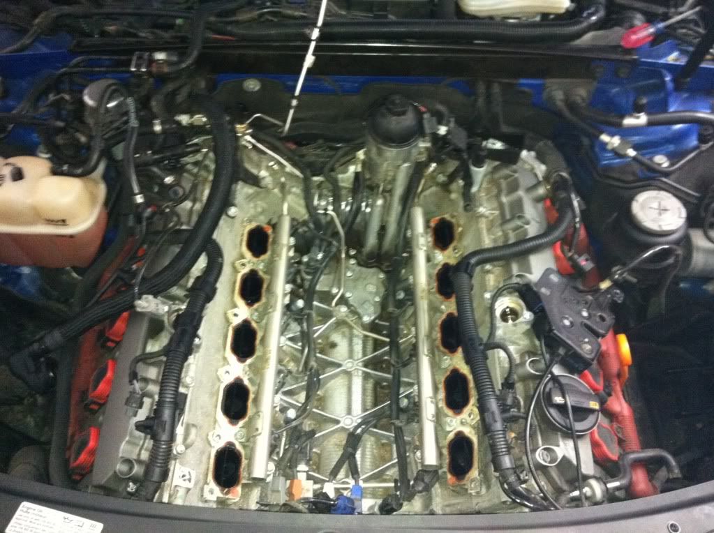

Then I got to cleaning…Each port takes about 30mins to do both valves.
http://i183.photobucket.com/albums/x59/joec1992/photo-139.jpg
All clean!
http://i183.photobucket.com/albums/x59/joec1992/photo-136.jpg
http://i183.photobucket.com/albums/x59/joec1992/photo-141.jpg
http://i183.photobucket.com/albums/x59/joec1992/photo-159.jpg

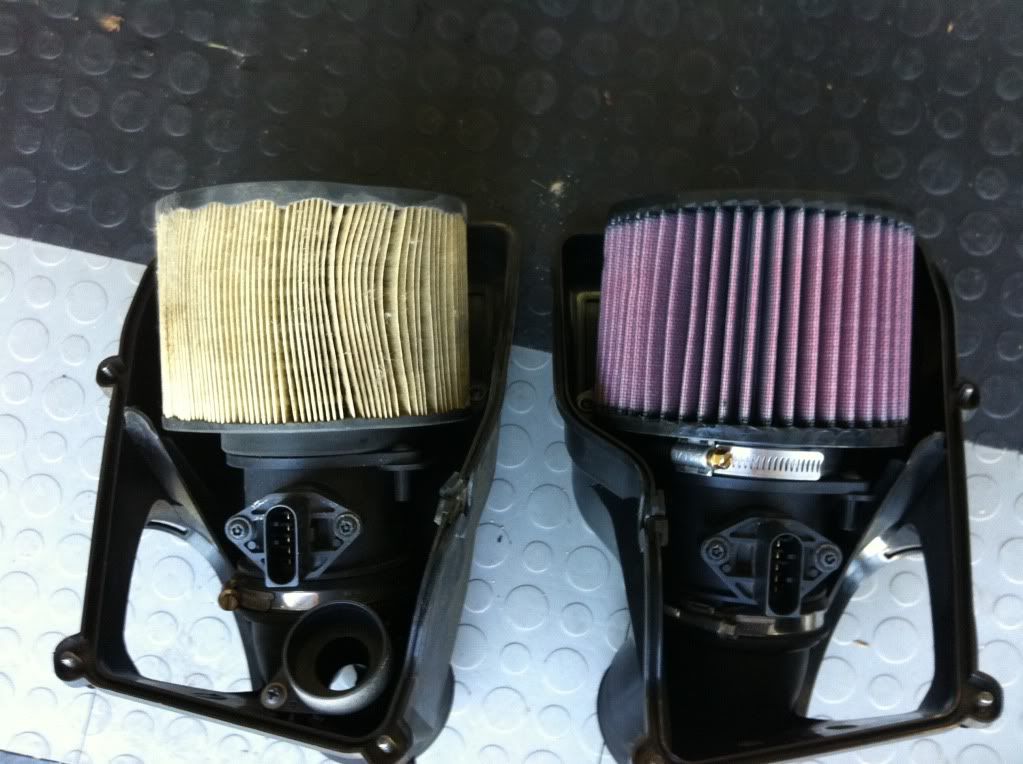

K&N’s installed
http://i183.photobucket.com/albums/x59/joec1992/photo-160.jpg

joe can you take a few seconds and show us how this looked before you installed the k&n filters. I find it odd that this would be the filter replacement. I don’t think the surface area looks big enough for 2.3L. I know its a picture so I don’t get a real good understanding on how big the filters are. I just thought I might have found a little more room for power in the filters
let alone 2.6

Yup, that’s the little filter and really, that’s th biggest that could possibly fit. There’s a lot of real estate between the grille and condenser so a ram air would be feasible
Product page: http://www.knfilters.com/search/product.aspx?prod=e-2996
K&N testing on this filter: http://www.knfilters.com/dynocharts/E-2996.pdf
Here it is right next to the stocker:
http://i183.photobucket.com/albums/x59/joec1992/photo-163.jpg
