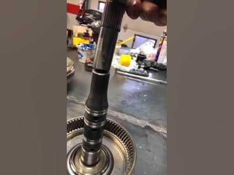

Not so long ago in January car had error of Engine Overspeed. After reset everything was ok. Continue driving car daily until mid of February when car left me on road.
Stopped on red light and then when continue driving, strech gear and instead of shifting from first gear to secon it make bang.
PRNDS light come on, reset everything and car its not engaging gears. Moving shifter through all gears and it’s show on display, no errors, engine revs but not pull.
Car was towed to mechanic shop and here is result in video below.
Everything electronically was ok, clutch plates ok.
That’s crazy. Don’t think I’ve heard of that happening before. Until the I saw the video I assumed it was your mechatronic unit that failed. Good luck.
Car is going smooth, shifting like nothing happened…

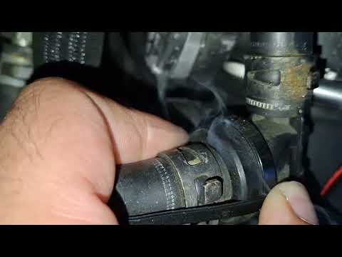

Today received special tool and diagnostic is not so bright
p
https://youtu.be/ilSUiiqVSTE?feature=shared
Oh no is that the manifold or valve covers?
As observed for now, it leaks on throttle, between IM and Y plenum and on left side intake hose where are 3 vacuum connections
