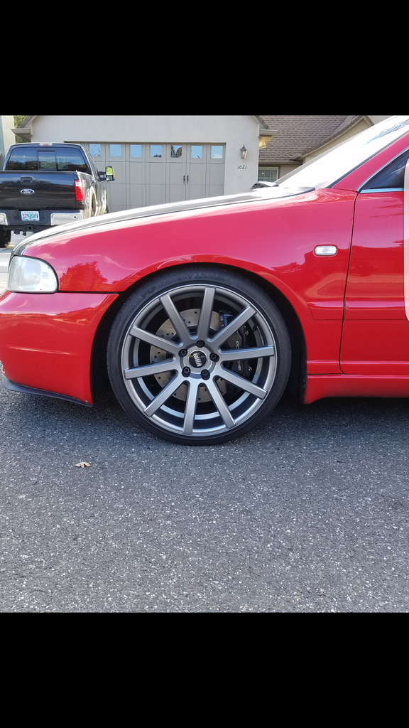

Got the rotors/calipers finally done. Both the rear mid- brake lines stripped while swapping in the new lines, so I ended getting preflared 8" sections at the local brake parts supply and making that fit after unsuccessfully flaring my own lines. It came out really subtle.
http://i725.photobucket.com/albums/ww254/m-tre/Mobile%20Uploads/Screenshot_20161031-193649_zpsryrsmw9i.png
http://i725.photobucket.com/albums/ww254/m-tre/Mobile%20Uploads/Screenshot_20161031-193712_zpsdjbuin94.png
