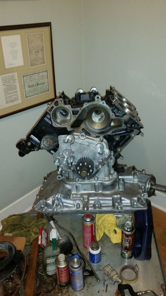

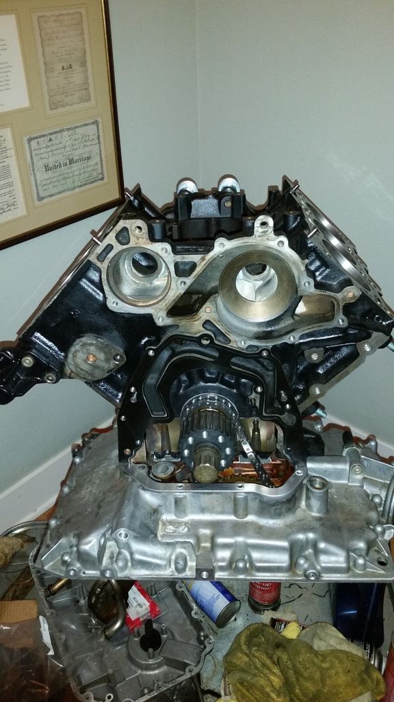

Got the new oil pump chain installed, began installing the front sealing flange and realized I couldn’t pull and press the front main seal at home, so I will do on my lunch at work tomorrow. Heres a few pictures.

Old front main seal pressed out and ready for new one

Installing oil supply lines AFTER buttoning up front seal flange

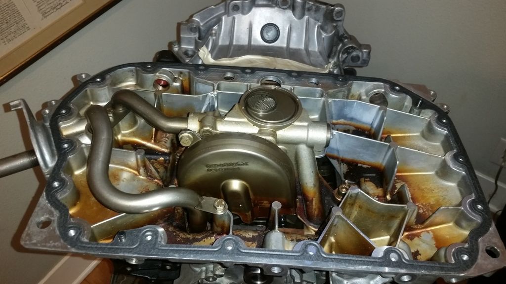

Fitting Lower Oil Pan Gasket (listed for the 2.8l 30v)

and where it sits as of right now, I will be ordering a Valley Pan Gasket next and then dive into the cooling system

Realized I forgot to put on the oil chain tensioner, so a little disassembly was in order, not a big deal. I got a bag of parts as well, valley pan gasket, new rear flange/gasket, and oil chain tensioner. Anyways, I will seal it up tomorrow and be done with the lower end. I did buy a 2001.5 intake manifold, maybe to send out and have it modified, maybe to powder coat or maybe just a waste of money as I do keep hearing a voice in the back of my head to just buy the RS4 manifold, we ll see.

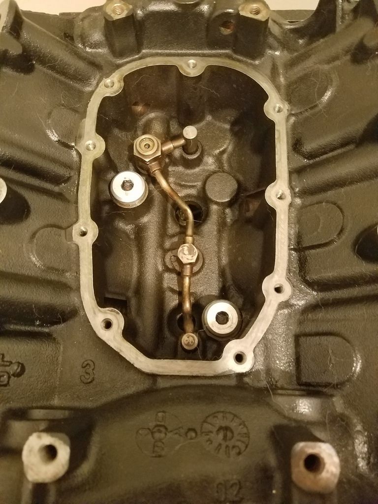

Got everything back on track, also moved forward with the Crankcase Breather (Valley Pan and Gasket). I didn’t bring home any of my hex bits, so I will have to torque it down tomorrow, but it is in place.

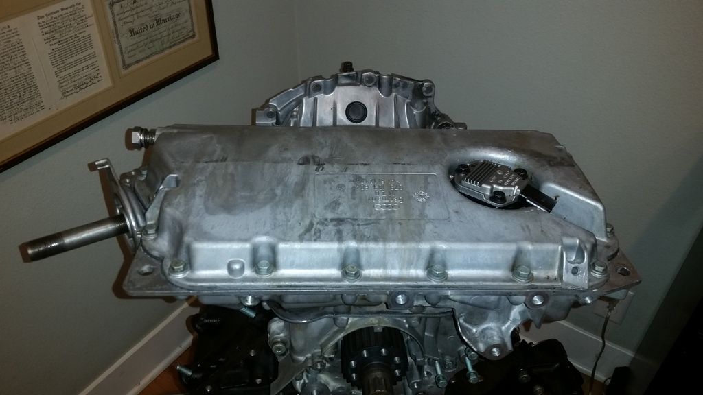

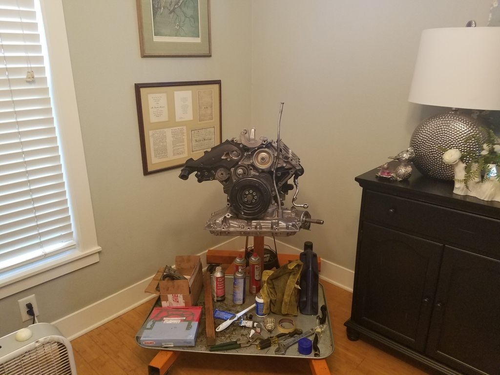

I got most everything bolted in, obviously I need a new thermostat housing/thermostat, a bolt for the harmonic dampner, and I have to put the motor back on the hoist to complete the rear sealing flange. Next big undertaking is to take the heads in and rebuild those. I am trying to decide between a stock valvetrain or build it so I can rev higher, some input would be appreciated.

Handsome lad…
I know its not the case, but the 2.7 engine looks to have a cozier spot in the house than the pup! Whats up with that? :smiley:
Lol, Au contraire mon frere :wink: the whole living room is dog beds, pillow pets and squeaky toys.
