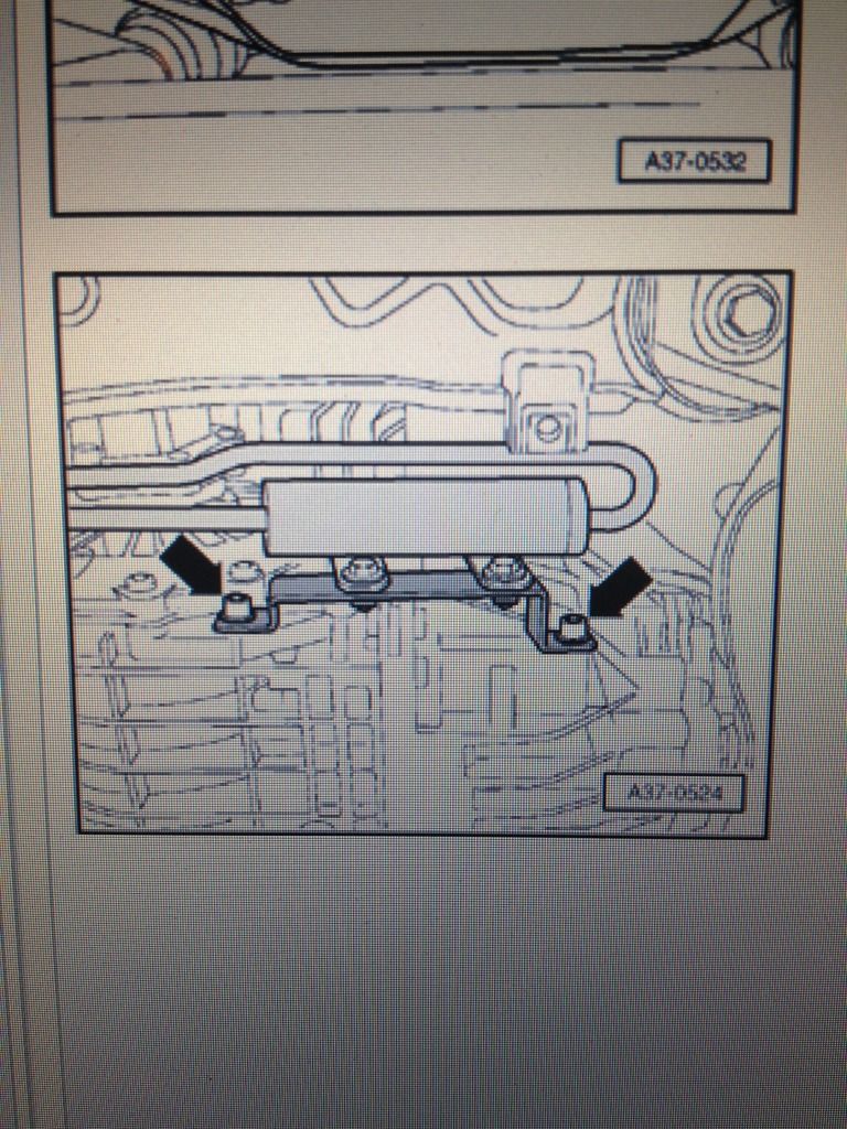

The 2010 S4s had a few differences that made servicing it a pain in the ass and Audi went to a newer style for the 2011 S4s. I don’t think they made any big changes to how it operates other than maybe software changes but it should be more reliable - I will get to that farther down so please bare with me.
The 2010 S4s had a S-tronic trans with an external in-line filter that looks like this:
http://i284.photobucket.com/albums/ll37/Jimmybones777/transmissionfilter.jpg
It is the same style filter as the old Multitronic front wheel drive transmissions. You would have thought Audi would have realized that it doesn’t work since sooooooooooooo many Multitronic transmissions failed left and right. That filter is also expensive as shit! Which is probably why only the DSG oil gets changed at 35K miles for the 2010 S4s as the 2011 S4s get new oil and a new filter. Here is a link to the maintenance schedule on AOA’s website if you would like to look it up: http://www.audiusa.com/us/brand/en/owners/audi_service/service/maintenance.html
On a side note, I noticed when going through the maintenance schedules that only the 2011 automatic Q7s get their trans fluid changed - that is a nice curve ball to screw up a ton of dealerships. Also the 2012 R8 GTs use 10W-60 oil, which is thick stuff. Sorry I get sidetracked easily.

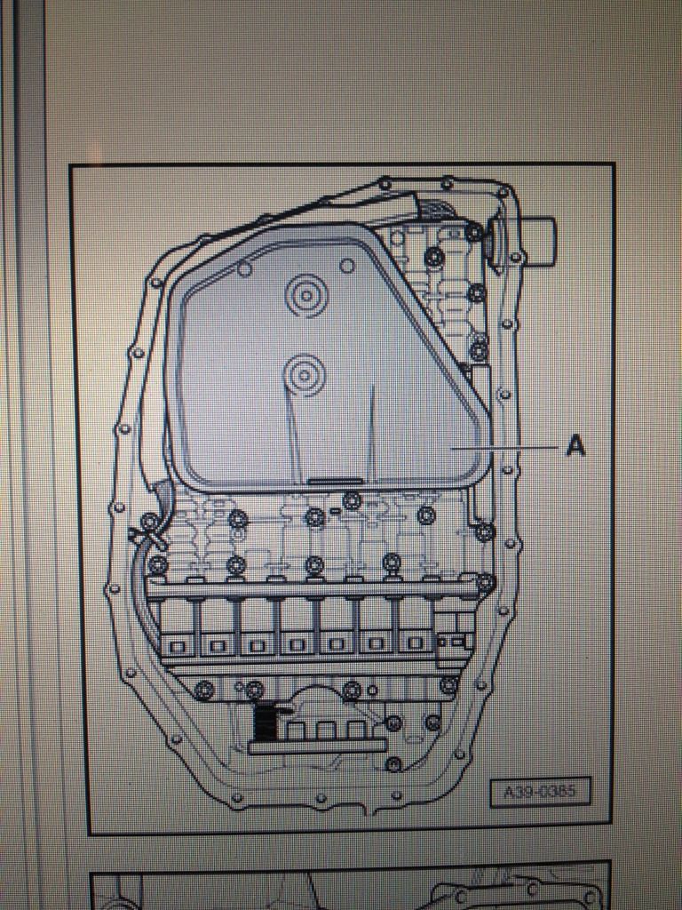

The 2011 S4’s DSG transmission filter is like the normal automatic transmission filter that is held in by an O-ring. It looks like this:
http://i284.photobucket.com/albums/ll37/Jimmybones777/transfilter2.jpg
Or this:
http://i284.photobucket.com/albums/ll37/Jimmybones777/Transmission-Filter-AUDI-Q73-6-0AT325-429-.jpg
Did you notice I said that the filter is held in by an O-ring? Guess what I have seen happen with Audis ranging from A4s to A8 W12s? That is right the filter falls down and the trans makes a ton of noise plus it will not move the car very well. But in the end that filter is a lot cheaper to make and they don’t pay the techs any more time to replace it even though it takes a more work. There is also a TSB that covers the two different style DSGs and it states that the external in-line filter style transmission was replaced with the newer style internal filter transmission. The TSB also states that if one of the older style transmissions is replaced that the newer style transmission requires a filter change like the newer models but good luck getting Audi to pay for it under audicare.
