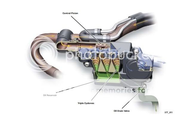

for refrence post a clear picture of your motor and the back where the PCV system is. we can then show you where you can dissconect the PCV system to test this.
I think both suggestions are a great idea and a good place to start. We need to start removing vairables first.
Two images for different views; one is on the RS4 block, the other the Q7 - same basic set-up though. You can see the paths of the breather tubes to the valve covers, the PCV unit itself, the drainage tube, the return tube etc.
http://i834.photobucket.com/albums/zz269/NY07RS4/RS4PCVFineOilSeparatorimage.jpg
http://i834.photobucket.com/albums/zz269/NY07RS4/PCVpartsadditionalangleforreference2.jpg
One more:
Time to sell as mint and get a GT3 like our friend Joey Cuccaro.
If you follow the path you can see that the most likely situation for oil to get into the motor would be threw the breather pipes then passing into the crank case breather system into the intake tract.
Follow what carlos said. Take off the oil cap and you want to see if there is a vac or a push of air. This will tell you more. Also keep in mind when you change or remove the crank case pressure system the car is going to run a little different. Don’t do it for ever and make sure to take precautions to not get anything into the valve covers or intake track when testing.
Also check to see if your throttle body has oil around the blade.
I also agree. The path to fixing the issue is sorting out all the facts like the dealer would or should I say should.
I agree CV, looks to be the most reasonable entrance based on the pictures from the self study guide.
