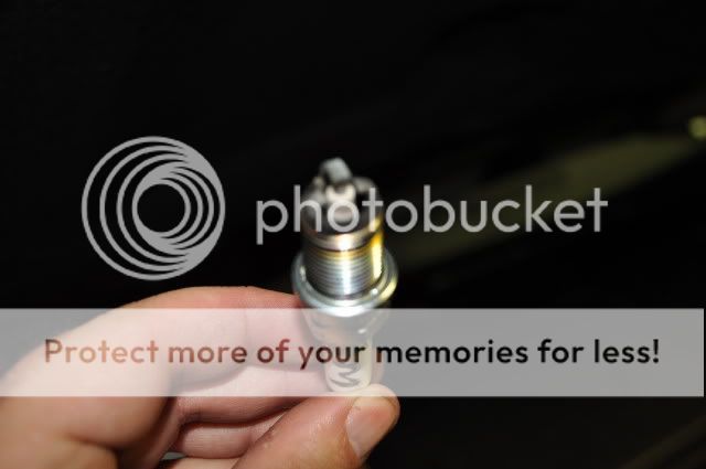

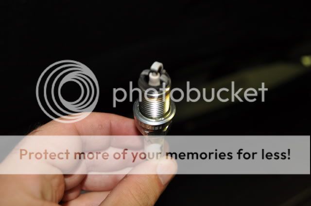

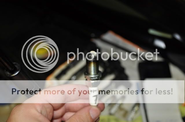

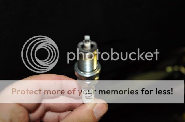

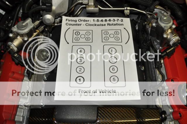

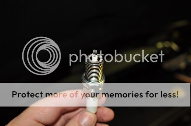

Reference for above and for spark plug reference:
http://i834.photobucket.com/albums/zz269/NY07RS4/Compression%20Test%20dry%2010-31-2011/DSC_0591.jpg

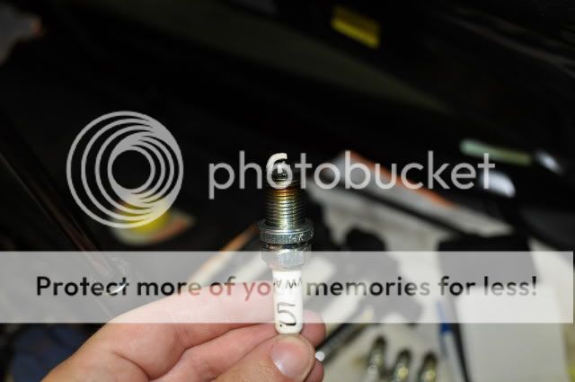

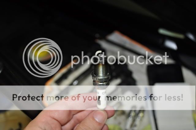

Spark plugs:
http://i834.photobucket.com/albums/zz269/NY07RS4/Compression%20Test%20dry%2010-31-2011/DSC_0577.jpg
http://i834.photobucket.com/albums/zz269/NY07RS4/Compression%20Test%20dry%2010-31-2011/DSC_0578.jpg
http://i834.photobucket.com/albums/zz269/NY07RS4/Compression%20Test%20dry%2010-31-2011/DSC_0579.jpg
http://i834.photobucket.com/albums/zz269/NY07RS4/Compression%20Test%20dry%2010-31-2011/DSC_0580.jpg
http://i834.photobucket.com/albums/zz269/NY07RS4/Compression%20Test%20dry%2010-31-2011/DSC_0581.jpg
http://i834.photobucket.com/albums/zz269/NY07RS4/Compression%20Test%20dry%2010-31-2011/DSC_0582.jpg
http://i834.photobucket.com/albums/zz269/NY07RS4/Compression%20Test%20dry%2010-31-2011/DSC_0583.jpg
http://i834.photobucket.com/albums/zz269/NY07RS4/Compression%20Test%20dry%2010-31-2011/DSC_0584.jpg

do you have any problems/symptoms/performance issues other than the smoke?
sounds like you don’t have an oil consumption issue
sounds like you don’t have a scored walls issue
sounds like you don’t have any other compression issue
I guess that’s all good news.
