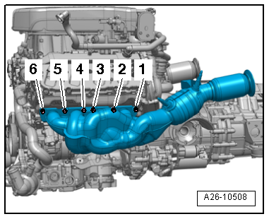

I know the cylinder spacing is different but if they used the same block the exhaust ports wouldn’t have changed necessarily. I mean look at that… :-X Easy way to test just grab some exhaust gaskets for the lambo and see if they match.
The one on top is the lambo the bottom ours
How can they use the same block if the cylinder bore spacing is different? The 5.0 and the 5.2 are different blocks.
I was saying IF they used the same block I thought the difference was the bore and stroke. That gave the 5.2 the additional displacement. I could be way off. But the similarities are striking.
I am just saying it is worth a look
My take from all this is that you guys are in the right direction with the S6 headers. You can see the Lamborghini and R8 v10 headers are more like the ones you guys are building. So far everything continues to point to headers unlocking the real performance of the S6 V10.
We went through this with the 4.2 s4. Lots of guys tried to take rs4 headers and make them work on the 4.2 s4. The one guy who did get them to fit spent more money then getting the jhm headers and his before and after dyno and Acceleration tests showed little to no gain possible a loss due to the rpm and cam profile difference between the RS4 and the s4.
Using or adapting Lamborghini or R8 parts is a great concept but even if you get them to fit they were made for motors that spin 2000 rpm more then yours. It’s better to tailor the long tube headers to your rpm. Momey wise you guys are better off with he custom header direction.
