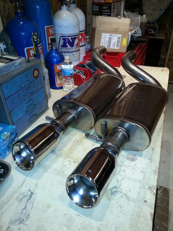

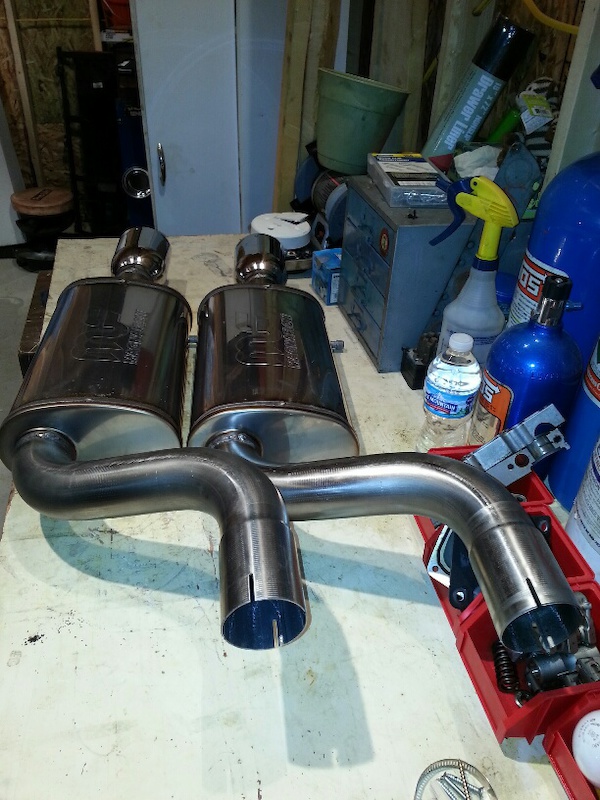

So, here is the thing about cheap exhaust. Long pause… Maybe quality control isn’t always the best. This magnaflow exhaust system came with an extra part. I’ll explain that in a second, but first, if you look at the top picture of the stock exhaust, you will see that the driver side muffler fell off. There is an incredibly small chance that magnaflow knew this as, the magnaflow system that we were sent, came with two driver side muffler sections. Not ideal for most cases, but a possible interesting solution for ours. Not really. Needless to say, that wasn’t going to work. The good thing is that, the magnaflow system came with resonators, they make it semi possible to drive until something gets figured out with the issue of having two driver side muffler sections. The frustrating part of this is, after spending all the time to fix the exhaust issue, the car actually left with even less mufflers that it came with.

Couldn’t believe that Magnaflow sent the wrong parts. If I were getting the job done locally, it wouldnt have been as big a deal. But seeing as this was all done in another country, and I have someone coming to buy the car next week, the mistake by Magnaflow really made things more complicated.

Just talked to Dan at Performance Peddler, and he is going to do his best to help resolve the whole thing. Anyway, we will see how things go.

The guys recommended against leaving one on, due to the unequal pressure that the engine would see on each side.

Just heard back from Dan at Performance Peddler. Looks like Magnaflow is going to get me the passenger side muffler to Canada this week. Mistakes happen, but that is some amazing customer service from both Dan at Performance Peddler and Magnaflow to sort the whole thing out. THANK YOU !!! Amazing customer service !!!

Dan at Perfromance Peddler is a miracle worker, and managed to get me the replacement muffler shipped to my doorstep in Canada within two business days of hearing of the problem. THANKS DAN !!!
Now, I am just awaiting one of the other ones. For some dumb reason I left them both in Detroit. Don’t ask why. It seemed to make sense at the time, but Performance Peddler resolved this issue much more efficiently than I expected.
