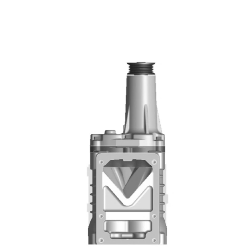

I am not sure if the IC coolers are bigger, you can look that up in the Mahle Catalog.
The Bypass stream is different on CREC, but most import is the part past the rotors. The airflow has a better path.
You can see that the upper housing is rounder.
To bad the are not swappable, mounting points seems to be different. I would just swap the V1 rotorpack into the V2 snout if the mounting was the same.

It would be interesting to validate if the upper chamber post rotor pack was indeed bigger volume wise as this would be part of your space after the rotors.
Rotorpack is the same size
I assume you’d want to swap the rotor pack due to no clutch?
The casting on my '13 S5 has the same Eaton casting as my wife’s '17 Q5. Now the internal machining may be improved. I know earlier around 2010-2011 Audi did change the Intercoolers. Lobe size is all the same but I’m sure if Eaton made a small improvement to the flow they probably wouldn’t have bothered changing the designation from R-1320 unless it was a large improvement. Since 2011 the changed intercoolers have went through 4 suffix changes, E, F, R, lastest is S. Prior to 2011 they were a B or D version.
