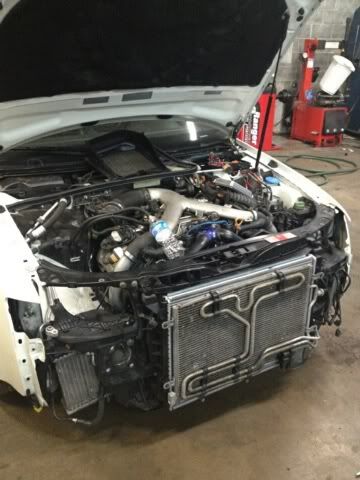

Clint’s 2.7t swap
It’s alive
FT’s and full stage 3 fueling should be in the near future.

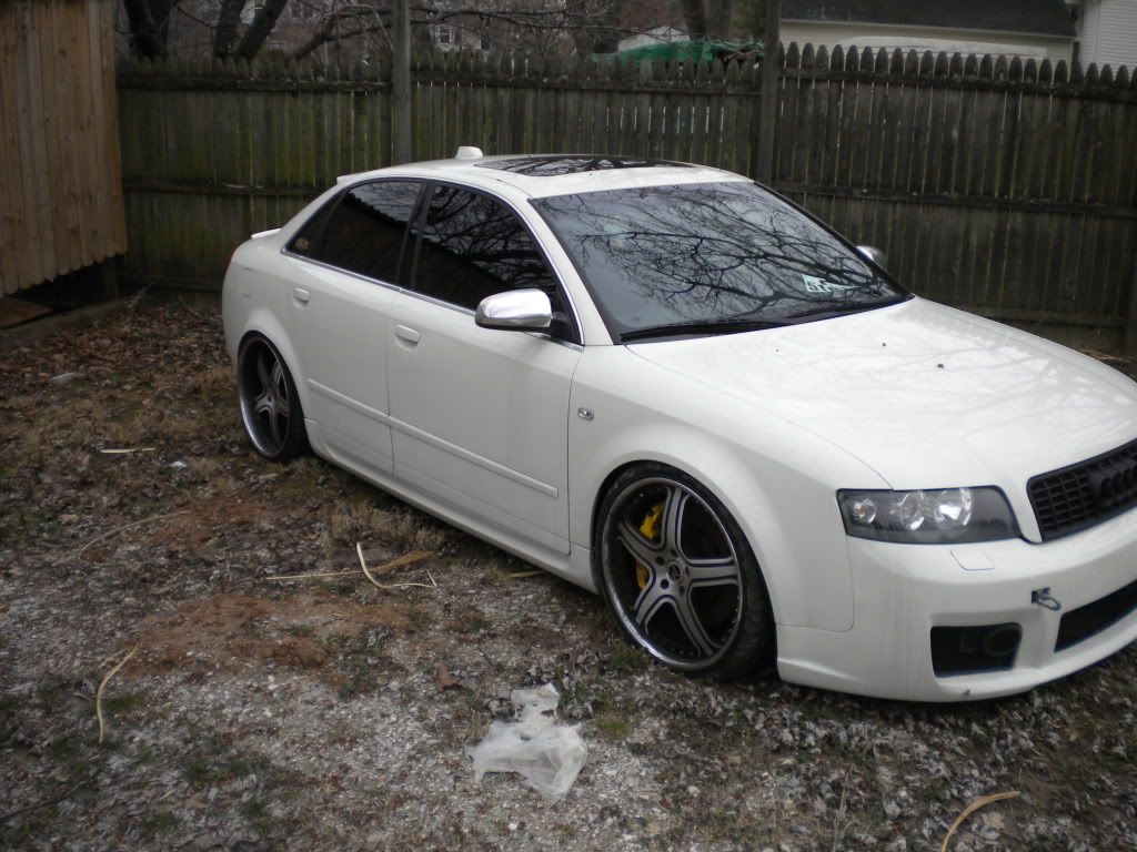

wow, is that bagged? looks good, does it run as good? What all of the creature comforts had to be forgone?
no bags iirc, just spun down coils and big wheels… I think he sold a lot of the aftermarket stuff.
cool so it’s a 255 hp B6 S4 now?
WAY TO GO CLINT!
Who is going to tune the FT setup?
Lol.
jfonz is gonna have a go with tuning it.
He still has to wire in the cruise control, otherwise nothing has been given up.
