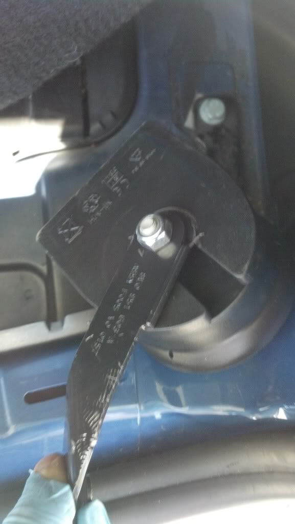

Replaced my Auxilary Alarm Module (siren), turned out the new replacement ones do not fit the bracket that is used on the factory so I had to drill out the hole in the bracket slightly but other than that it was a pretty easy install. Now the signal is stronger all around the car from a slightly further distance than before but still its not as good as it could be so I suspect that when i get the B7 keys programed for the locks they will help to add more distance.
Edit- Would also like to add that you must reuse the bracket unless you want to be ghetto and have the module sitting loosely behind the trunk side panel which would be lame and likely cause it to break bouncing around. The panel will not close if you just bolt the module to the hole without the bracket, the bracket allows the module to seat lower than the side panel allowing it to close properly.
Auxilary Alarm Module (siren)- 8L0 951 605A
As you can see the back of the old module has a lip and the bolt size is smaller than the new module.
http://i1190.photobucket.com/albums/z457/A4QuattroV6/IMG_20130409_160402_132_zps8f124aff.jpg
So I just drilled the hole out a little till it slid over nice and snug on the new module, bought a nut from hardware store, I don’t recall the size but its not hard to find.
http://i1190.photobucket.com/albums/z457/A4QuattroV6/IMG_20130409_143652_011_zpsde47ac4e.jpg
