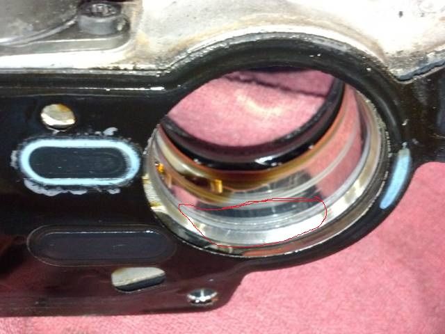

The original Cams from the factory come with locking camshaft rings I circled in red in the picture below, In the top circle you can see the rings where the lock is broken…
http://i1190.photobucket.com/albums/z457/A4QuattroV6/8.jpg
this caused my cam shaft adjuster to have scouring marks on it as you can see in another picture below I circled the damage…
http://i1190.photobucket.com/albums/z457/A4QuattroV6/18.jpg
I think but I am not sure and don’t remember exactly per my discussion with the Audi Tech that this is what ultimately caused lifter and camshaft damage.
