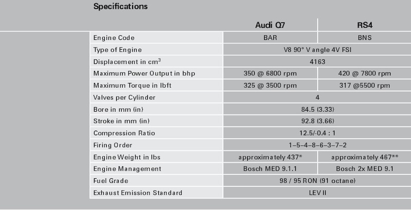

The stats show the RS4 at 420@7800. But the graph shows it at about 400hp at 7800. Which one is telling the truth ???
I think I’ve read that the R8 has more then the RS4 I’d say 400 is correct. Did you see the weight differences? 30lbs more to the RS4. I’d love to know what makes up the 30lbs. You’d have to believe that those weight differences accounts for needed performance beefing up. You’d also have to think that the changes to the RS4 over the Q7 would be similar to what the Lamborghini and S6 motor beefing would be no?
Sorry, I skipped the footnote regarding the weight difference
* with automatic transmission
** manual transmission including clutch and dual-mass flywheel
There goes that theory
