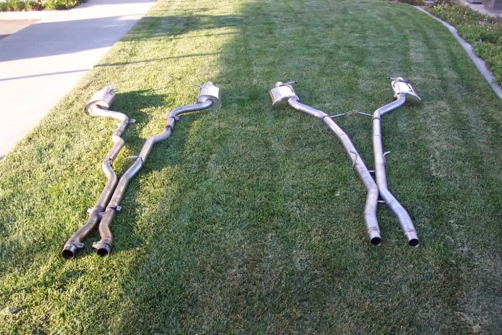

Its all about 57mm/2.25in. and bends arent sharp at all.
Not stock, you could put the stock pipe inside this.
It cost me $1100. to the door total.

well no bends look sharp from that angle. Let’s get a better look.
Now lets compare to a fast intentions. THink the Milltek bends are smoothe now?
Milltek A4 3.0 (2.25)
http://www.avalonmotorsports.com/images/Milltek_B6_a4_exhaust%20entire_Milltek_B6_a4_3.0_exhaust.jpg
Here’s the Milltek B6 S4 exhaust…basically identical design to the B6 A4 exhaust other than diameter.
Milltek B6 S4 )2.25) on the left, Fast Intentions B6 S4 on the right (2.50")

Does anyone know what kind (brand?) of mufflers fast intentions is using on the B6 S4 setup?
sebring
sebring? that’s a guess.
man that FI exhaust looks so good.

How old are your Milltek photos?
The bends in mine are not as sharp as the ones in your PICS Sakimano.
Maybe they made some changes to the ones I have?
I didn’t have a chance to take PICS before they went on.
I’ll try and take some PICS and video the next time the cars on the lift.
lol they`re from the links you provided!
the one of the S4 exhaust is a couple of years old.
I see.
The Milltek PIC is about 4-5 years old. Maybe less.
How old are the PICS of the ones in the grass?
