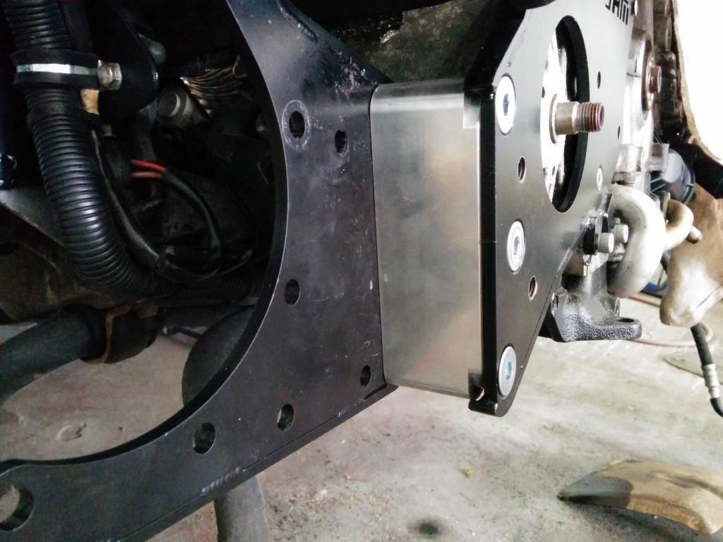

with the clearance for the back of the supercharger sorted the brackets could go on and be torqued up.

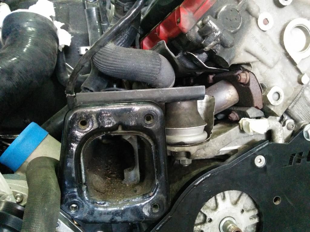

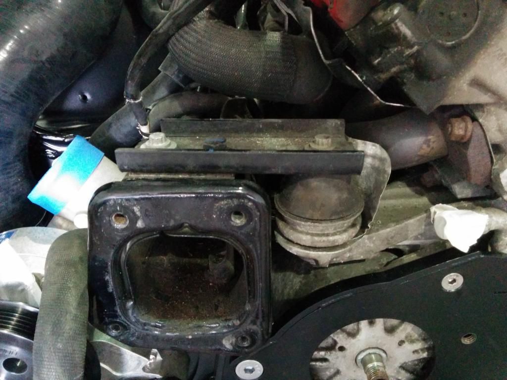

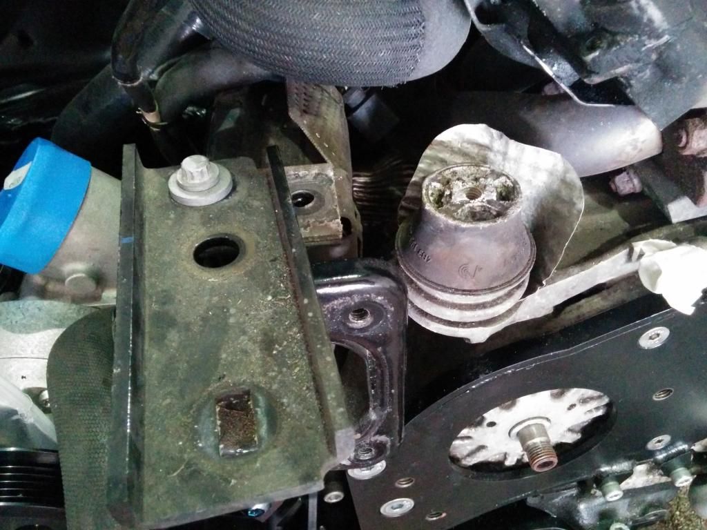

next up i fitted a new 034 motorsport torque mount, my original one is starting to split.
old torque mount, you can just make out the split.
http://i1367.photobucket.com/albums/r794/sarrs4/jhm%20supercharger/IMG_20140807_132140_zps3414e85c.jpg
piece of cake to fit! as long as you have your front end stripped off that is.
http://i1367.photobucket.com/albums/r794/sarrs4/jhm%20supercharger/IMG_20140807_132823_zpsc98b3540.jpg
all done.

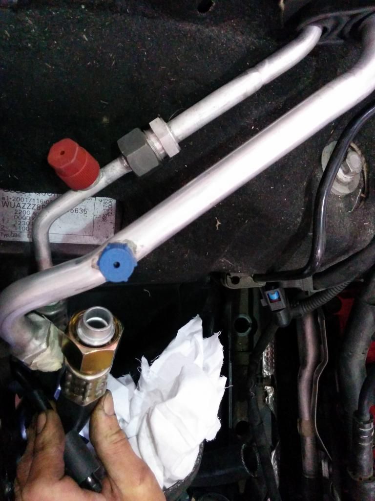

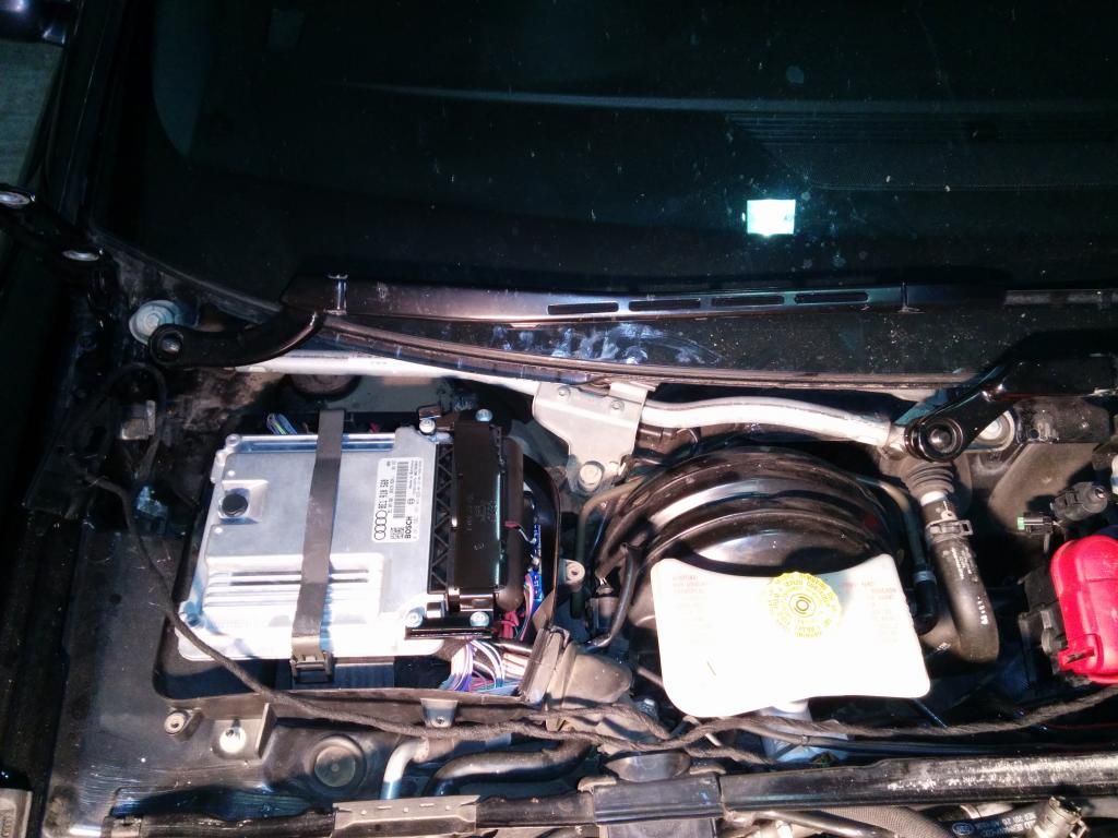

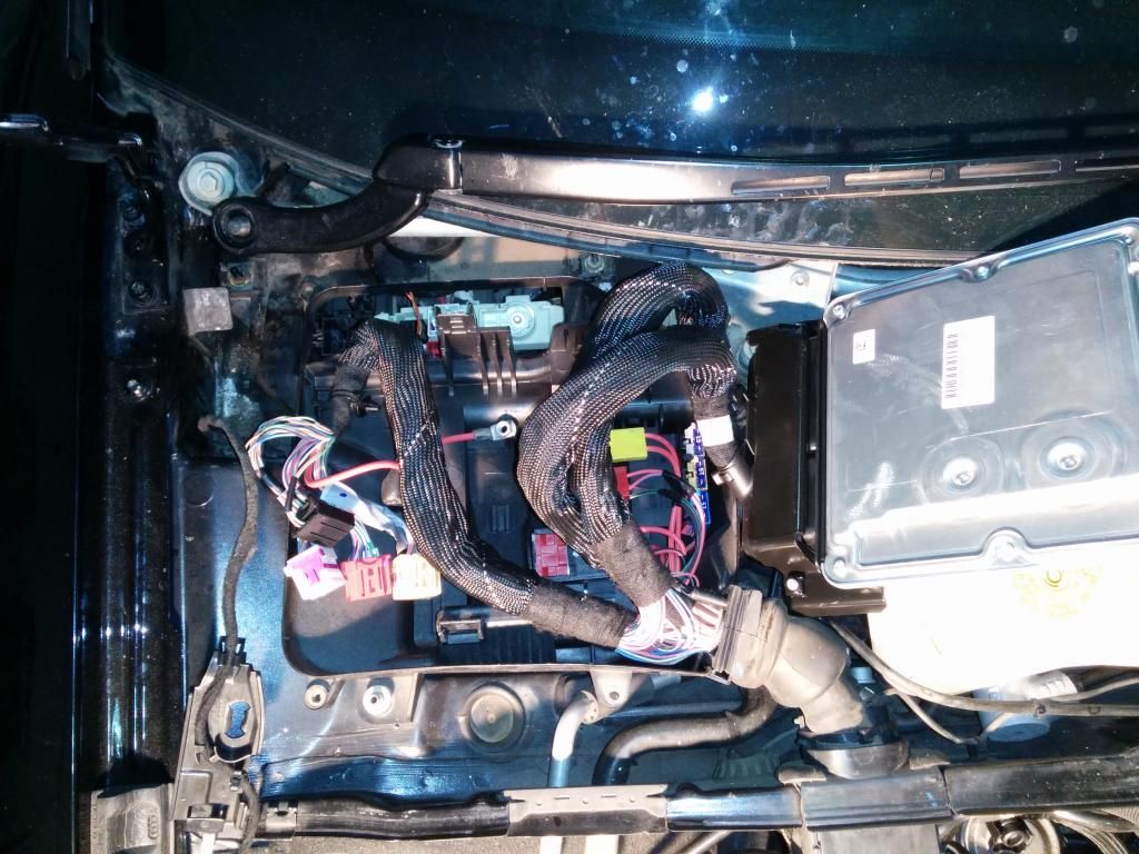

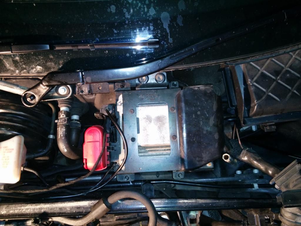

on a l/h/d usa car both ac lines connect just behind the oem airbox which makes the job a piece of cake. on a r/h/d uk car one line has a connector just near the airbox but the other one (blue one in the bulkhead in first pic) is solid so must be undone from the opposite side, this is a bit more work as you have to remove both ecu’s and mounting hardware unplug a few pipes and remove the master cylinder and servo as the pipe runs underneath everything in that section.
it might have been possible just to remove the master cylinder and leave the servo in place to remove the pipe but i didnt want to have to rag on anything so i stripped it all out. i really wish i had tried to leave the servo in place as trying to get the ball on the end of the rod out the back of the servo where it clips into the pedal assembly was a right ball ache, i had the proper audi tool to unclip it but it just wouldnt budge. had to smash it out in the end (not easy) and to top it off the nylon clip which the rod clips into which you can buy separate for nearly every other audi comes as one part of the pedal assembly on a rs4, so instead of £4 for a new clip it was £29 for a piece of metal box section and a clip.
stripping out the ecus, servo ect. my wiper arms were seized solid i had to remove them still attached to the mechanism and give them three days of penetrating fluid before i could persuade them off!.

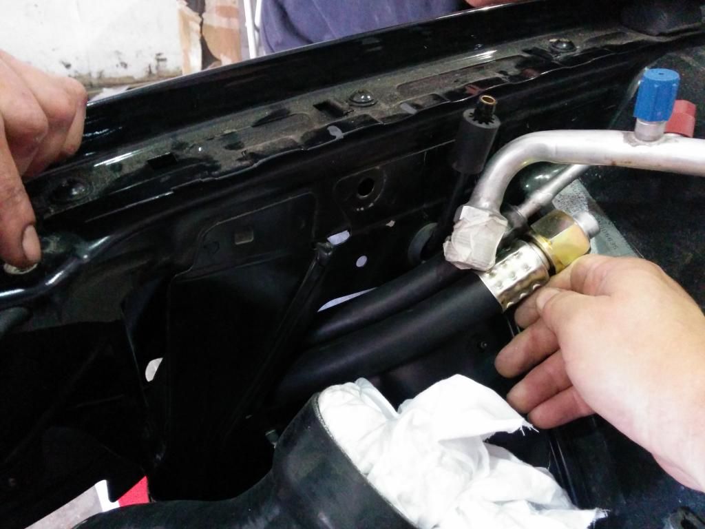

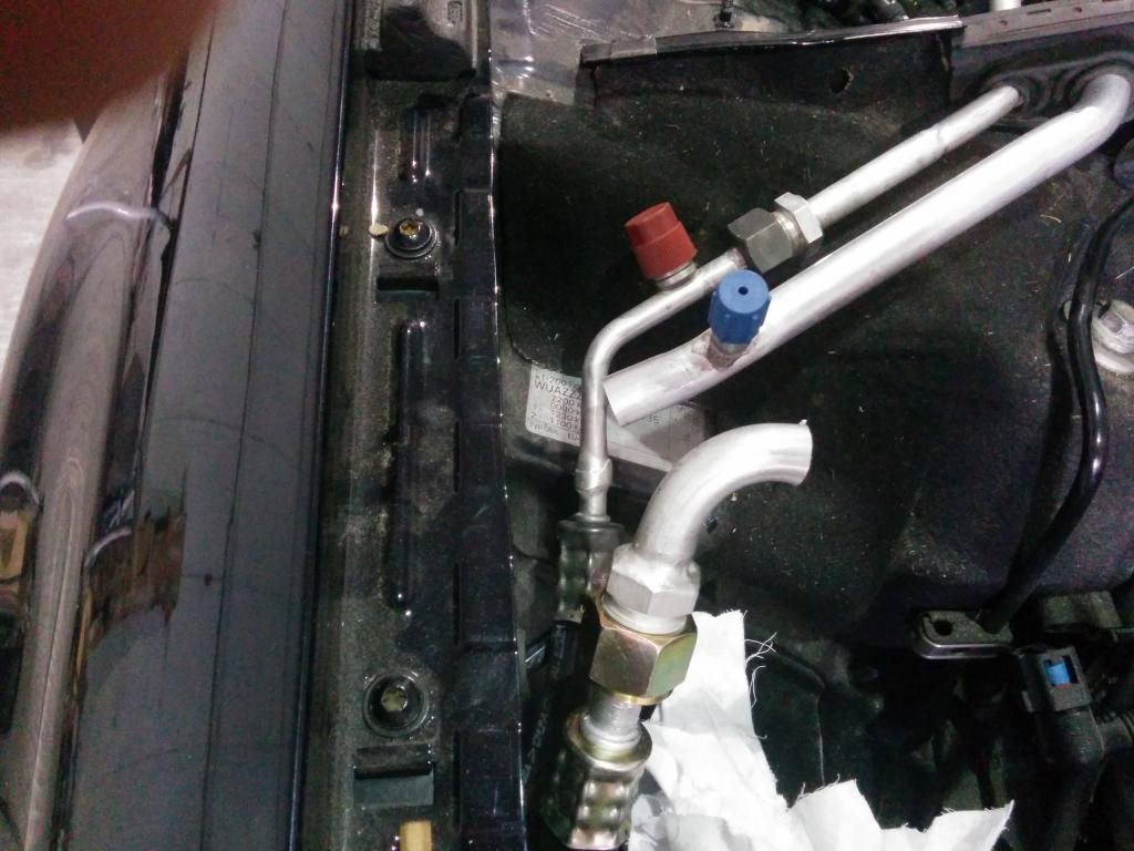

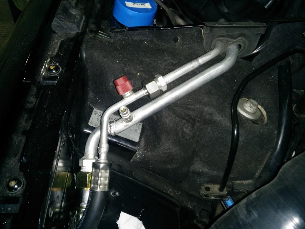

with that stripped we could run the new ac lines,the smaller red line fitted no probs but the larger blue lines thread was cocked off at the wrong angle so needed a bit of a tweak.
she’s not gona go captain!
http://i1367.photobucket.com/albums/r794/sarrs4/jhm%20supercharger/IMG_20140807_135424_zps1ea70f04.jpg
http://i1367.photobucket.com/albums/r794/sarrs4/jhm%20supercharger/IMG_20140807_135530_zps300dc9c3.jpg

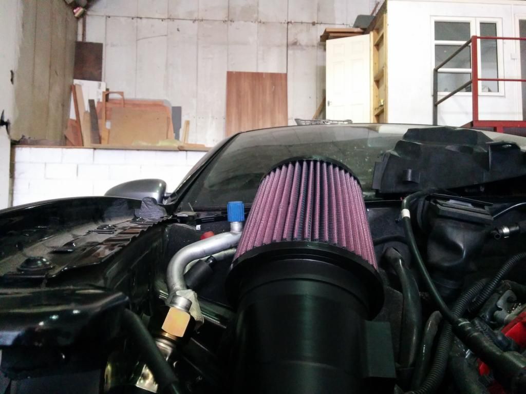

it was also tight with the air filter. on a l/h/d usa car the blue ac pipe loops round the other side of the air filter because it has to head back over to behind the wing where they relocate the dryer filter, on a r/h/d uk car the pipe has to head off in the opposite direction so you cant have this loop. having the loop also allows the air filter to sit lower touching the red pipe.
http://i1367.photobucket.com/albums/r794/sarrs4/jhm%20supercharger/IMG_20140807_141124_zps7f01afec.jpg
so i modified it as follows. i cut off threaded end and attached the pipe, i reworked and marked up the new angle and length, then had the pipe ali welded up.
i crossed the pipes over as this gave the best fit overall fit and allowed the pipes to pass through the hole in the inner wing. this also gave the air filter enough room to fit nice.
