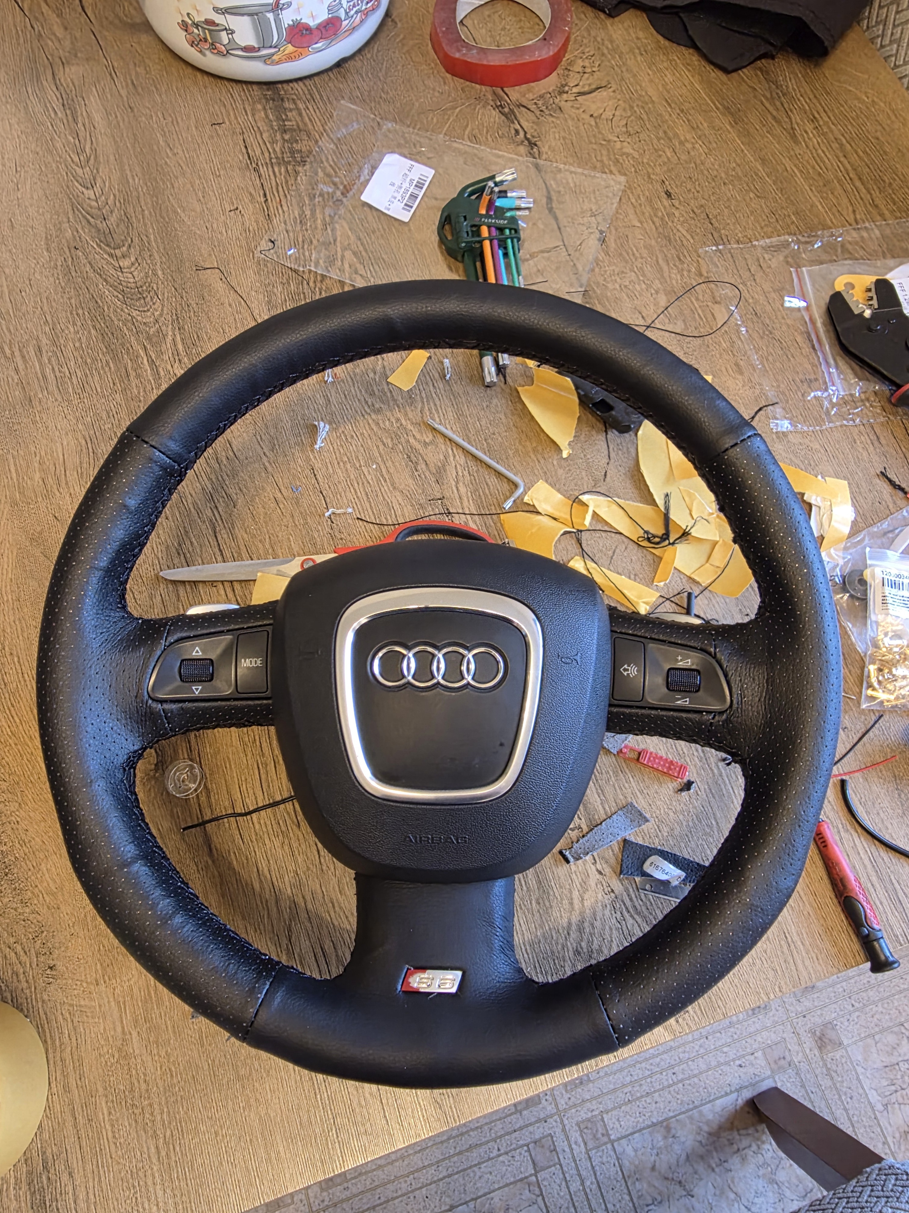

Heated steeringwheel:

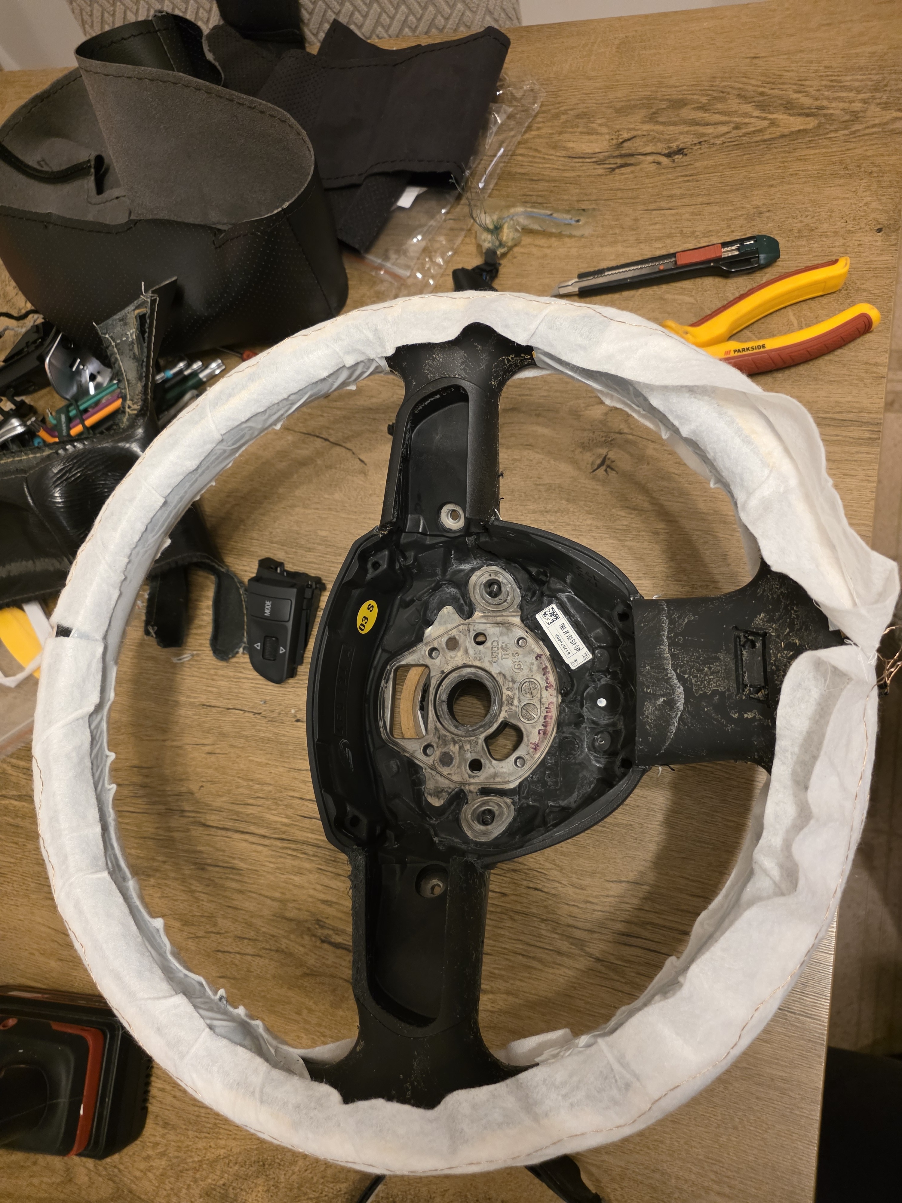

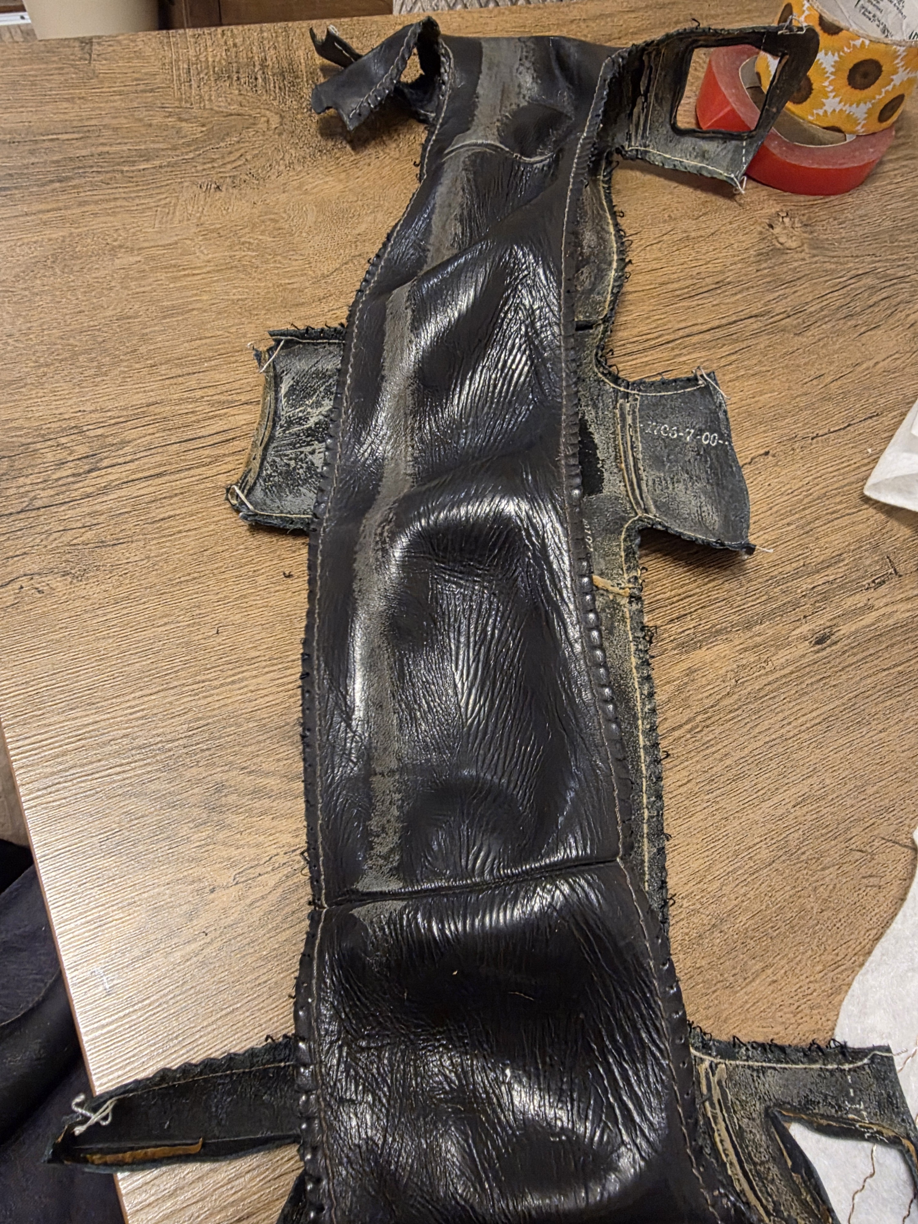

Removing leather
20251125_200212

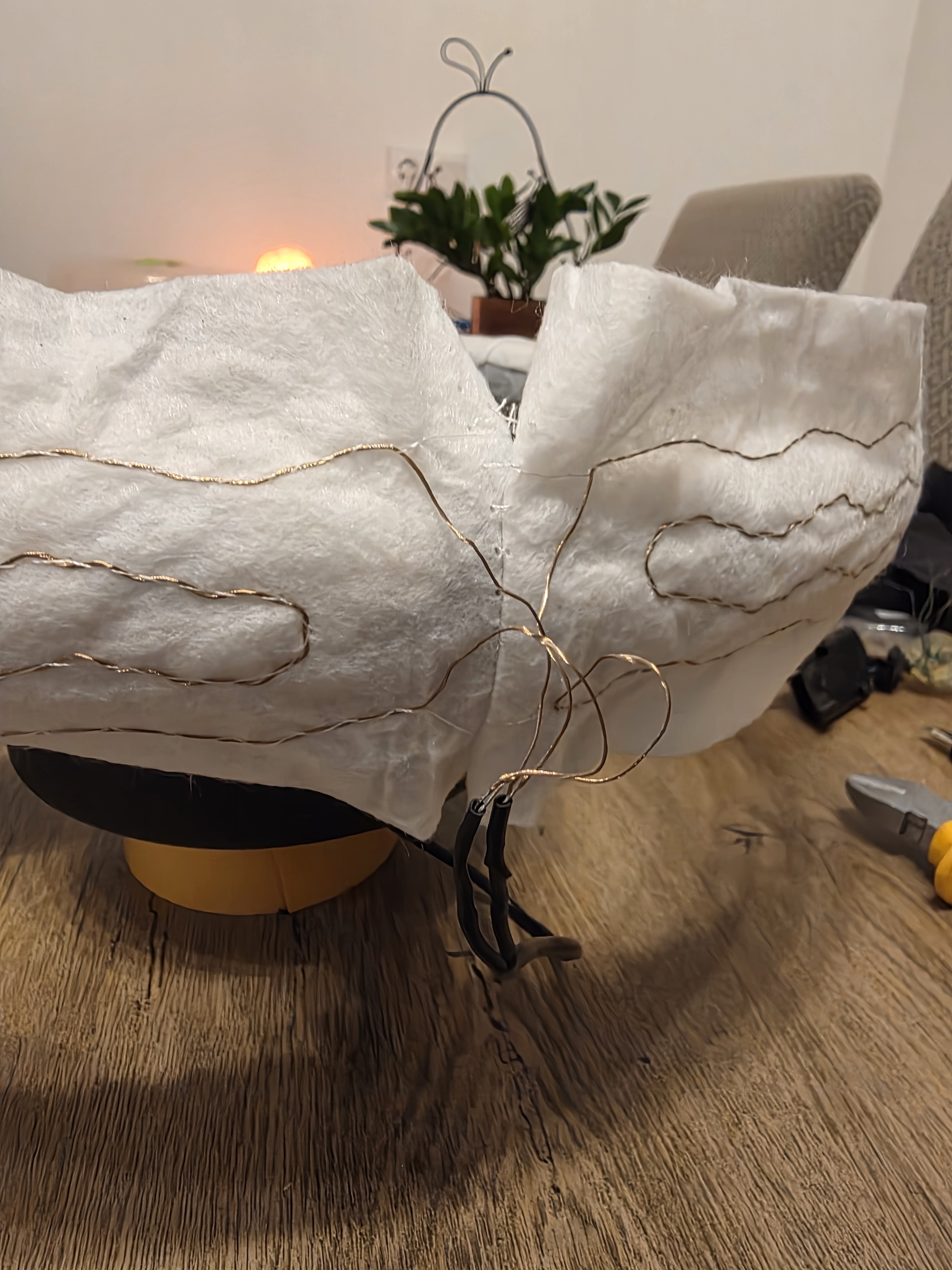

Installed universal heating element from ebay, I didnt manage to find some better, maybe if there is available wire would be better
20251125_203001
20251125_203010

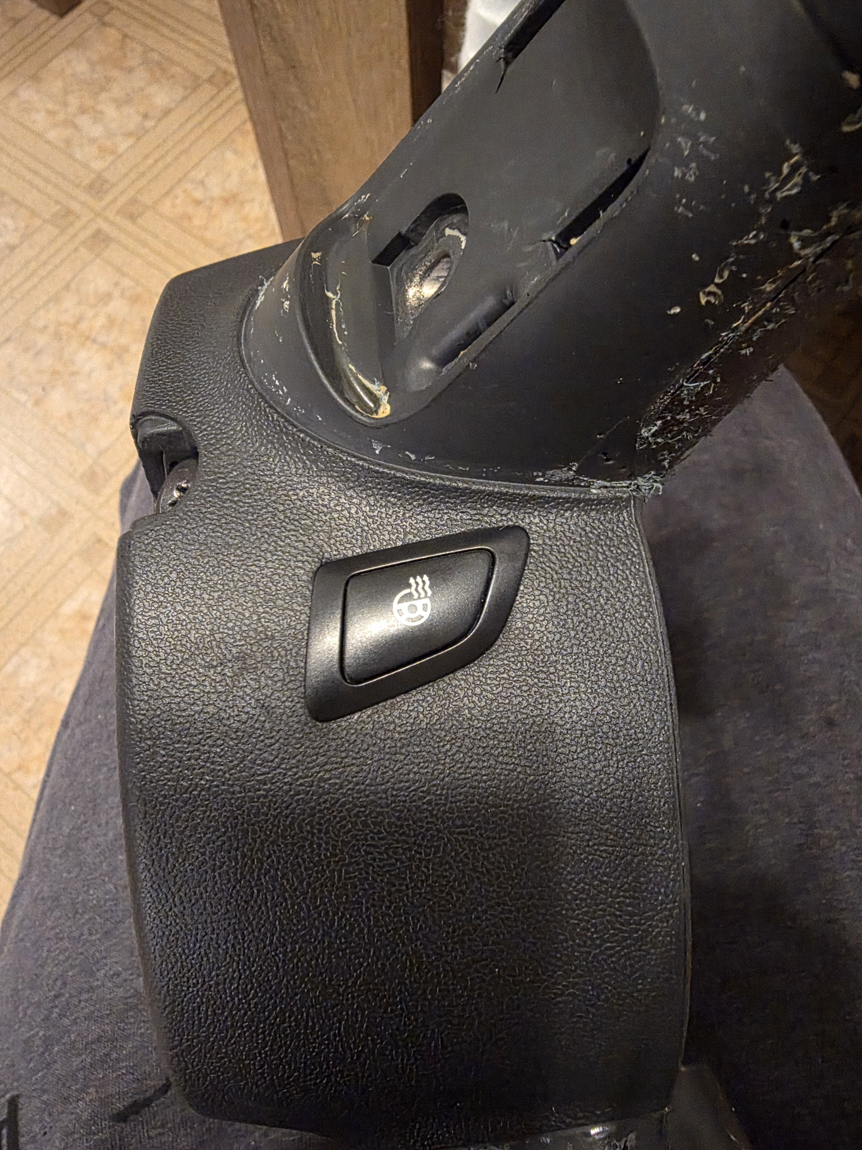

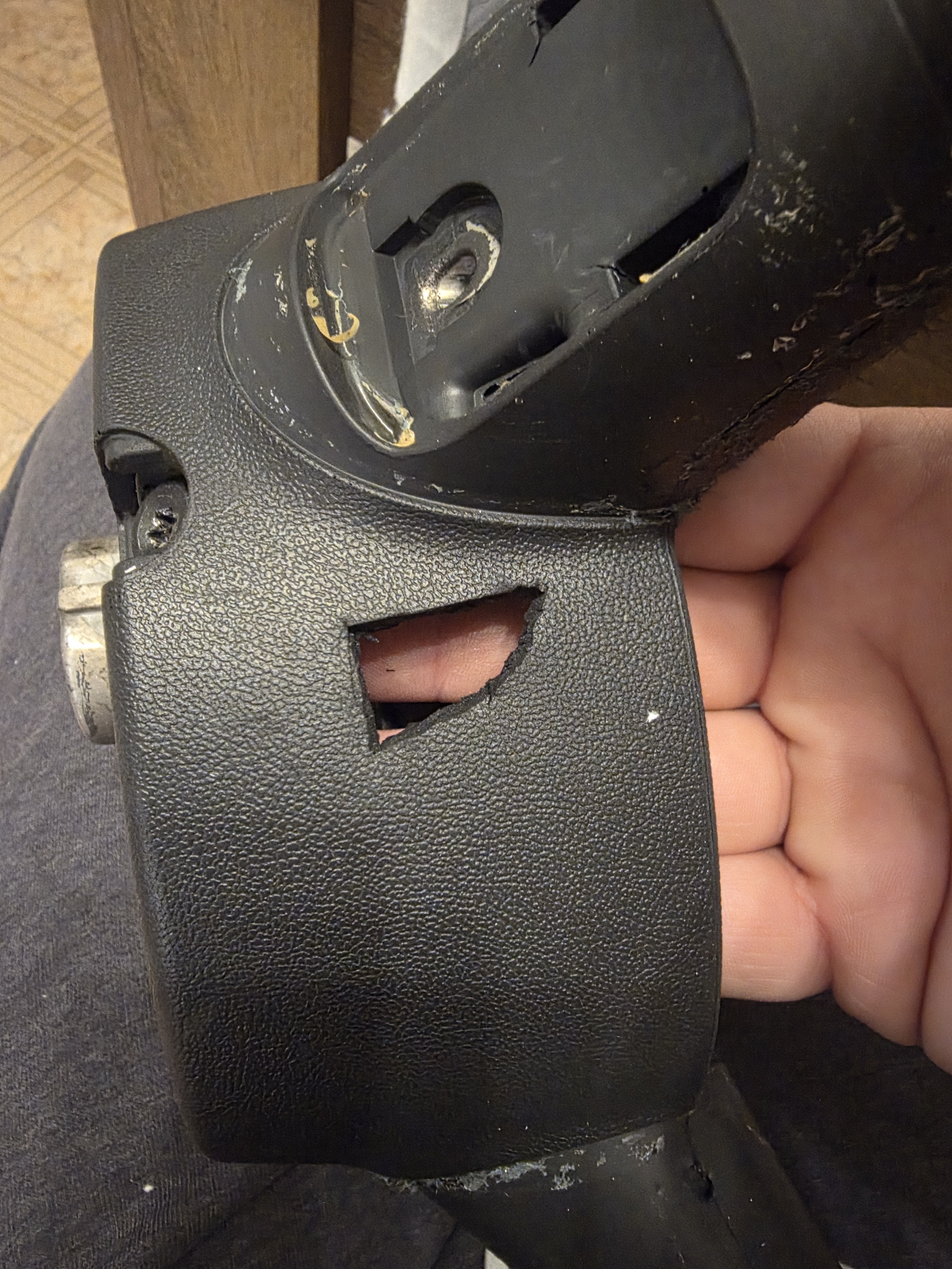

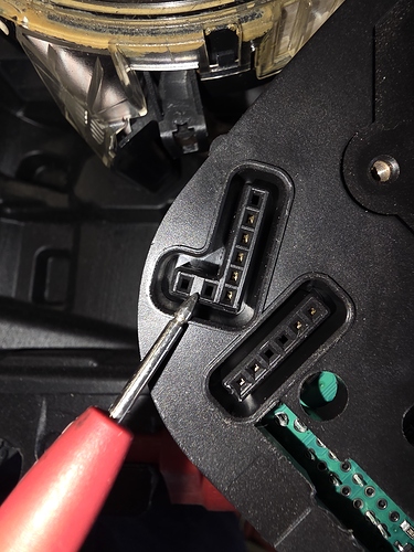

I get q7 4l steeringwheel with heater, but those wires are not good for swap. But electric parts are good, so modify side to fit button
20251125_210037
20251125_210505
Drilled bottom of steeringwheel for wires and temp sensor

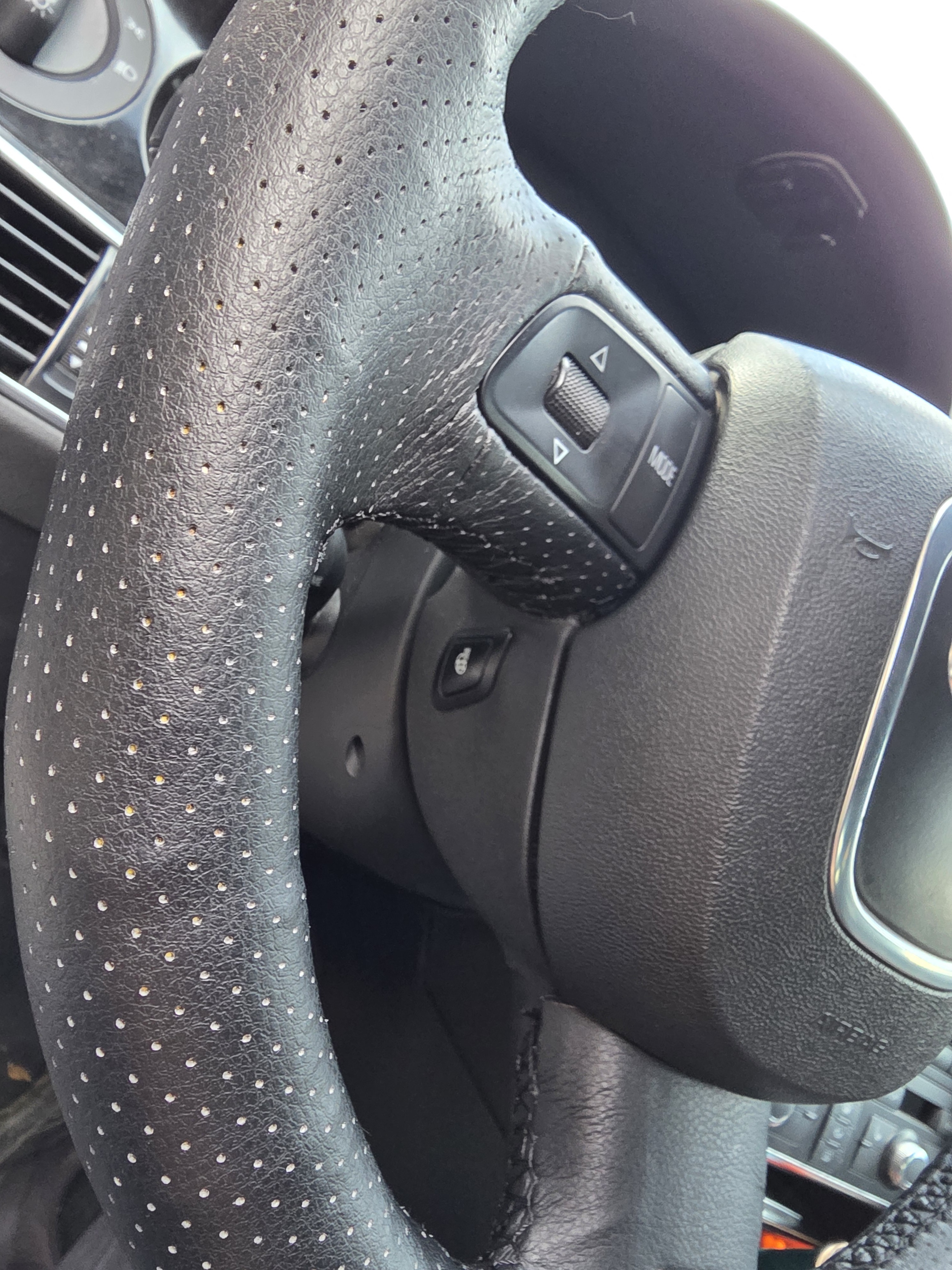

From AliExpress by mistake ordered cover for basic steeringwheel without buttons, its slightly diferent lenght where are buttons,shorter on both side. And needed to cut holes for shifters, front buttons and logo.
It’s not perfect fit and looks, but it have nice grip and its slightly thicker than oem, and its comfortable. At some another time will replace cover with proper one
Front buttons i keep from my car, it works as it have on left unit extra 2pin connector
20251126_110504

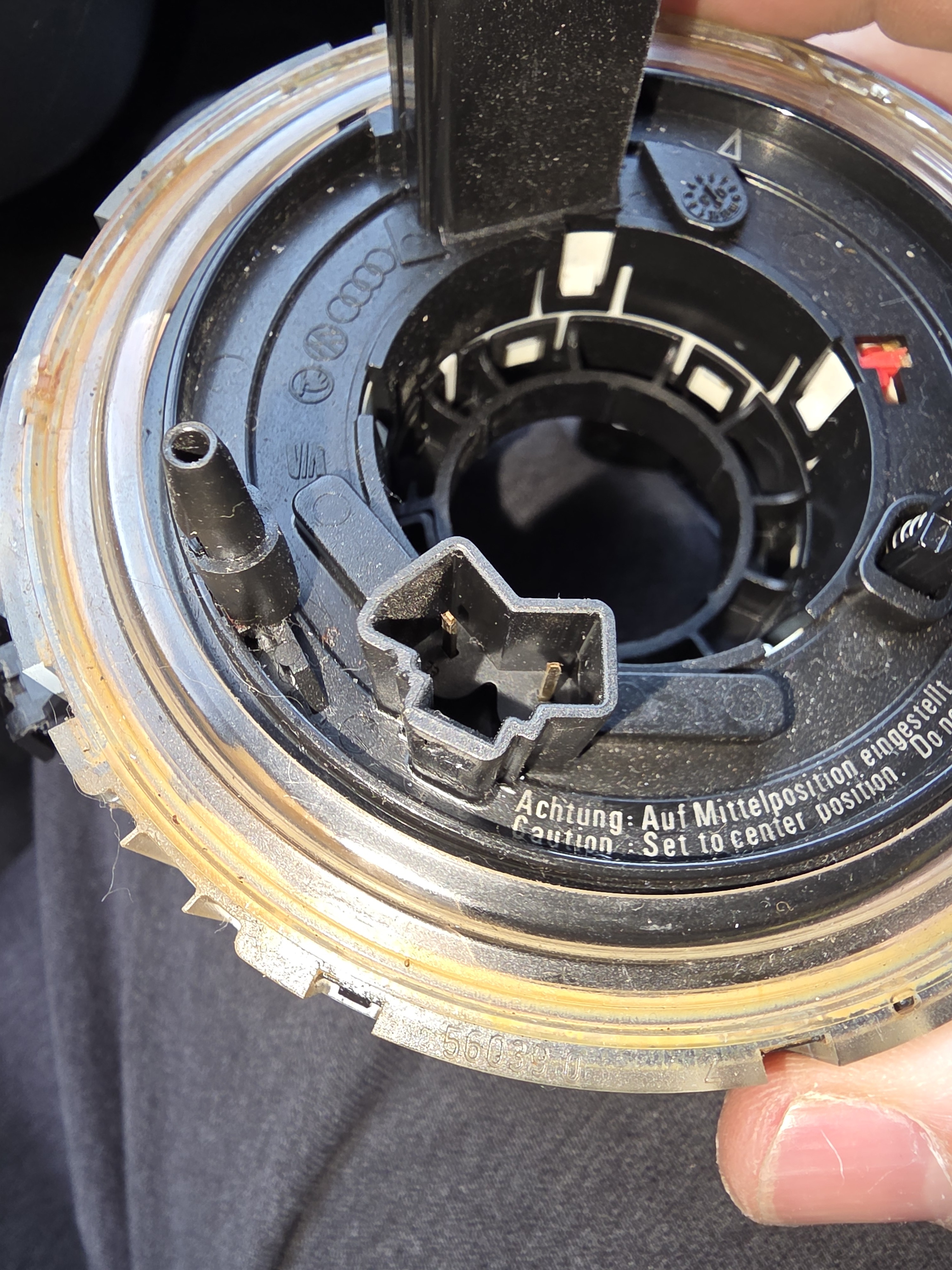

My car dont have pins so that part is replaced with one that have heating pins
20251126_112306
For heating
20251126_112323
20251126_112338
this unit i keep as its ready for heating where is going wheel spring unit

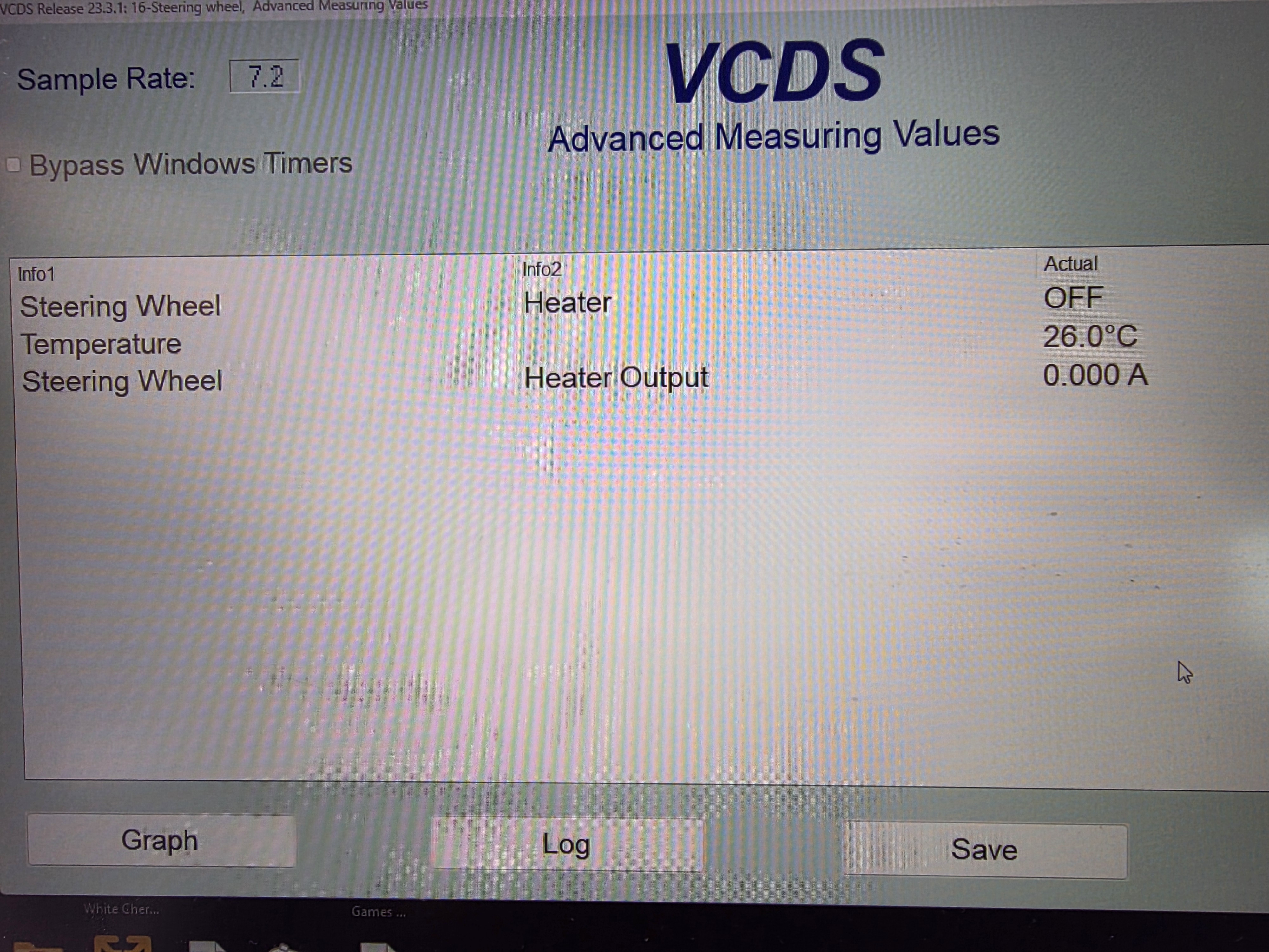

Coding
20251126_123939
It’s keeping temp from 25 to 27°C

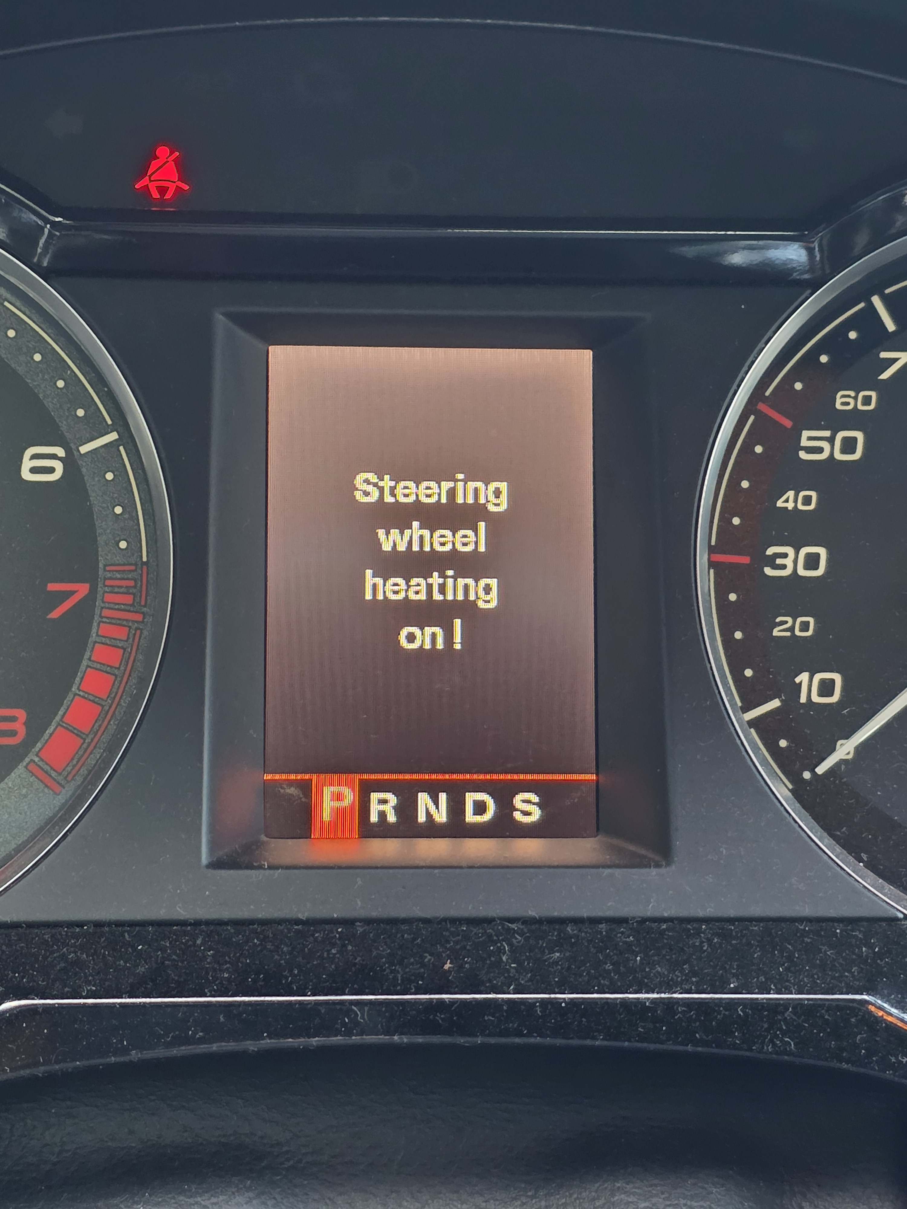

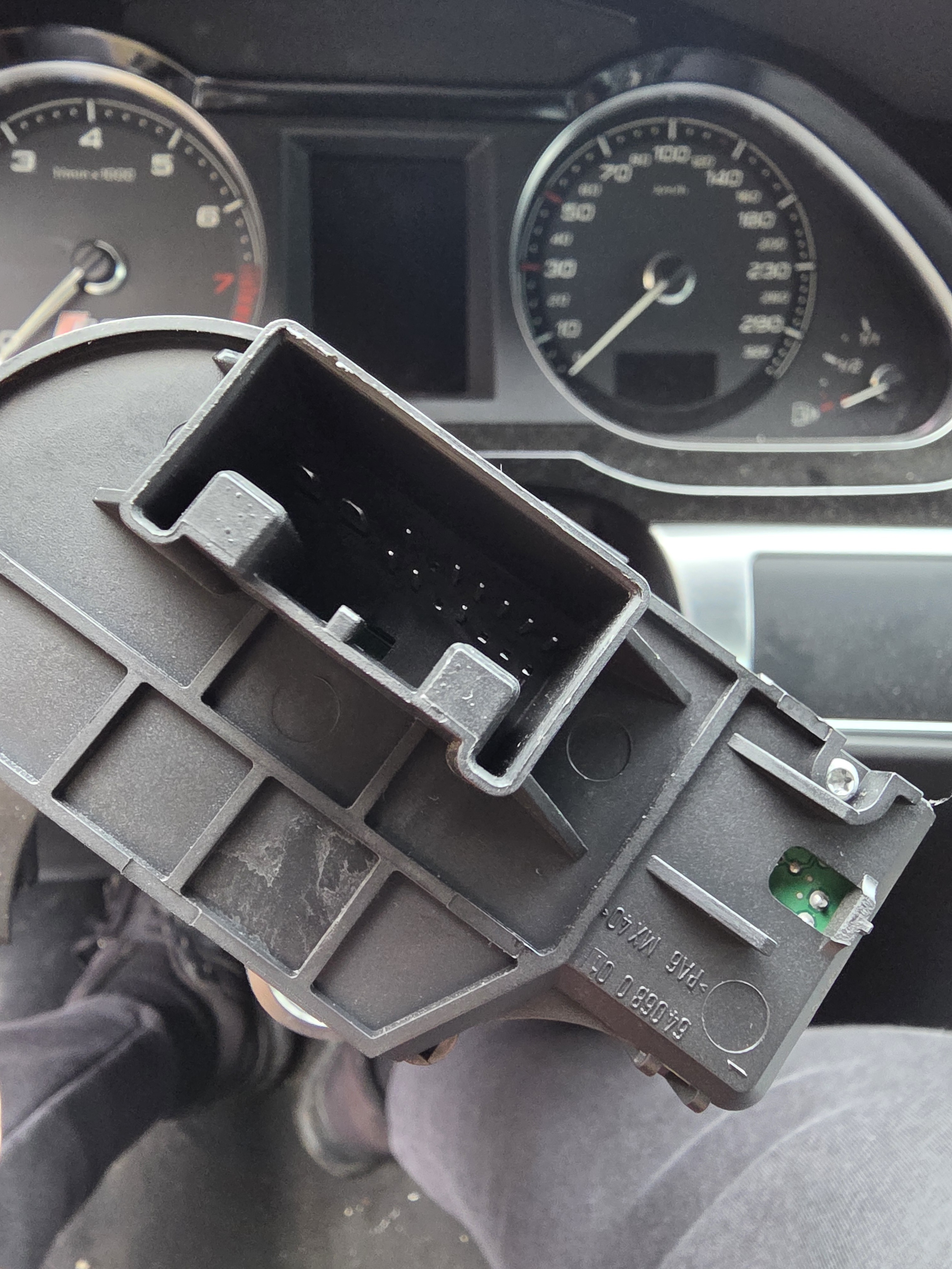

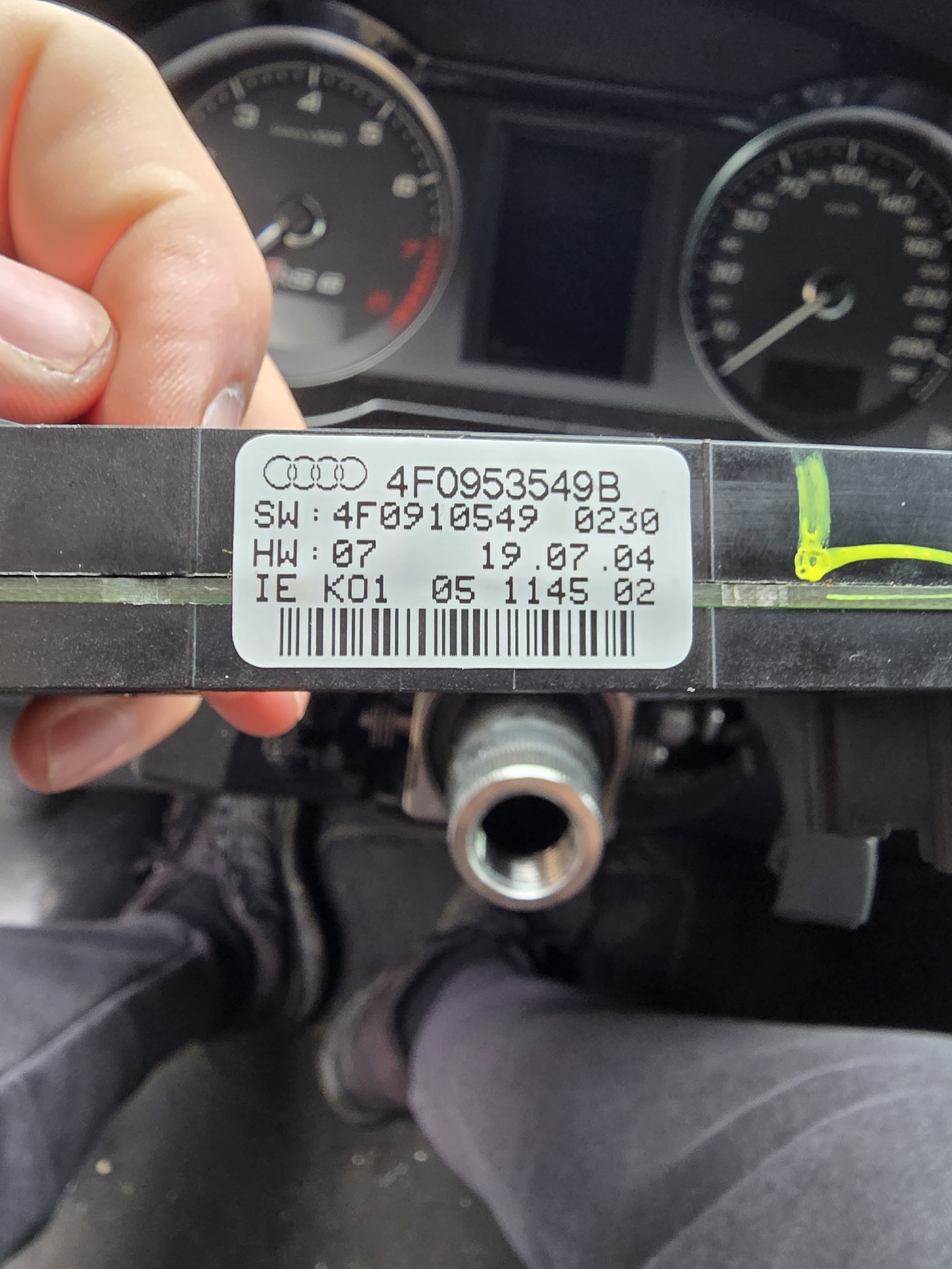

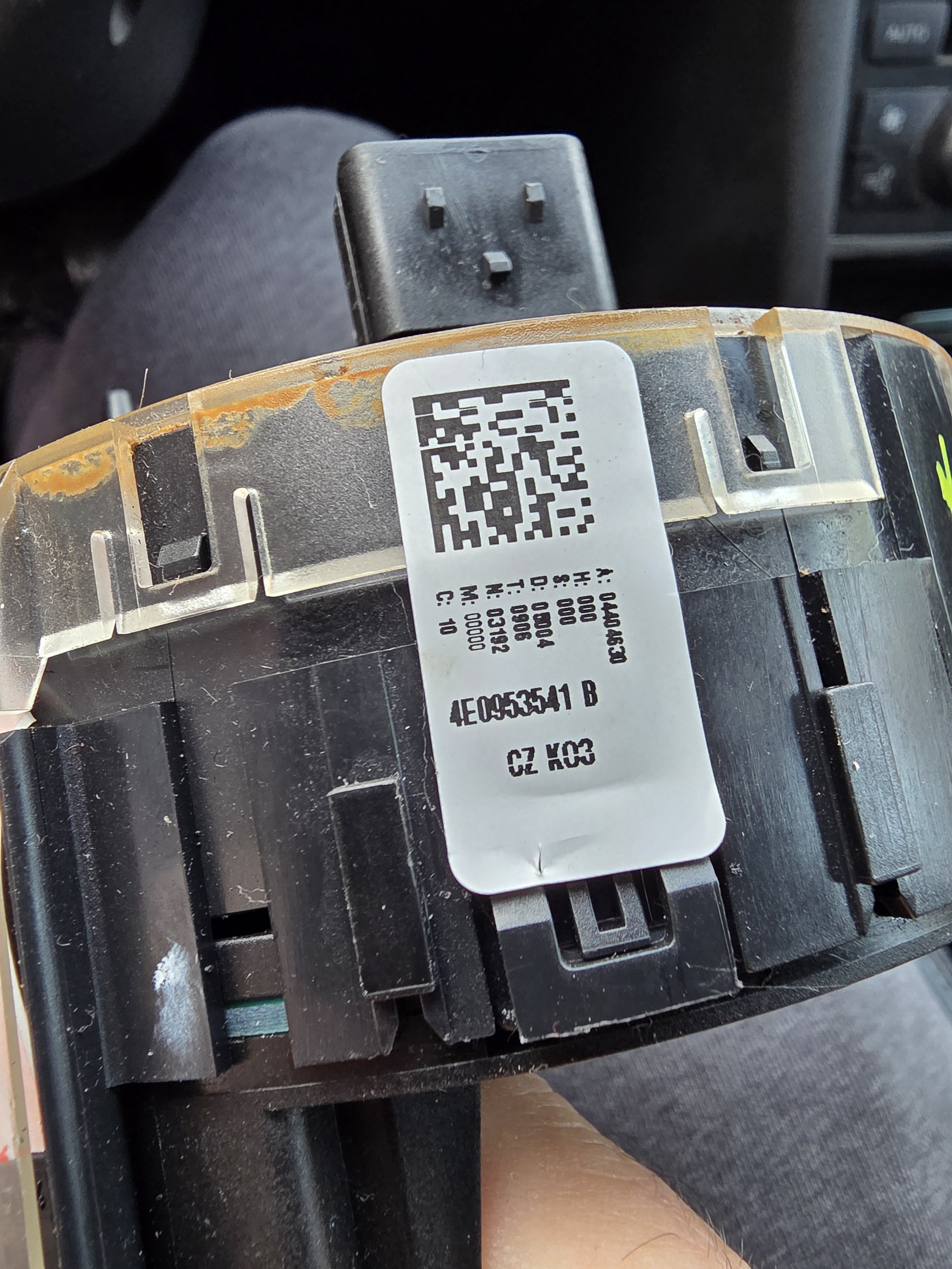

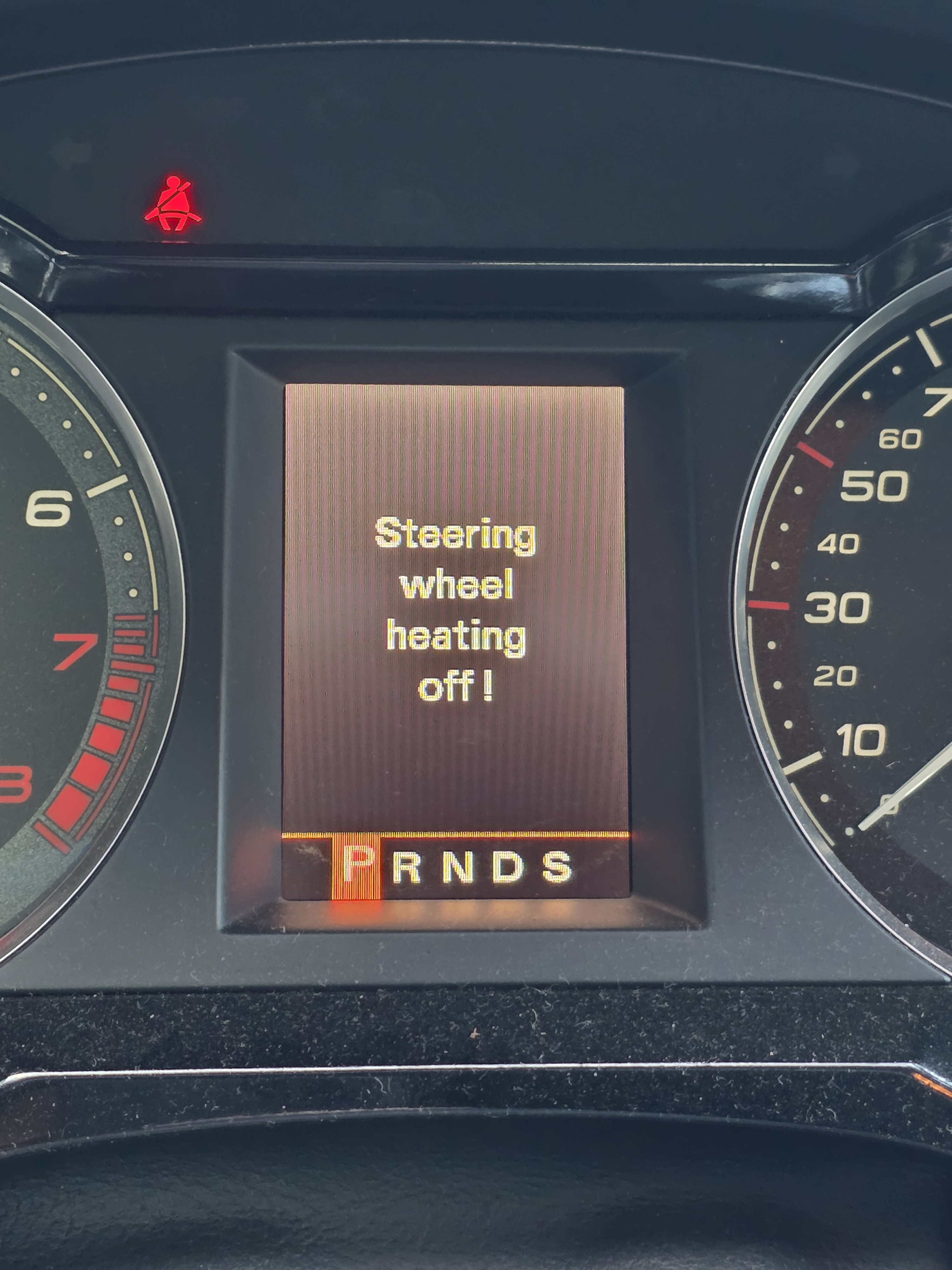

It works great, only I dont get notification on dash when its on or off. Its automatically ON when car is started. Will try to replace front buttons with one from Q7 and back unit with newest and diferent last part number letter
Super fun upgrade. Good to see the kind of work needed to get this to work.

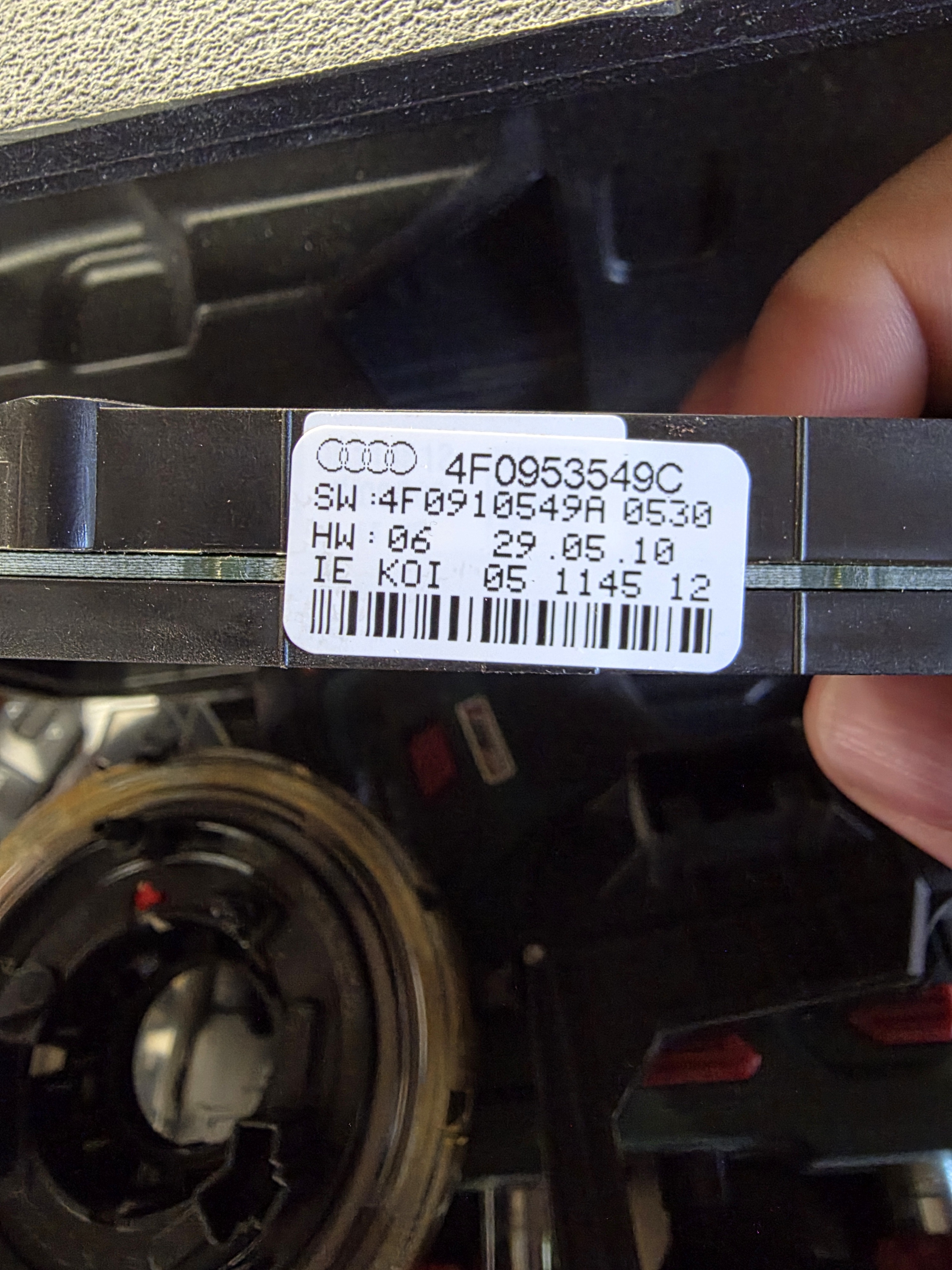

Replaced steeringwheel module with version C, my one was B, and now it show on display when steeringwheel switch is pressed
20251128_084624
20251128_090229
20251128_090232
Also I have wersion D, but that one doesn’t have pins for heating17643172370434605568600238062275
