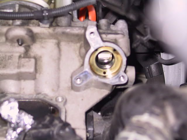

Can you guys help me understand how a failing fuel pump puts fuel in the oil? Is it pushing too much fuel and washing the cylinders? Seriously asking here. ???
Saki- I honestly feel like I dodged a bullet here
Blackhawk, I asked the same question, apparently the seal leaks/fails, I was told it is mounted on the block, someone with more tech might be able to help fill us in, I have been looking a pics of the 3.0T and can’t seem to figure it out myself
HPFP run off of the cam, right? So if a seal goes bad or something fuel leaks right into the head.
Example of 3.2FSI
http://i249.photobucket.com/albums/gg201/dslboomer/Audi%2006%20A6%20QT%2032FSI/IMG_3999.jpg
Much thanks, that clears things up a lot
No problem, don’t treat it as gospel, but that is my assumption.
Again, these aren’t 3.0TFSI pics, but help with a more visual explanation. EYEspI you should sake them if the bore of the HPFP wore out and caused a leak or what actually failed. It would be good to know to educate members that may have a similar issue in the future.

I don’t know if these will help.
http://audirevolution.net/addons/albums/images/526110148.jpg
http://audirevolution.net/addons/albums/images/288578191.jpg
^I love the fact that you just have pics like that already!
Thanks guys, all very helpful info.
