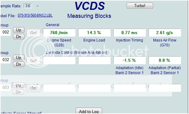

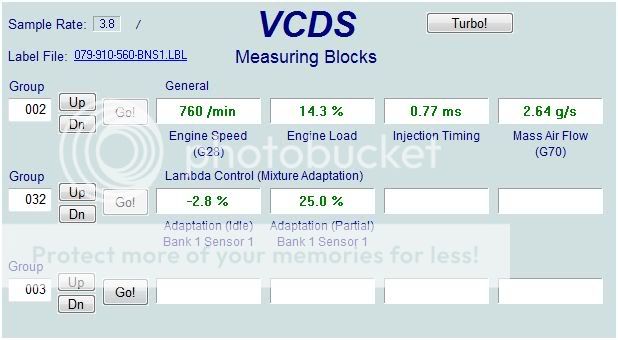

So I chickened out about half way through the test for two reasons. The first being the idle was very erratic as expected and at stop signs or traffic lights I’d be just short of stalling. The second and main reason is it triggered a flashing CEL. Which did go away after I’d start driving again. Came back a second time at a traffic light, then went away again. What I do want to mention is during the short test (roughly 3-4 miles) I actually didn’t notice any smoke. Now, I don’t know if it solved the issue (meaning, it’s pointing to a faulty PCV component), I tried my best to look for the smoke but it was night time so I can’t be 100% positive. I may try this again during day light hours so I can be sure. My concern is this procedure triggers a shit ton of fault codes. I have a list and will post them in the next post - it is a long list.
I checked the long term fuel trim codes immediately after the test. See results below:
http://i834.photobucket.com/albums/zz269/NY07RS4/2007%20Audi%20RS4/bank2.jpg
http://i834.photobucket.com/albums/zz269/NY07RS4/2007%20Audi%20RS4/bank1.jpg
Kind of crazy results for Bank 1. Again, this was after the test which triggered faults etc.

http://i834.photobucket.com/albums/zz269/NY07RS4/RS4PCVFineOilSeparatorimage.jpg
Potential failed PCV parts: Non return valve & Crankcase breather system
Theory - after discussing this with two other techs (Indy shop near my house) they are both adament it sounds like the culprit has to the PCV system. The issue always arises when there is a change in vacuum (postive for a while then negative for 30 seconds or more and the minute it goes back to positive the oil dumps). I’m wondering if one of the two parts listed above, in particular the non return valve, is not functioning correctly, would it cause the issue I’m experiencing.
Anyone have access to ETKA or similar where I can see an exploded view? Or better yet, anyone have an acutal shot of the back of an RS4 motor with these parts installed? The diagram above helps but it is on the back of a Q7 4.2 FSI comfort motor. I really want to see the exact path and layout of all of the PCV system’s parts relative to my motor. It may be an exact match, I just don’t for for sure.
I can swap these two remaining parts with new ones myself to further test my theory. This is what I’d like to do prior to dropping off my car at a new dealership and having them attempt to diagnose it.
