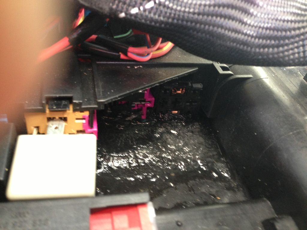

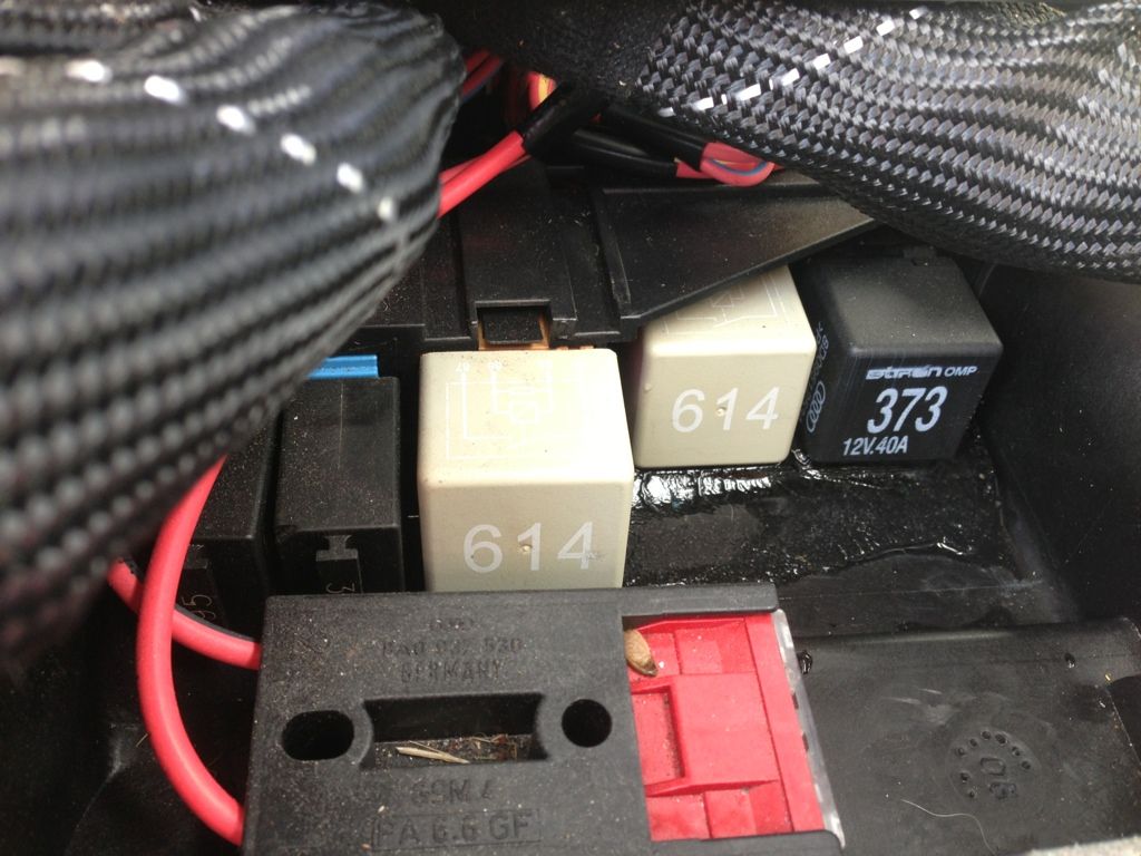

I just love shoddy workmanship. Whoever last closed up my ecm box decided that the two screws in the back were just too hard to reach. God forbid they actually have to pull the windshield wipers off again. So, my son and I were out throwing the football in the front yard the other day, and all of a sudden he asked, “Dad is your car about to take off?”. I walked over and sure enough the radiator fan was blowing just as hard as it could. Pulled the fuse, and then opened the box and found this:
(yes, that is an almost 1/2" thick layer of ice)
Called my trusty friends at JHM, and they didn’t have any new ones in stock, but as usual they went the extra mile and found a used set in the shop which they next day aired out to me. Thanks again Dru! Will put her all back together today and wait for the next issue due to someone cutting a corner to pop up. Grrr…

I would guess that it wasn’t the fact that the screws were missing but moreso the fact that the alignment of the cover was slightly off if water had gotten in there.

I don’t know. It happened during the previous owners tutelage. The car came from sunny southern California so I am sure it was never an issue out there.

You are right, the cover being misaligned must have been the culprit. The cover itself is in great shape, not warped, no cracks so it must have just been shimmied open enough to allow in water. But again, if the rear screws were installed properly, the cover would never have shifted.
