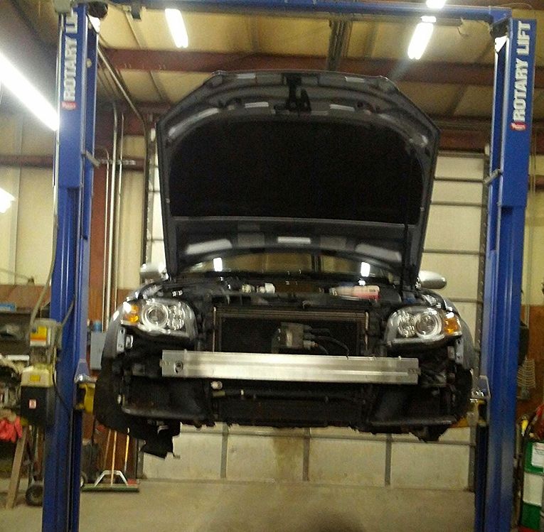

Where does it sit in regards to the bay?
In front of the radiator.
The water tank is in the stock battery location I believe, and air to water interchange sits in the up pipe section from the blower to the TB. There is a pic or two posted of it from their gtg last year, but they didn’t say “this is our stg 2 car”. Just open hood for people to see.
Edit:
You can see the IC and water tank in this picture. Pretty clean install overall.
http://img.tapatalk.com/d/14/01/26/3ysyha6a.jpg
Sorry for the misinfo, I was thinking about the heat exchanger, not the IC.

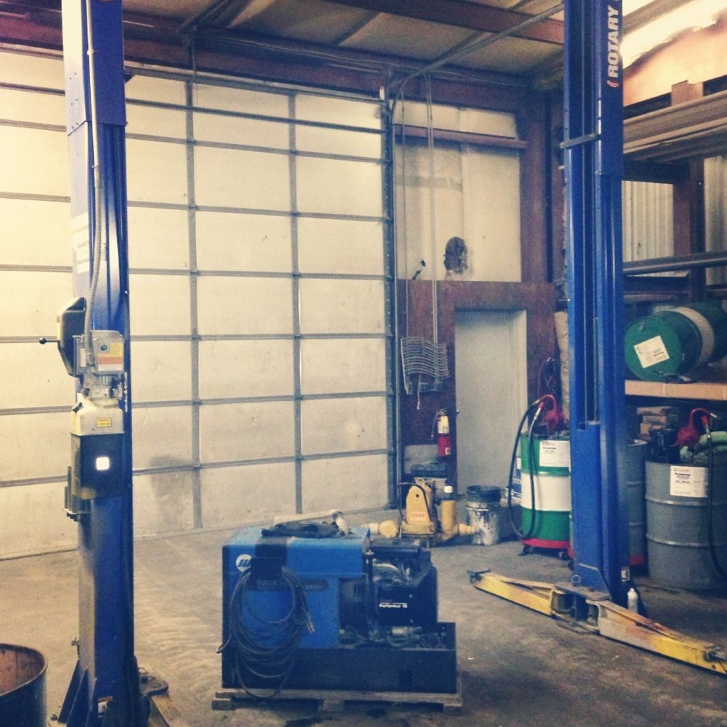

The fun starts tomorrow, but here are a few boring pictures until we dig into the good stuff.
Where it is all taking place, just need to move the welder…
http://i201.photobucket.com/albums/aa298/930chas/4CA43BFD-C7B5-4002-9EE4-3D736CA1C0F5-5932-00000249E5E1F25E_zps64941a90.jpg

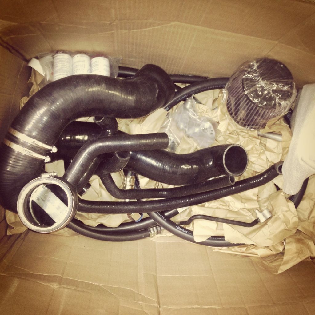

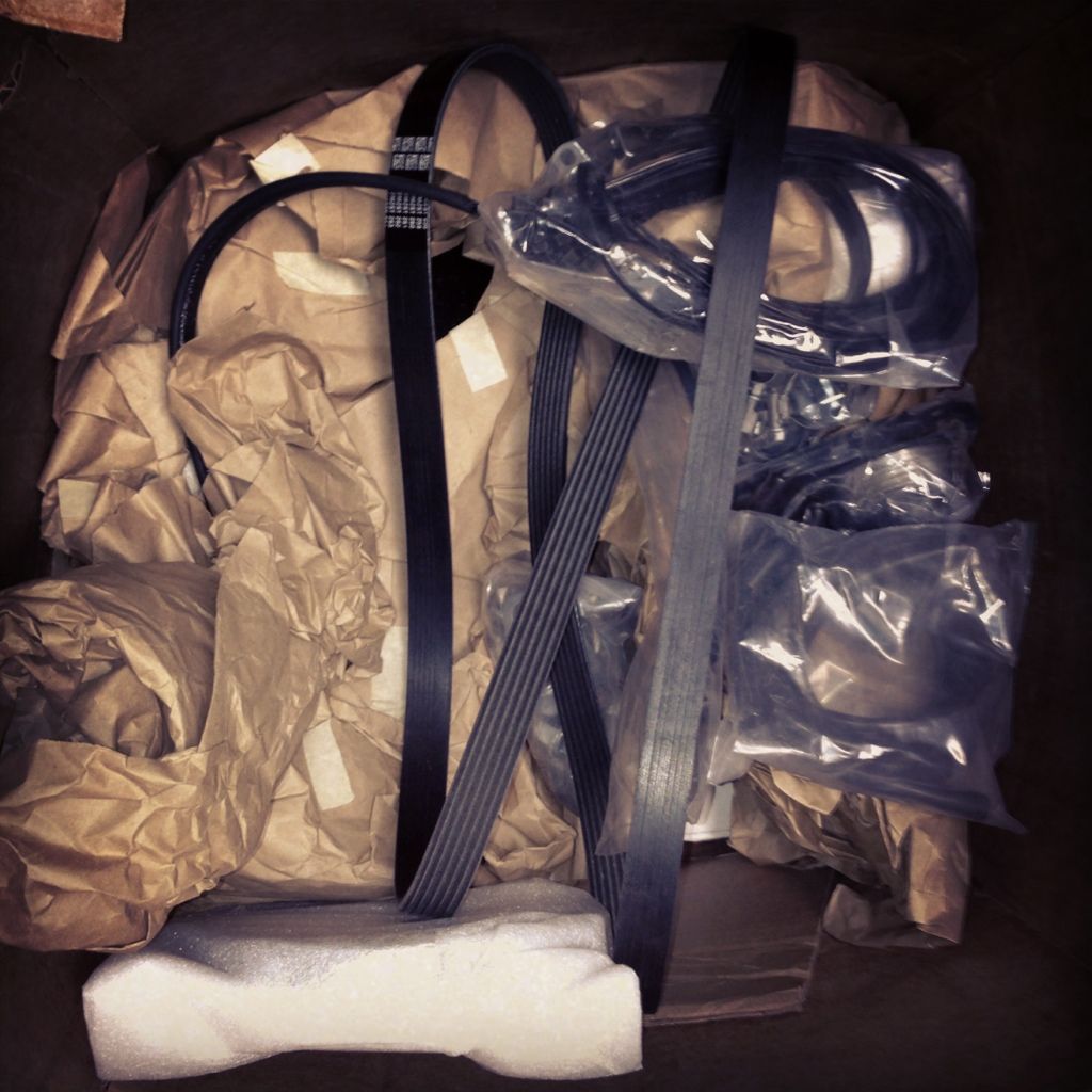

Boxes of goodies…
http://i201.photobucket.com/albums/aa298/930chas/4259BC26-A4C5-40BE-9F5F-798390C541A5-5932-0000024329F8E7D2_zpsbffc0270.jpg
http://i201.photobucket.com/albums/aa298/930chas/BB6BF35C-7860-4A99-A273-9D243F4C979E-5932-000002432F2DE184_zps1c290ac1.jpg
http://i201.photobucket.com/albums/aa298/930chas/4F33A73D-1D9F-4D6E-B636-BE79AC3384F7-5932-000002431DE3E22D_zpsadfcd7d7.jpg

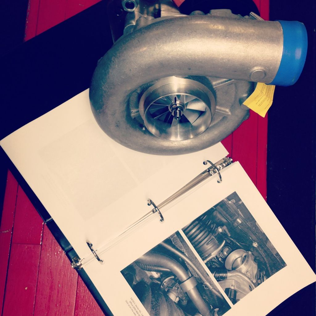

And of course, the heart of the kit with JHM’s excellent 87 page instruction manual.
http://i201.photobucket.com/albums/aa298/930chas/B7A22D06-422A-47BA-B6E0-8643339E6FF7-5932-00000240750BB00D_zps4de82883.jpg

Now that is an installation manual! So excited for you!

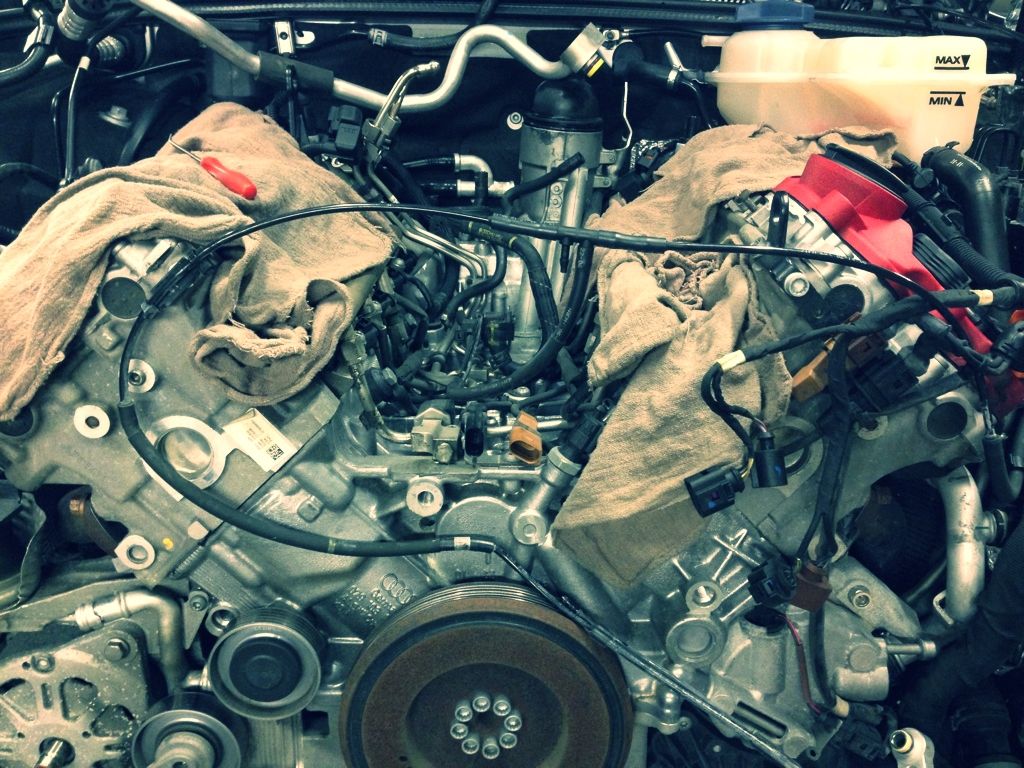

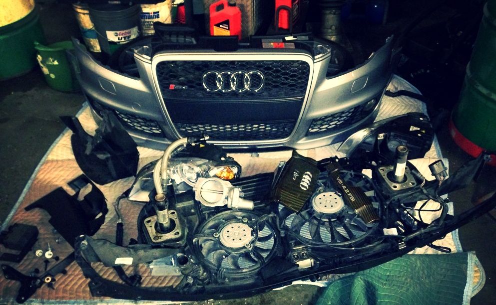

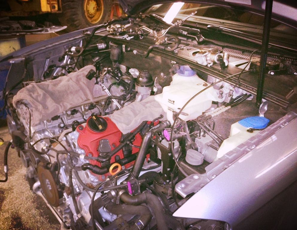

A few thoughts as we are almost halfway through the install. First, working on an Audi isn’t exactly a walk in the park as I am sure most of you are well aware. It has taken longer then expected as we plunder our way through it, but I am sure the time could be knocked down substantially if we were to do it again. The JHM instructions are great, very detailed and an excellent reference to have through the project. One issue we are dealing with is that nothing in the 2 boxes of parts is labeled and there is no identification chart in the instructions. When you have multiple hoses, clamps, etc this makes it a little tricky to determine what is what in the manual. Also, there is no way to go through and make sure that all the required parts are on location before beginning the install. Right now my fingers are crossed that nothing was accidentally not shipped out. I am almost certain this will be addressed in future kits, and is just a case of me having the first kit actually shipped out of house. Honestly not that big of a deal as the instructions so far have more then made up for that.
A few pictures of the basic disassembly.
http://i201.photobucket.com/albums/aa298/930chas/C8C1AF53-73D5-4315-8ACC-0AEF956CF50D-4304-0000019FA9DF25D1_zpsc137897e.jpg
http://i201.photobucket.com/albums/aa298/930chas/0AABEA2C-B128-4A4F-932A-08BD6AED2D50-4304-0000019FB34B239E_zpsc2f789e9.jpg
http://i201.photobucket.com/albums/aa298/930chas/382D6D5C-4E25-427F-9119-2FA98BB24B10-4304-0000019FA5AB238F_zpse459bf1a.jpg
http://i201.photobucket.com/albums/aa298/930chas/F2AD4C65-7CA7-4C59-8C3B-F2CAAE6F211F-4304-0000019FA0A4B7BE_zps6af05614.jpg
http://i201.photobucket.com/albums/aa298/930chas/57017408-3C0C-4775-A91B-D789A37D9231-4304-0000019F9371C8D7_zpsa363290a.jpg
