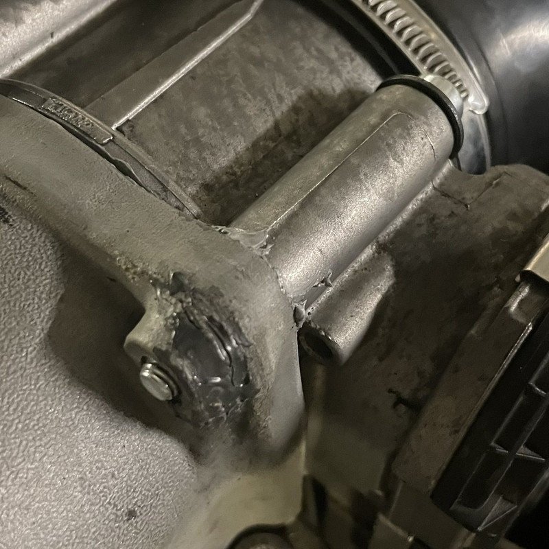

With that in mind, I checked all the electrical connections again. I cleaned the electrical connector to the Bank1 TB, and also checked ECU2 because I know it is bouncing around unsecured. I think a tab must have broken off somewhere.
QUESTION:
Can someone tell me what the ECU is sitting on? It feels like some kind of air box and I can tell that the back right corner of the “lid” is loose. It feels like a screw is missing back there and I’m wondering if that is contributing to the “engine too lean” fault.
Otherwise, I was able to shove a wine cork on the front left corner of ECU2 to keep the unit pinned under the remaining tabs. We’ll see how that holds up.
But those 2 changes seems to have fixed the TB/limp mode faults and the car seems fine on the first test drive. If anyone has any other ideas, please share. Until then, stay tuned…
